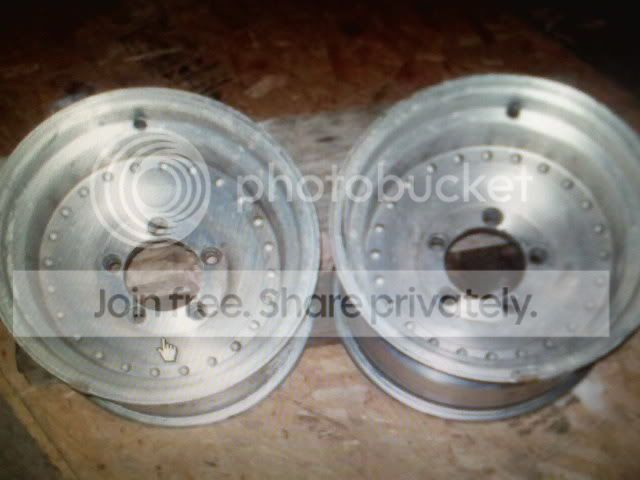

Sold my wheels, Here they are one they'r new home...

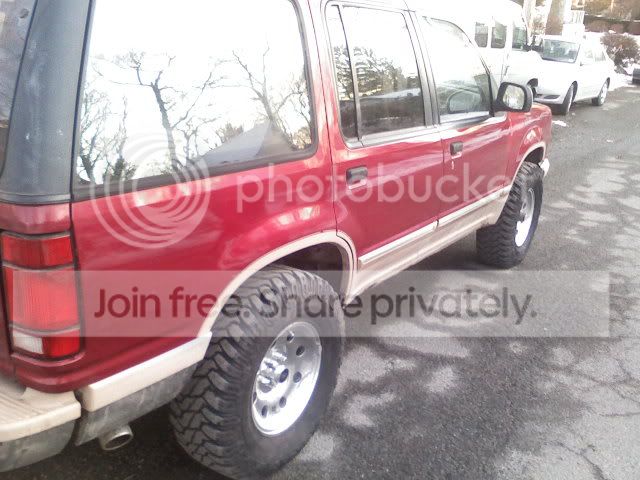

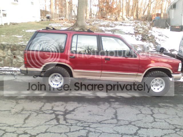

Here's the new wheels I picked up. Thanks to Tanbuddy.
Though not as sexy as the old Alcoas, they get it done till i get some steelies w/ beadlocks. They are 15x8.5.

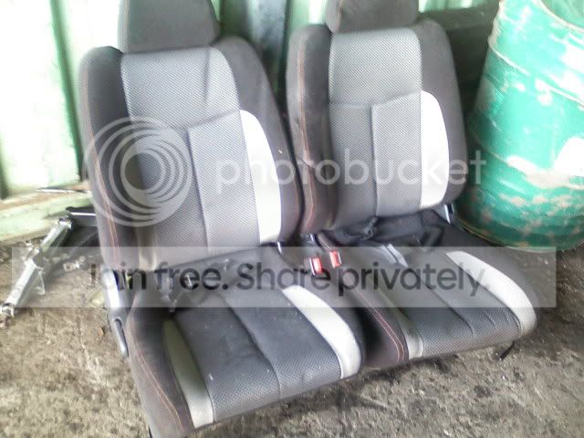

Warn Premium hubs, Disc outers, 5.13 9" gears, and finally got some bucket seats.
Bucket seats from a Mazda Mazdaspeed Protege. $50

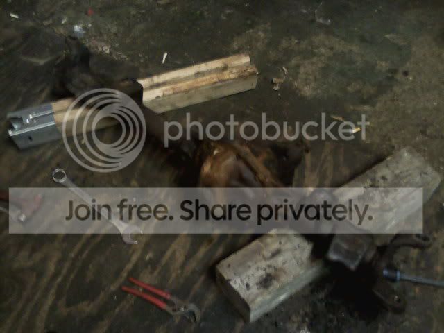

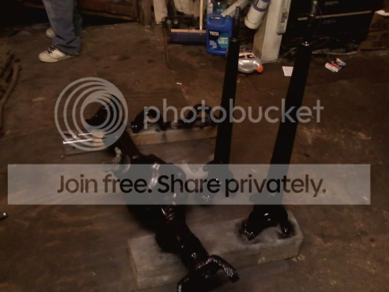

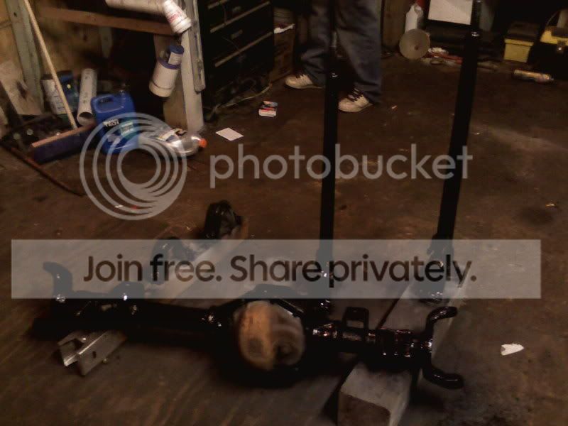

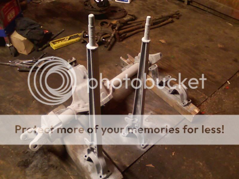

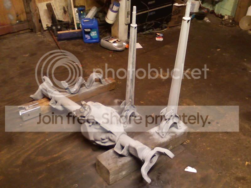

Got the front axle stripped down, primed and painted.
I used heavy-duty tractor restoration paint from TSC, with a zinc primer for rust protection.

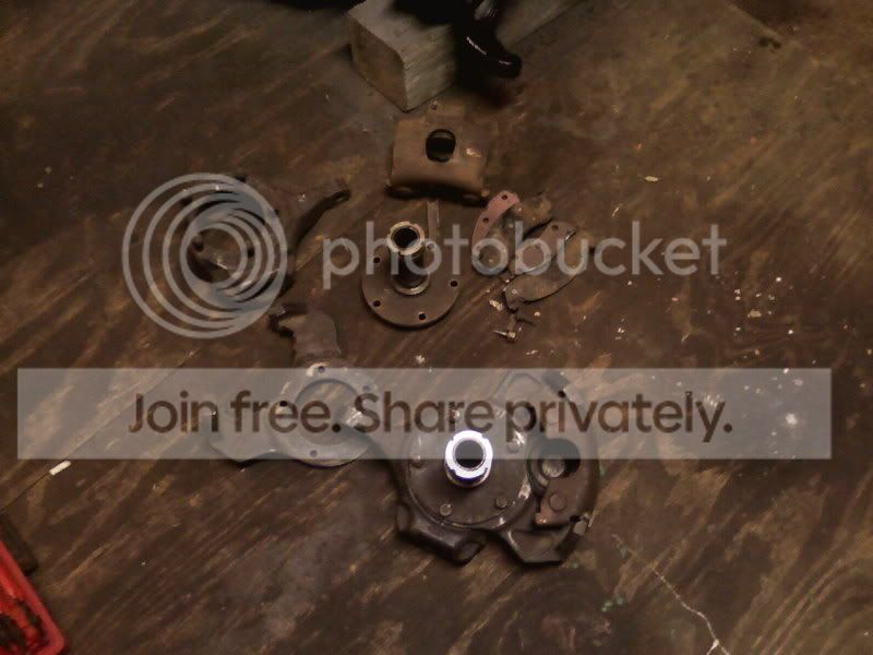

I also finally pulled the disc outters outta the box they were shipped in.
I'm ordering balljoints, hubs, bearings, and rotors tomarrow from rockauto.com, hopefully I can get the knuckles on soon.

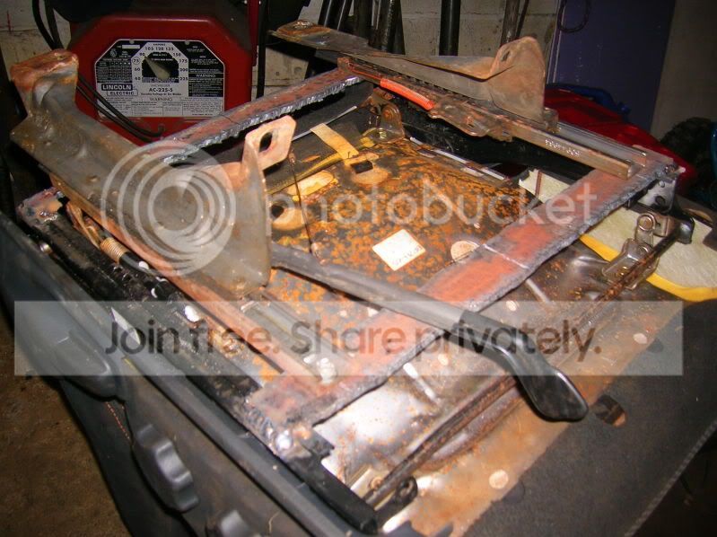

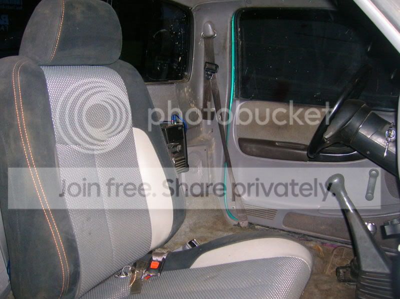

Seats are in, fabbed em up to fit the ranger brackets.

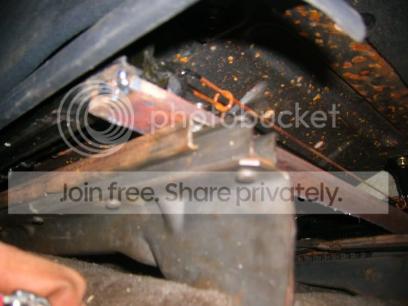

New trans crossmember is built and installed with the 78 Bronco radius arm mounts.
Front brake lines were rerouted to run down the frame rail then down the DS radius arm.

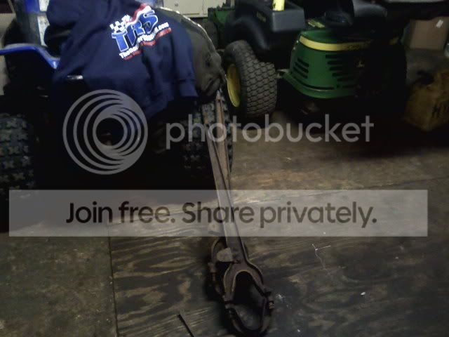

The axle is "under" the truck, but I lost the bolts for the radius arm caps... oops.

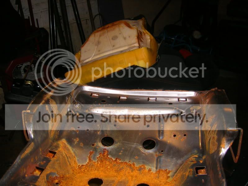

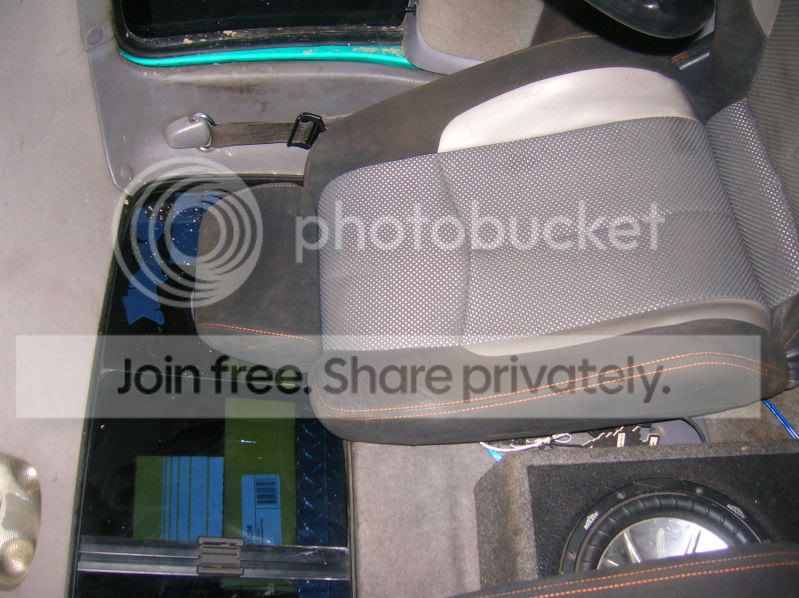

Passenger's seat, pics after install.

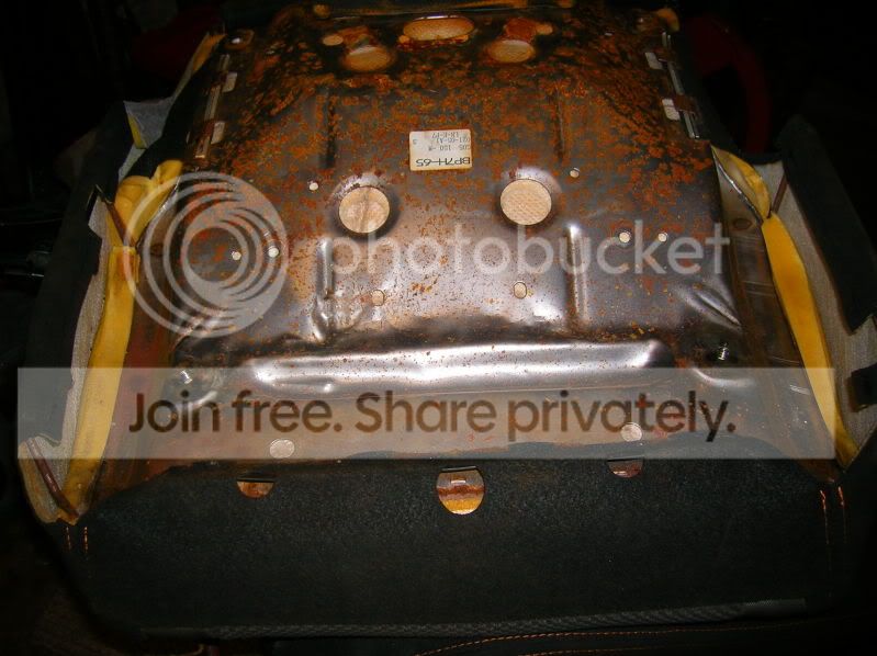

The driver's seat had a bent pan, the seats came from a rolled car. I took the lower cushion apart, bent it back, the put the seat back together. The brackets I made up were really simple, and are pretty strong.
The seats are in now. They are very comfy, and sit maybe an inch higher than my old seats.
