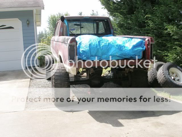

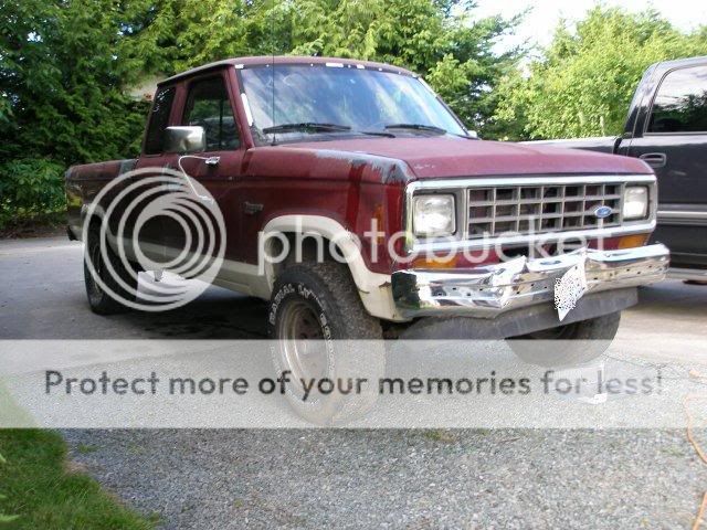

this is what i started with for those you never saw my last posts before the site went down

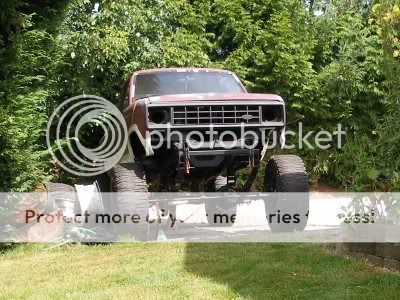

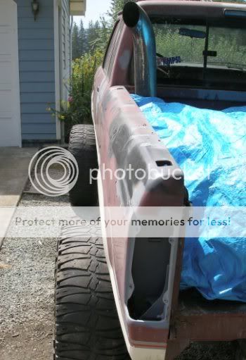

Update on truck:
spent 50 bucks on sand paper, primer, and flat black rattle cans to paint the ugly thing
cut the fenders
workin on the pass knuckle for highsteer
get rid of the stack and get new tires and you would be set.
...and those are roller tires, those trxus tires suck im thinkin of some boggers sence its goin for mostly mud, 39.5 or some 42s probibly, those are 36s
the stack isnt a good idea on any ranger motor.....
Actually, it makes a decent amount of sense from a "damage" and "water-crossing" standpoint. However, I agree, stacks have little business being on gasoline-powered rigs.
is the same thing as doing a 5" exhaust. I wheeled with a kid who had dual 3" stacks with flappers. needless to say he had to prop the flappers open because the engine had so little exhaust velocity it couldnt open them.
im only goin to use 2 1/2 exhaust for my 302 it would go up into the single stack if i even use it which i doubt cuz im going to put a fuel cell and battery back there, but it looks cool i think
