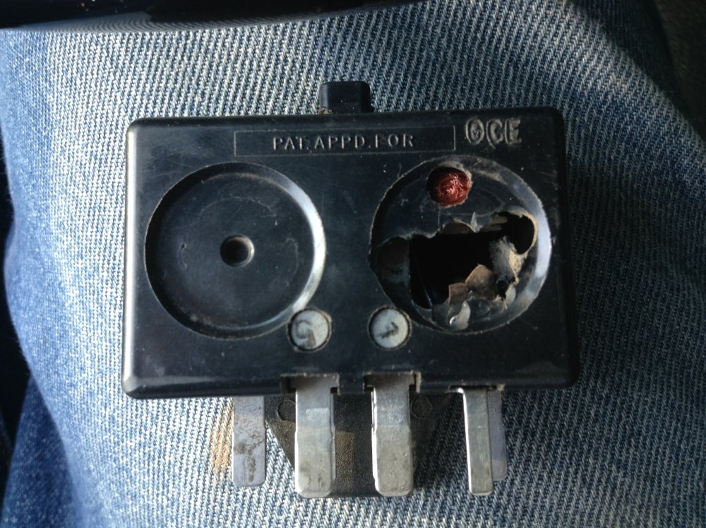

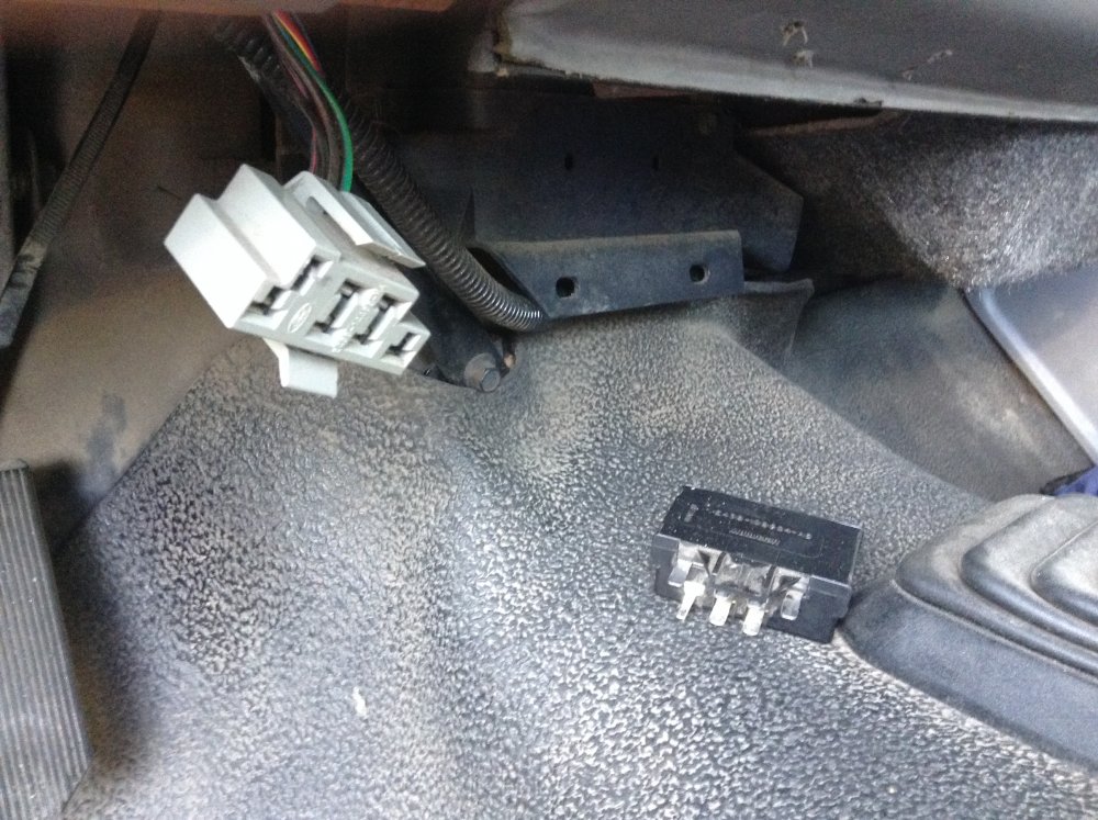

Hello,
This is my first post. Looking for help identifying a plug that was located in the wiring underneath my dash.
It is a Motorcraft part with number E43B-IOB924-AB stamped on it.

Truck is running great, and this thing remains unplugged, but I still don't know what it is.
At one point the mechanic said that he looked up the part number and said it had something to do with my airbags... but this truck doesn't have airbags.
If anyone here has any information about what this little unit might be, or what plug it was attached to there, I would really appreciate any thoughts and information on the matter.

Punch up the part # on google...it comes up as a seatbelt warning buzzer, nothing to do with airbags.

Thanks Grumpaw!
I did not find good results when I searched online before. I am now able to see some parts available on ebay, and that is definitely the one.
