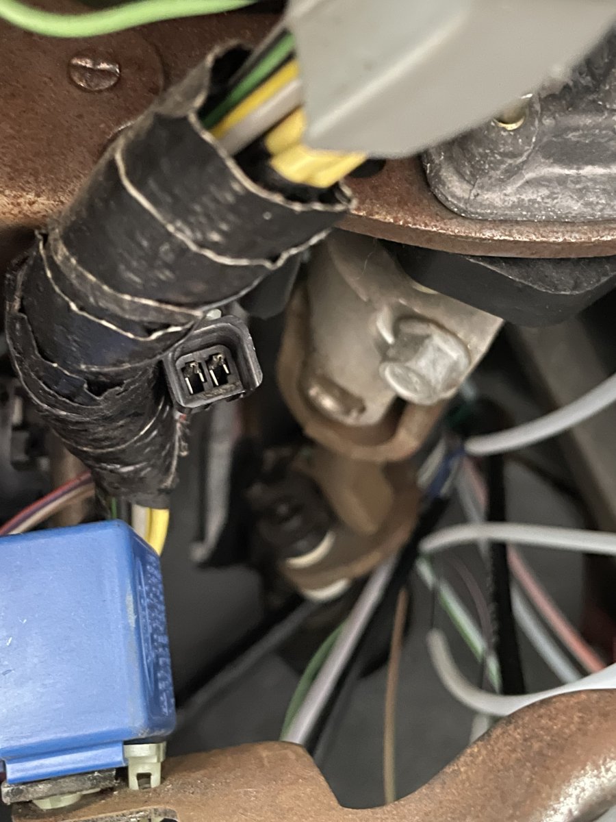

I have a 1996 Ranger. Anyone know what this connector is? It’s just to the left of the steering column near the flasher relay. One of the wires is tan/white.

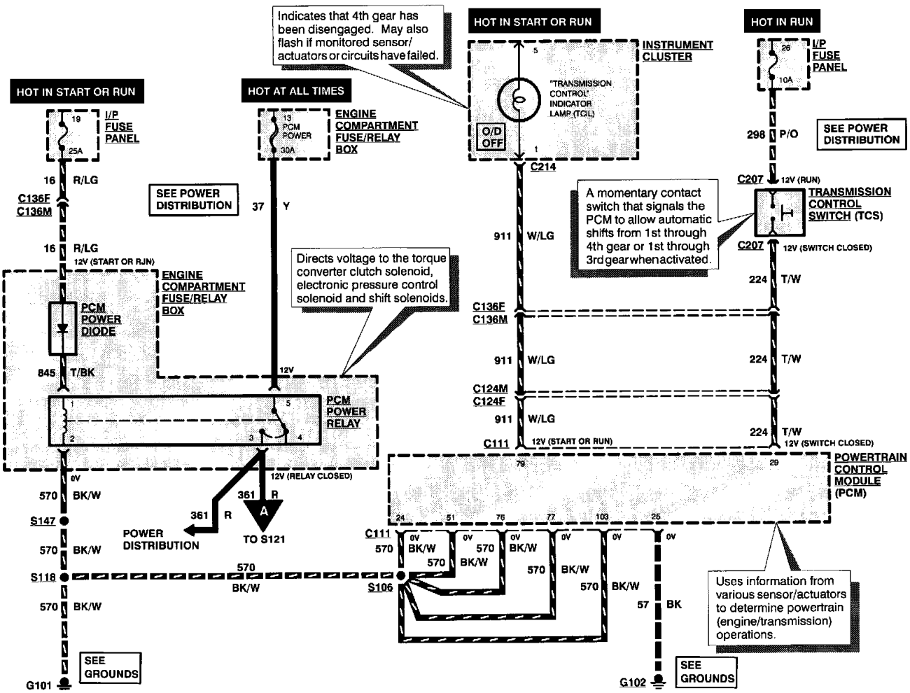

That looks a lot like the plug for the OD cancel switch on an automatic…
I don’t have a 3rd gen nor the electrical books for one so that’s about the best I got..
Thank you for replying. It got me looking in that direction. I think it is the transmission control switch. I have a manual so it would make sense that it is not connected. I was hoping it was a way to reprogram a RAP module but I don't know if 96 Rangers had that.
