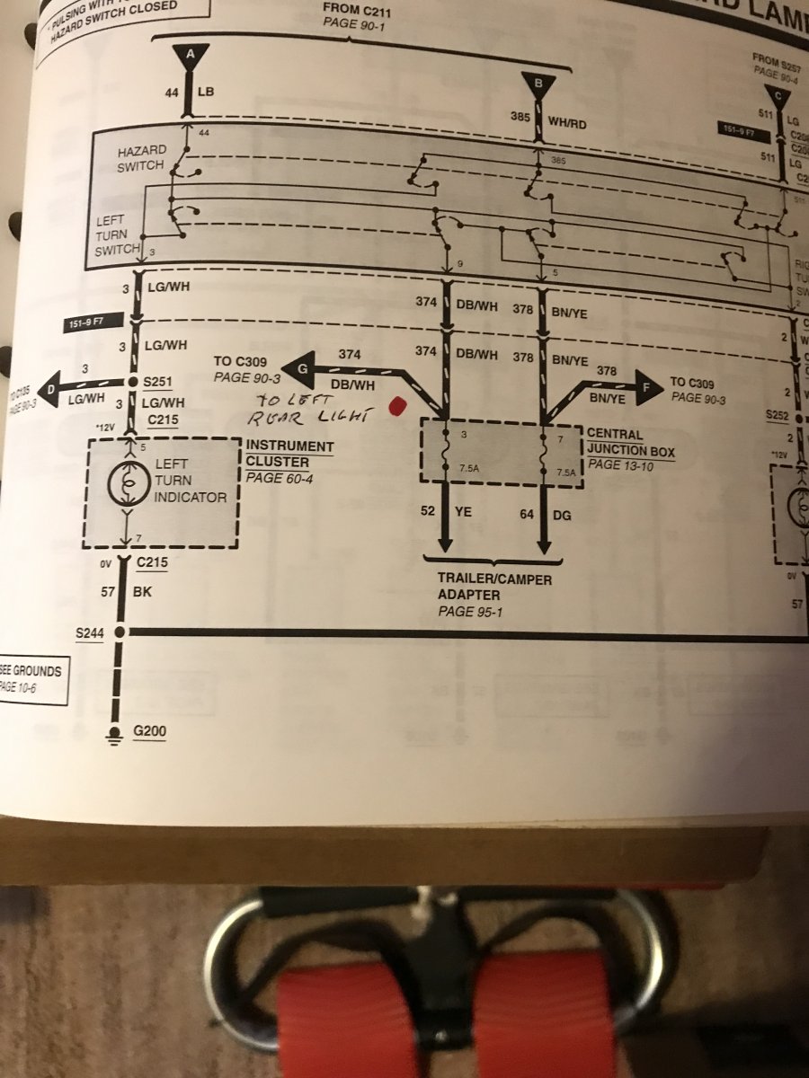

so...wait.
you continuity checked the wire i ass u me d before going through the trainwreck of pulling the column apart and the switch.
jumper the wire to the bulb
