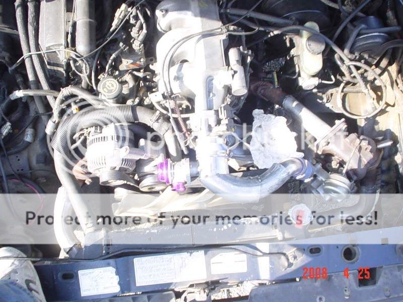

mine is up front however i have a little more simpler gen 1 than your later model. In any case it can be done and since you have odbII engine managment you will have a better fondation to hook some sct stuff up too
