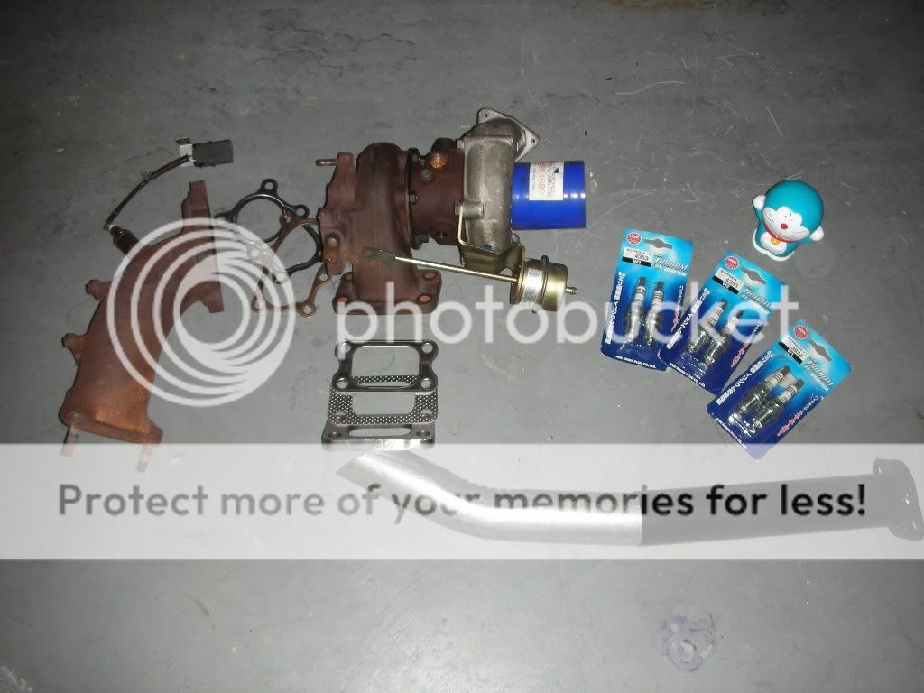

Hi, I have an STS turbo Charged 4.0 SOHC, and did the install myself.
6 PSI max is FALSE. I'm currently running 9 PSI and I know of a bunch that has run even more than this. On a stock block, TUNED CORRECTLY, you can see 10-12 PSI for short periods of time with no problems. 8 PSI for daily driving, and 6 PSI if you feel like going slow. The trick here is the tune. You must run the right air-to-fuel and timing so the engine won't detonate. The air to fuel ratio will depend on the weight of the vehicle, but an example is my truck. 3700 LBS and I'm running around 11:5 air fuel ratio at peak load and RPM's.
However, like anything, all bets are off if you dog your truck and don't take care of it.
I have the 5R55E tranny that everyone thinks will explode. It’s doing just fine with 9 LBS of boost but tranny tuning is helping it out.
