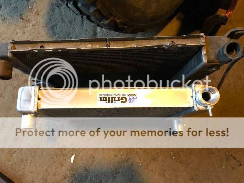

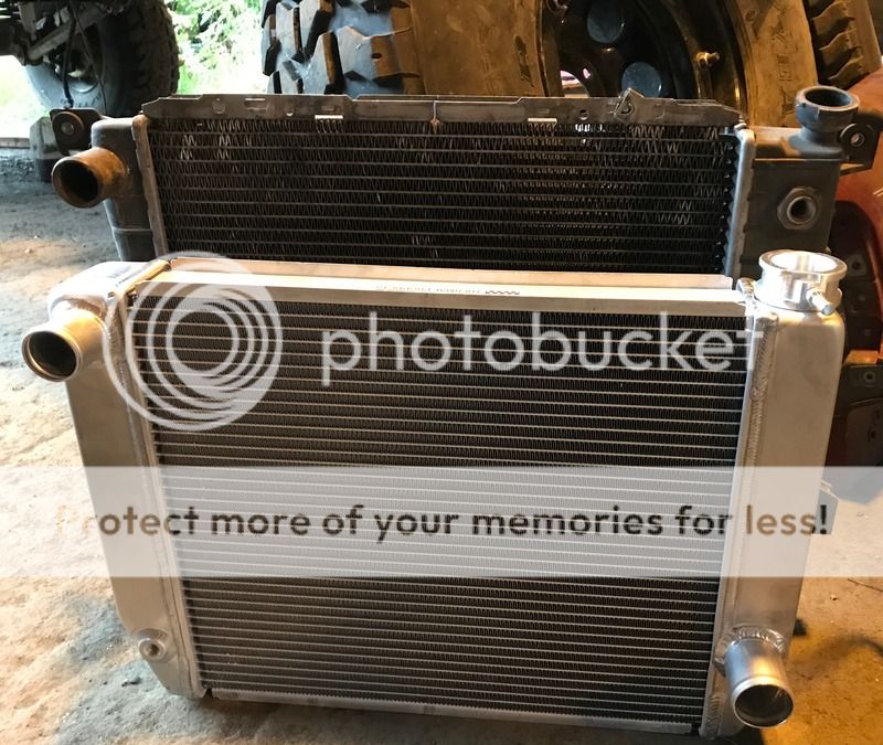

Here's a comparison between the factory radiator and the new one

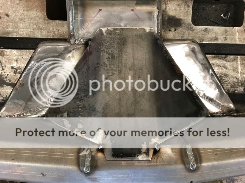

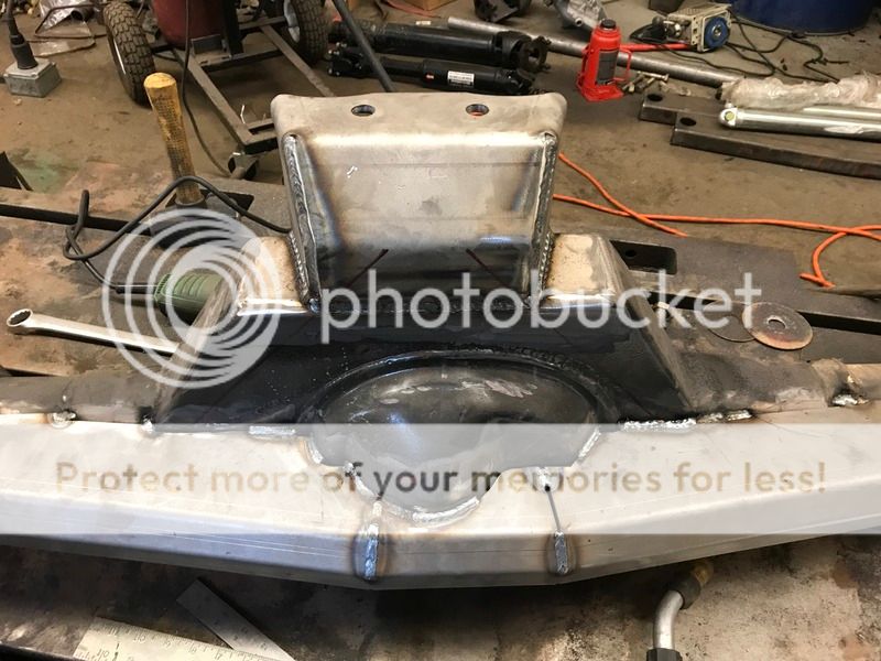

Got a little work done on the rear housing today. Lots more to do.

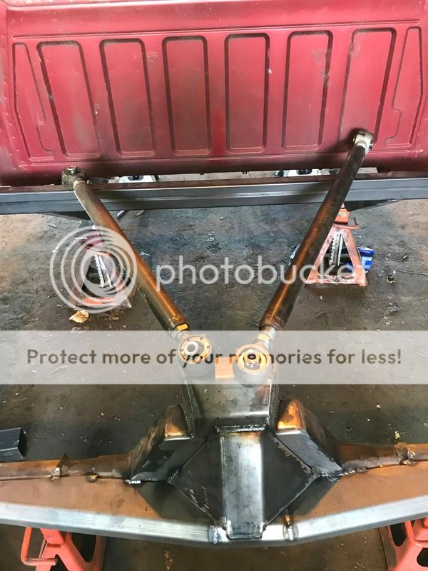

Built a brace to tie the upper link mount to the back brace. It's probably overkill.
Played around with some spare links I have in the shop. I think I'm going to run the wheelbase at 110"

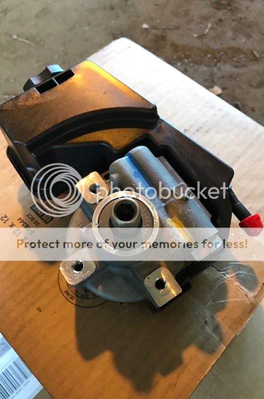

I'm going to modify the factory bracket to hold this CBR pump. PSC wants $400 for their CBR pump. I ordered this from rock for $120. It's for a 2011 camaro.

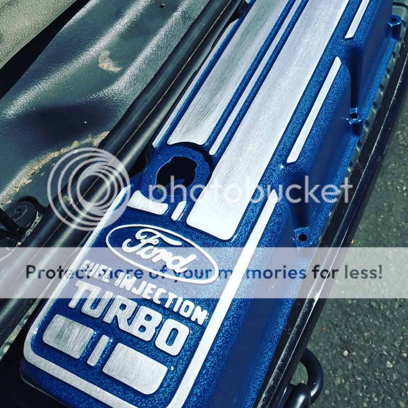

Had this valve cover powder coated. I'm happy with how it turned out.
That valve cover looks slick. Good choice on the color. :icon_thumby:
I just looked at the samples at the powder coated and picked it out. I can get the color code off the receipt if anyone wants it. It will eventually be on top of an aluminum head. For now it's going on an engine that's painted new Ford gray.
Dude that valve cover is sexy!!

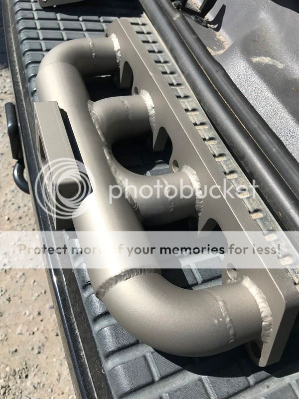

I now have a 4wd M5R1 with a 2.3 bellhousing. I mated it up to my 2.3 and started lining things up. I need the engine raised up quite a bit to keep the oil pan and transmission out of the rocks. I'm trying to keep this as low as possible. Lots of work to get this where I want it. The adapter on the back of the trans is from NWF. It converts the 5 bolt to the popular 6 bolt and uses a spud shaft to change it to 31 spline. The main downside is the added length.
