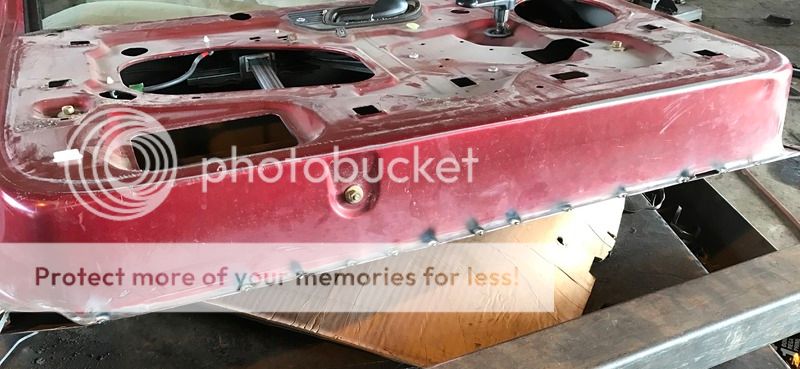

Started trimming the cab
Cut the pinch seam off the bottom of the door and tacked the two pieces together for more clearance

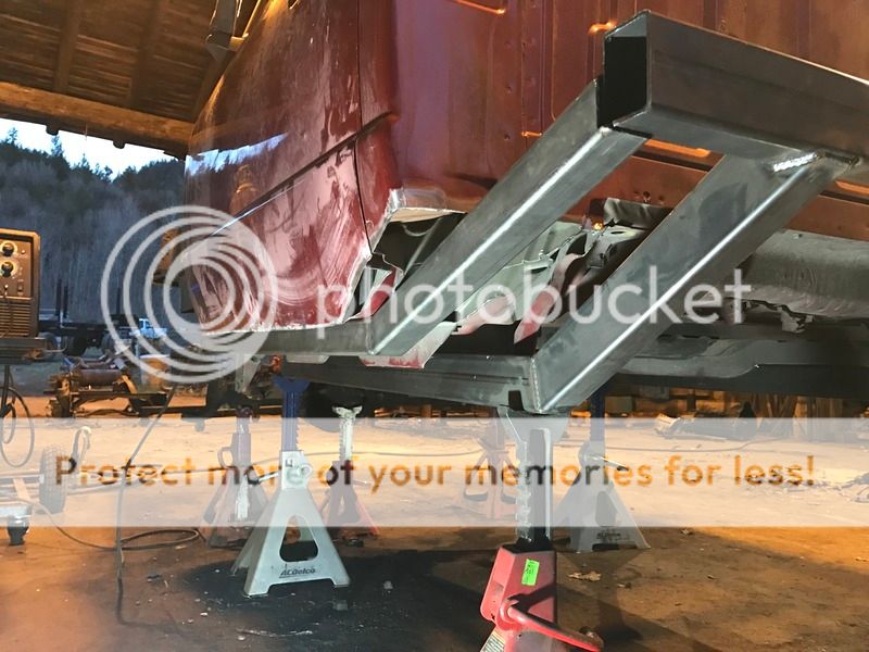

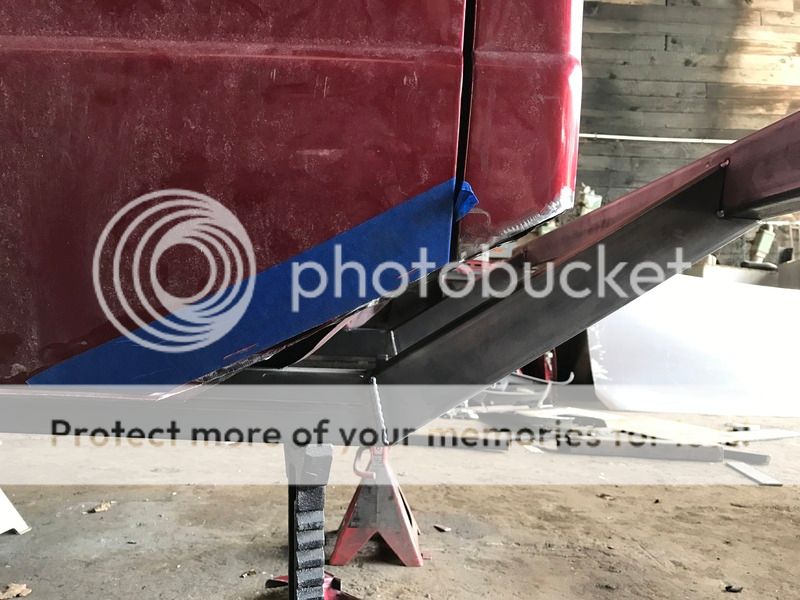

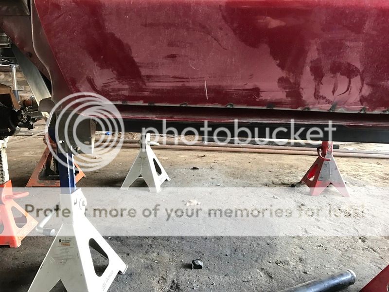

Got the slider tacked in place. I will tie this into the frame rail in multiple spots and build a tube bash guard. Then I'll replicate the other side.

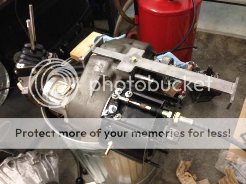

This is the Northwest Fab blackbox-i and Dana 20 with upgraded output shaft that I plan to use. I have quite a bit of money invested in this setup so I want to use it. Unfortunately, they don't make a 25 spline input for it and it's made for a six bolt adapter. This is why I'll probably it an M5R2 in.
Damn. If I had a setup that good looking it'd be mounted on the wall above the mantle. :icon_thumby:
I guess I could put some plexi-glass over the trans tunnel
