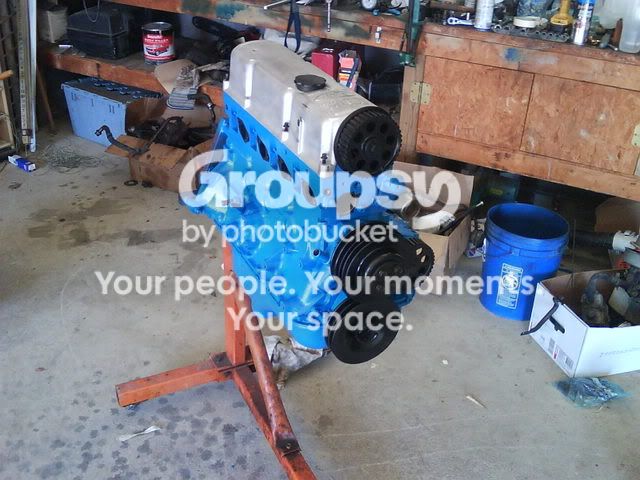

Here are a few pics of my turbo swap I'm doing in my 92 ranger. This is the donor car. It was a 86 turbo coupe with a junked title.
After the machine work was done and i got it put back together it was time for paint.
The valve cover was looking a little plain so i painted it black and the ford oval blue. Then sanded the top and cleared the whole thing.

Thanks I'll be sure to post some good pics once i get it good and cleaned up. The engine is bored 40 over. I went ahead and put a high duration motor sports roller cam in. I replaced the manifold with a E6 series...(a little more exhaust flow then the E3's). I want to turn the boost up to about 18 psi or so but i want a in dash boost control because i don't want to run that high of boost all the time. Today i bought a front mount intercooler out of a Volvo 740 turbo. That should be good for a few extra hp but I'm not sure if I'll have room to mount it.
