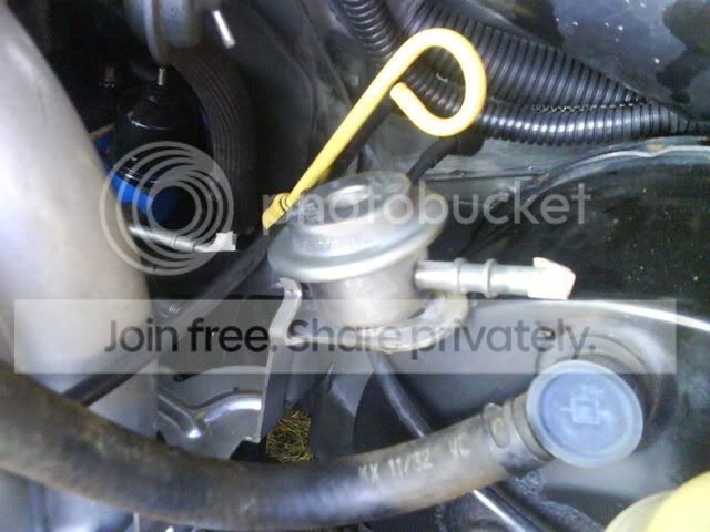

This is why i need a new fuel rail. The regulator hooks up in the back of the one out of the t-bird and it is hitting my brake booster. I'm going to the junk yard today to pull a rail and lines out of a 2.3 ranger.

Well i found a fuel rail that will work in my truck. I got very luck today. I was in the junk yard looking for one and i realized that a rail off of a 2.3 ranger did not have the extra regulator. I went ahead and pulled the lines that i needed and as i was walking out i ran into a 2.3 turbo motor that was just sitting in the yard. The fuel rail was perfect.
The one on the right is the new rail and the one on the left was the one that was rubbing my brake booster. The new rail also uses the spring type fuel lines just like the rangers. The old one did not. So with the 2.3 lines i bought today everything will plug right in.

As you can see no more rubbing.
