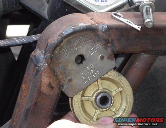

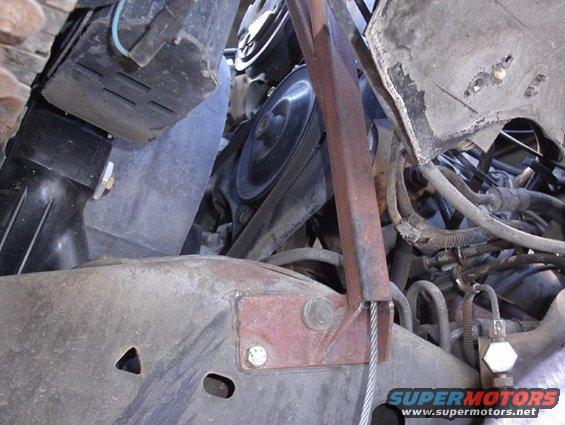

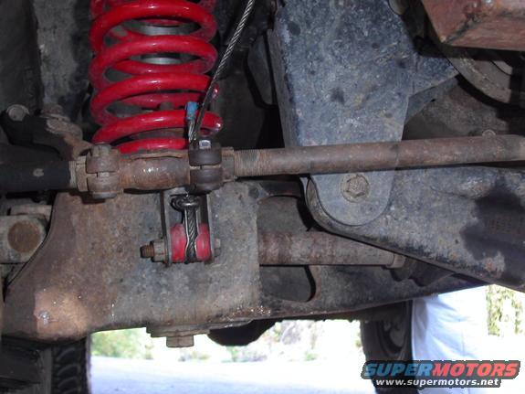

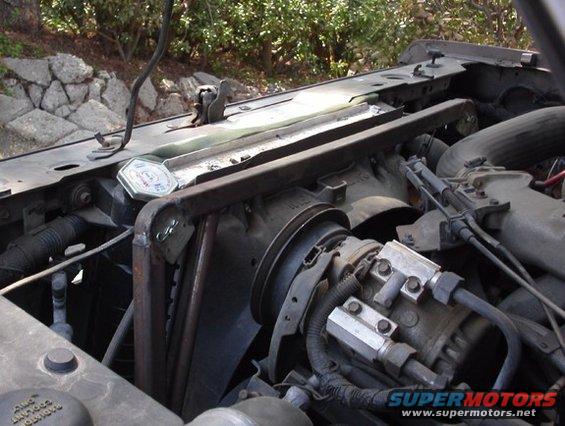

4x4Junkie I'm pretty sure installed a cable from side to side to act as a limiter, through a tube mainly to stop overextension while ascending steep hills, it moved side to side so there was still suspension travel but the total extension was limited... if memory serves he went from the sway bar mount points on the front of the axle.
That is it. I still run the cable, and recommend it highly if you are running flexible springs (Jeep XJ, JK, JL, or JT front springs or early Bronco front springs).4x4Junkie I'm pretty sure installed a cable from side to side to act as a limiter, through a tube mainly to stop overextension while ascending steep hills, it moved side to side so there was still suspension travel but the total extension was limited... if memory serves he went from the sway bar mount points on the front of the axle.
