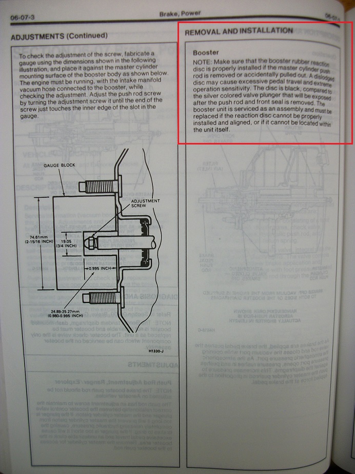

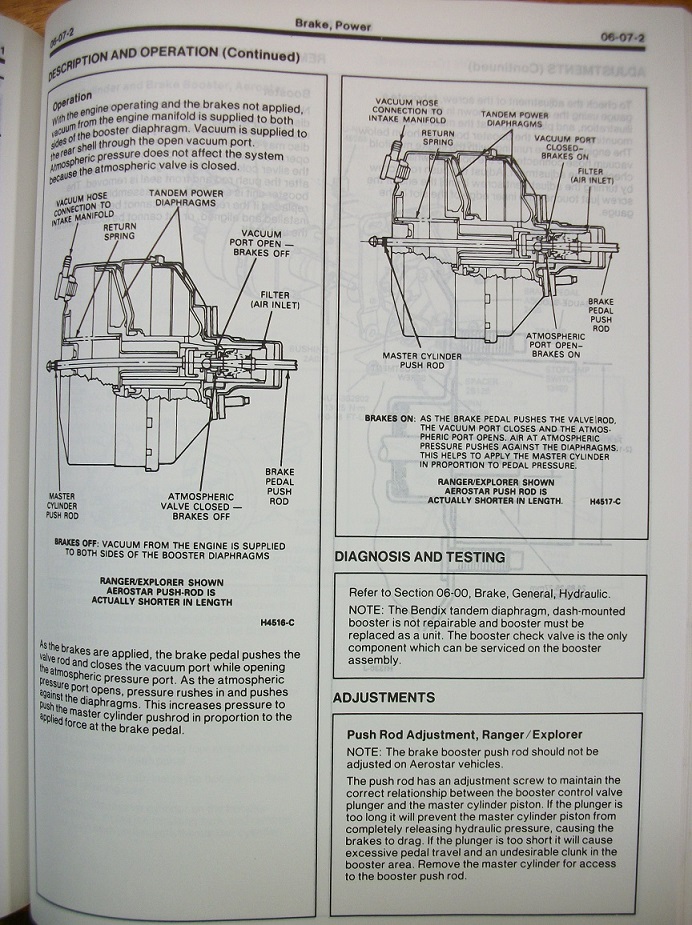

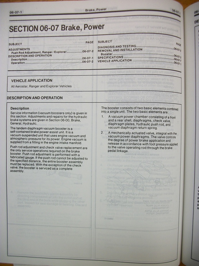

A couple of things stick out here. First, the factory says only two things on the booster can field-serviced- replacing the check valve and adjusting the push rod. Second, the manual talks about the "booster rubber reaction disc" like it's really important (I red-boxed that part). If the booster rod was pulled out in the past, or that reaction disc got screwed up, it sounds like the brake application pressure can also get screwed up.
Posted below are three pages from the 1992 manual, that describe how the booster works. I've done a lot of brakes over the years on these trucks, like the others posting here have, and I've never run into this problem. We can only go so far in troubleshooting over the internet. You have the truck in front of you, and know what's been done so far. You will figure it out, and you will get it working right.
And when you do, I'd love to know what it was.

I read all these pages you posted.

If you truly have the wrong length push rod. You would notice that with excessive free play at the top of the brake pedal whether the engine is running providing assist or sitting static without power assist. So I tend to think it's not your problem. Because you say the pedal feels good until you start the engine. Then you say the pedal goes to the floor which you stated... my power brakes aren't working. I say... it sounds like they're working. That's what power brakes do... they assist you in applying the brakes and you'll always see more pedal travel when the system is applying power assist. It's just how it works.

I read your entire response and it makes sense. Good information...as always going back several years. And that's a major point you just made about the booster push rod adjustment, which I did not know. I would not be surprised if this was just stubborn air in the system. I'm going to order a couple tools off Amazon. I suppose one of those tools would do an 'assisted' gravity bleed anyway. Should get it some time this week.
