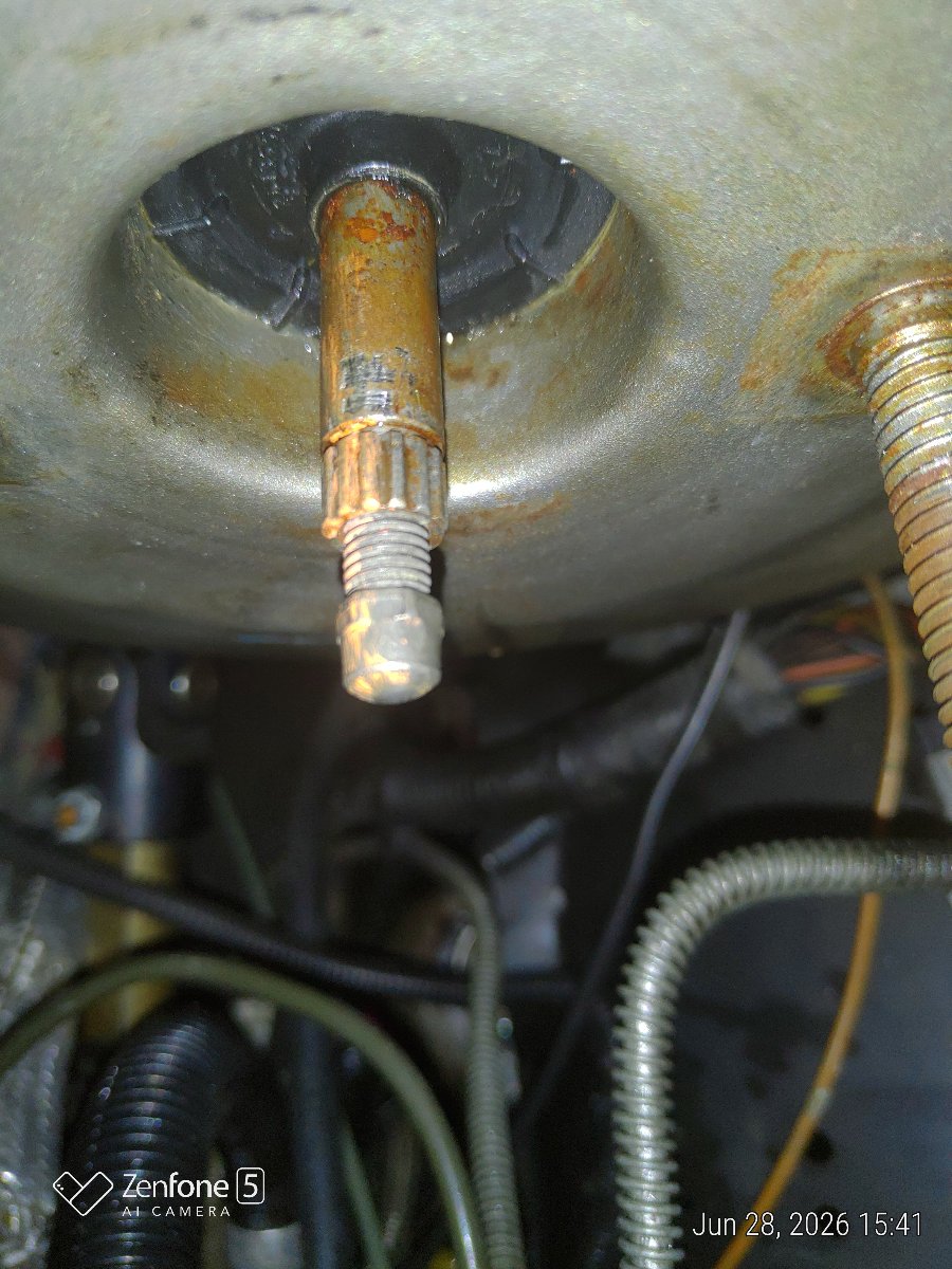

But I took off the master cylinder to check out the brake booster push rod with one of those 'H' adjusting tools.
The push rod is extended too far out, It was probably that way out of the box. I am not able to move that splined adjusting screw in the attached pic. It may not have anything to do with the current problem. But I should find out a way to adjust that push rod screw.

If I really have to adjust it, heat or acetone might loosen the screw.

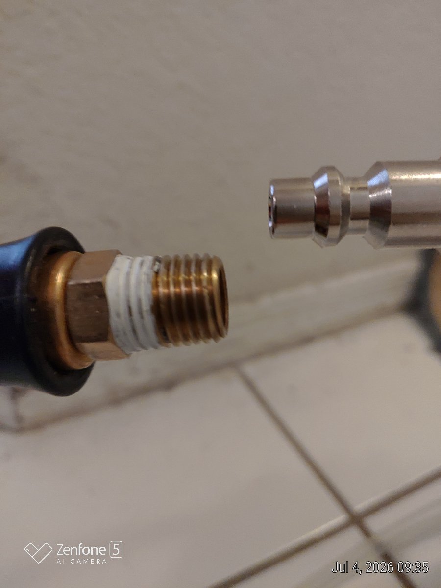

I was going to use new Mityvac kit this morning to bleed the system
But I am lacking the right size quick connect coupler for my air compressor.
Does the other end of this 1/4 inch coupler fit 3/8 inch thread compressor hose end?
The product description does not say
(I bought an accessory kit with my air compressor from HF... ..and it doesn't include this size fitting?
WTH ?)
Most likely has 1/4"NPT female threads. Whuch happens to be the most common size for home use air compressor hoses.
The coupling would fit between air hose end and Mityvac coupler
1/4 inch X 1/2 inch female thread (for air hose end)
