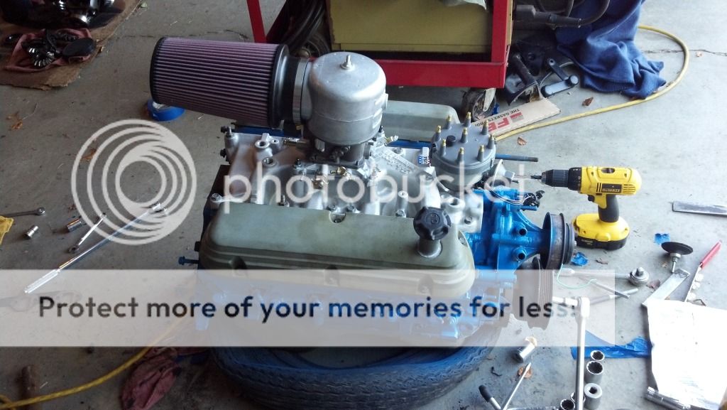

The bolts that hold the 425 mixer to the holley 650 throttle plate are 12-24, yeah nobody has those. Had to order some.

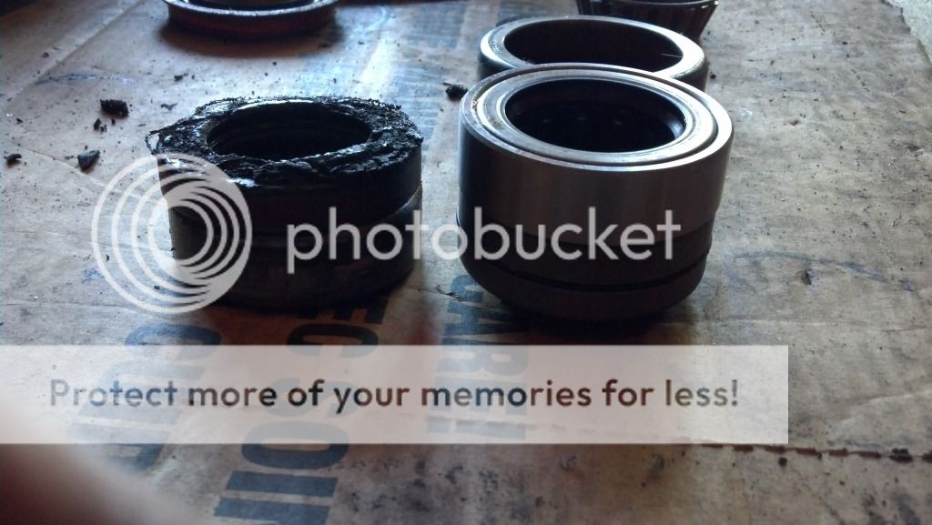

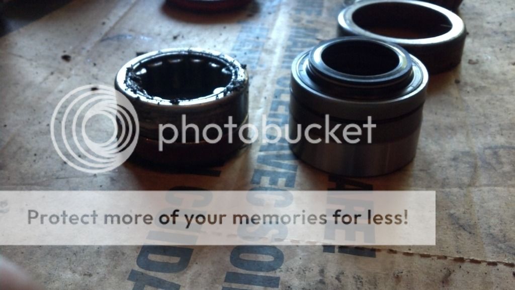

Few pics of the Timken repair bearings.

one thing though....i suggest a big block if your gonna run propane.
i think you will be happier with it.

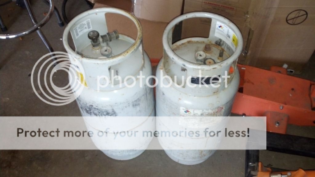

Got 2 tanks today and 1 more on the way. Filled and good for 5 years for $80 each + tax and environmental.
