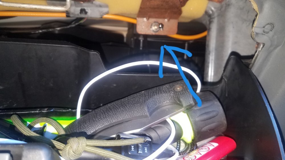

Btw there's a perfect pre-drilled hole behind the glovebox for a toggle switch... easy to reach from the drivers seat but impossible to see.
