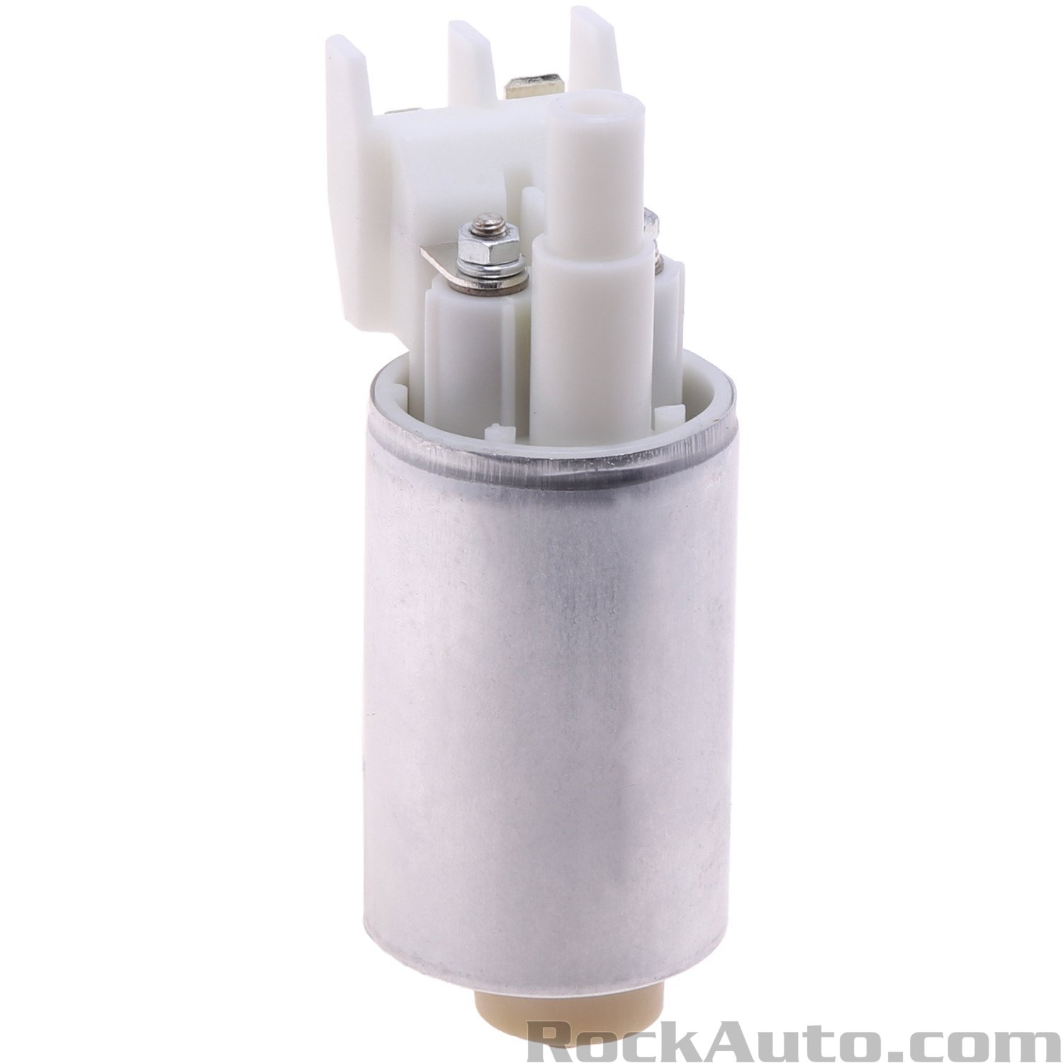

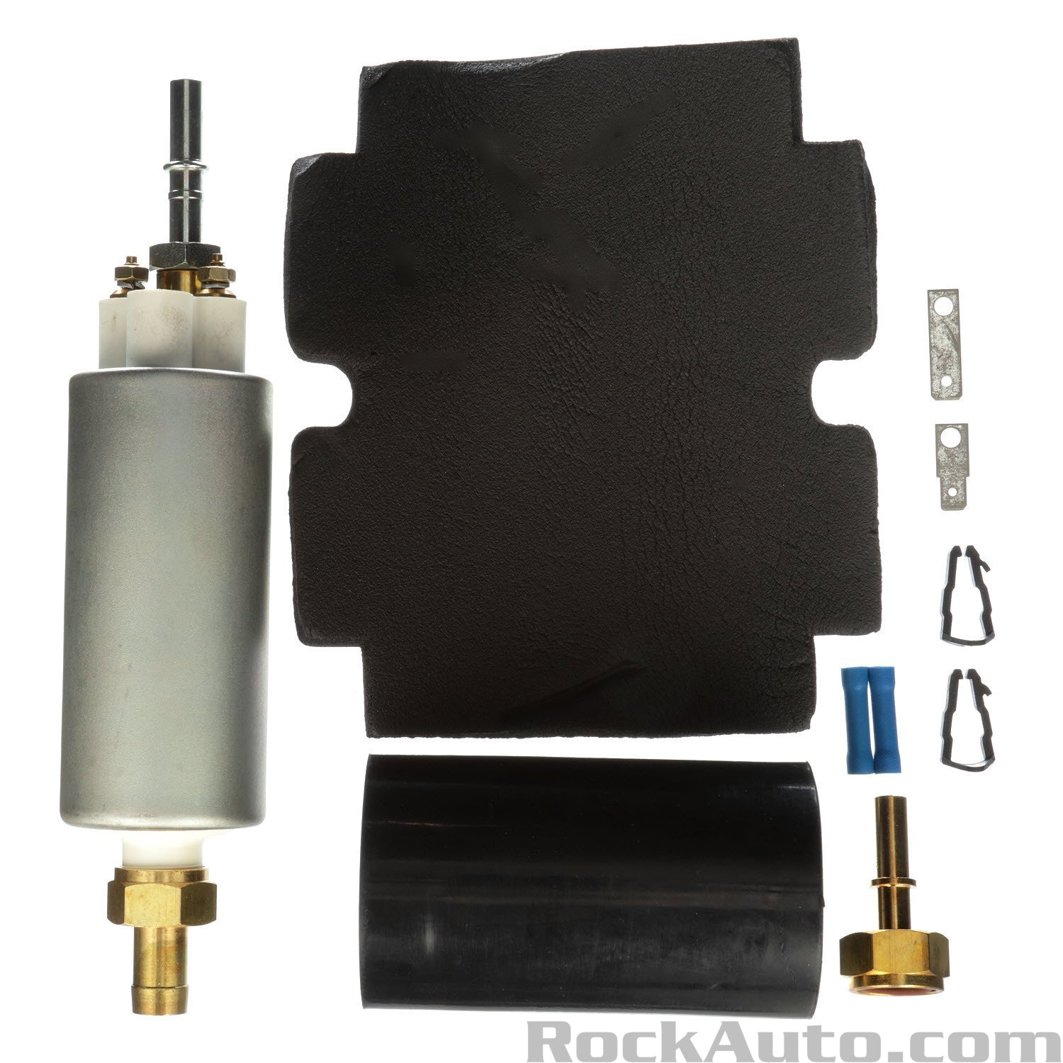

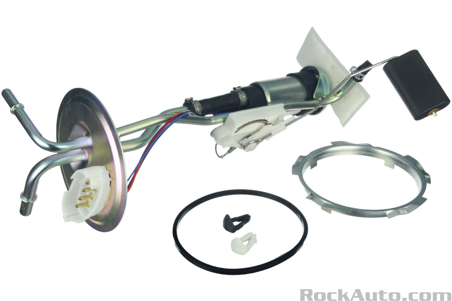

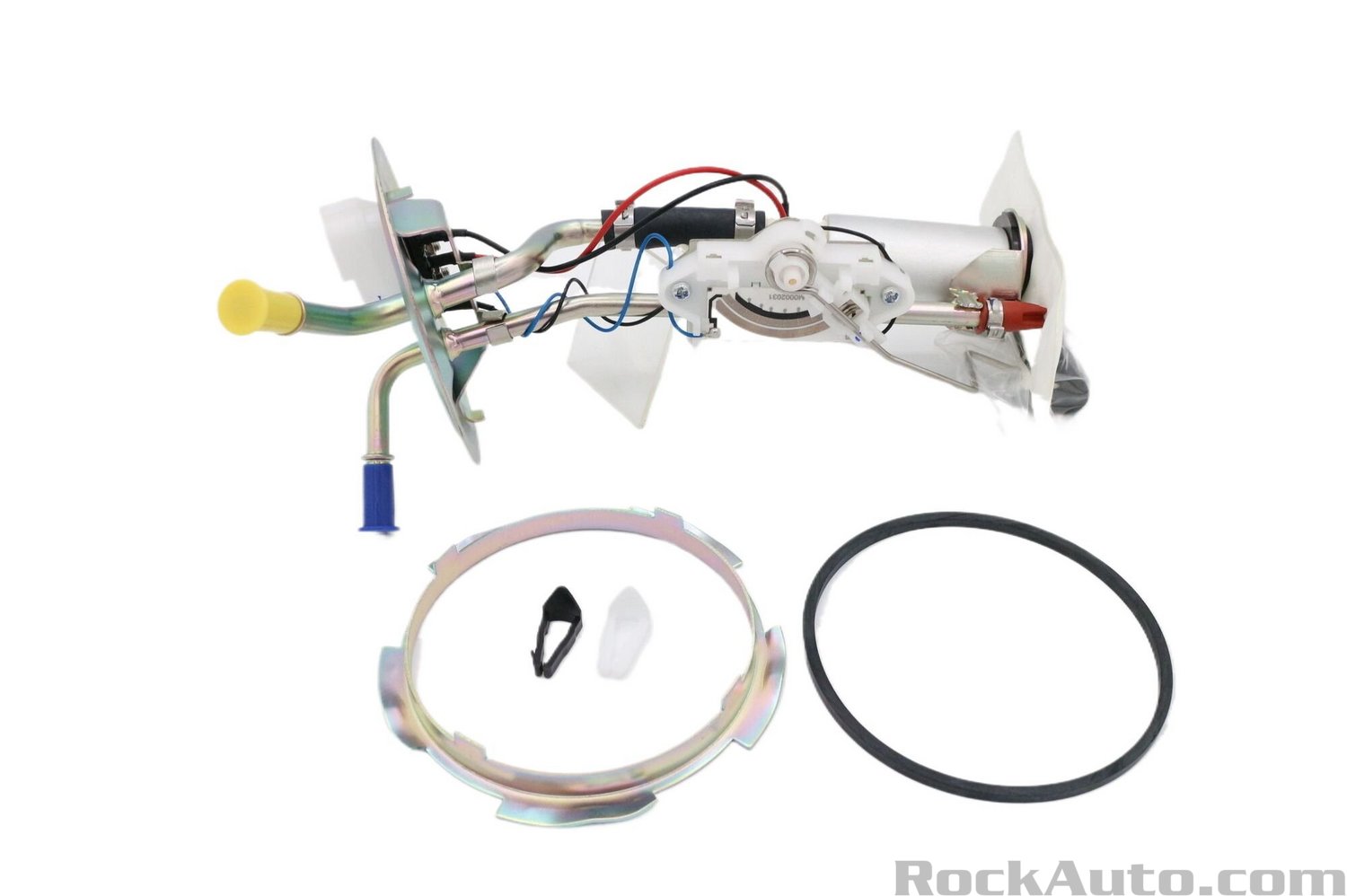

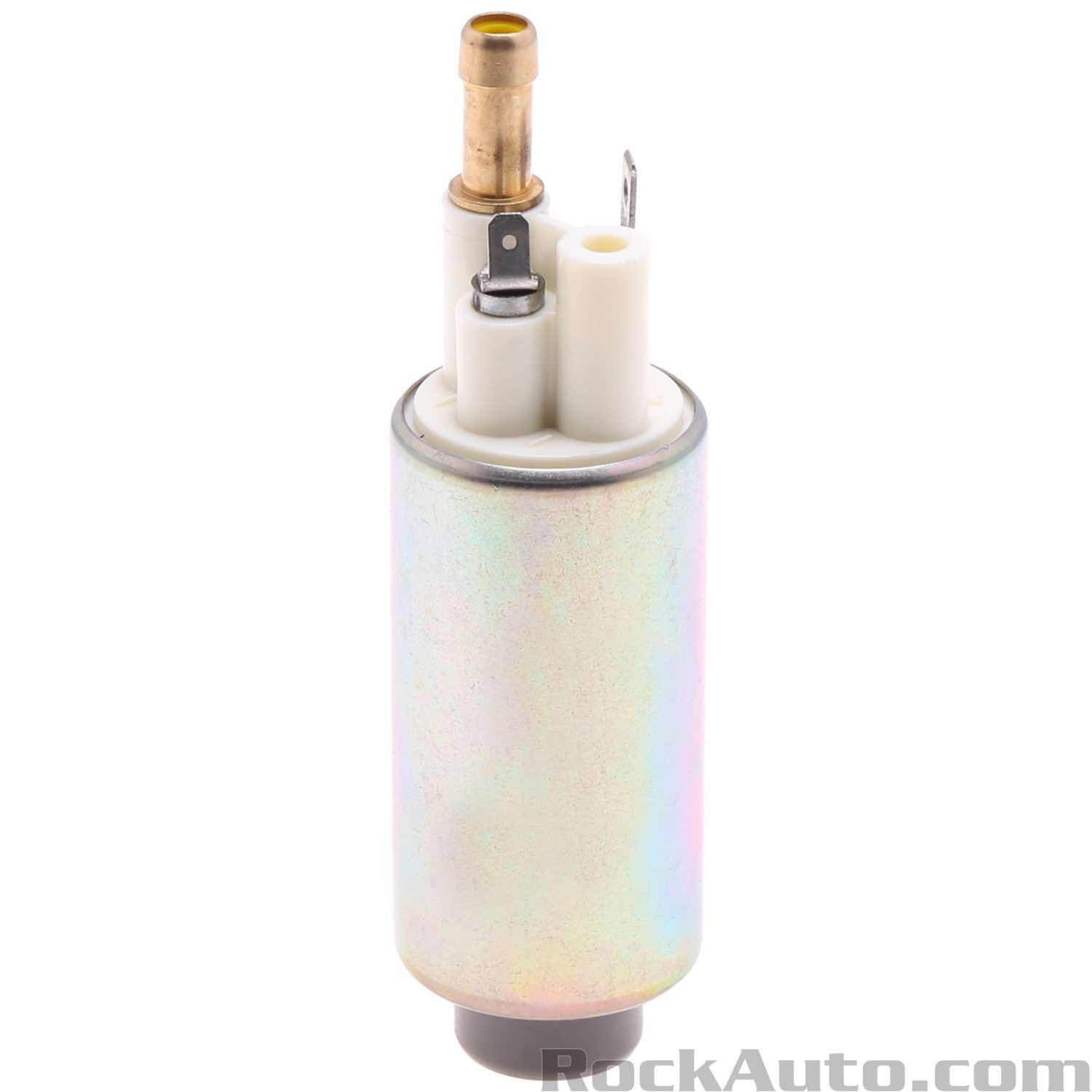

you know....with an 88.
this is highly unlikely, and you will see it easily on the truck tomorrow..
it is possible it only has one high psi in tank pump for the mexican market. and you put in the normal low psi pump. thing is the ranger in tanks high only pumps in the us market have a totally different sender...
the high pump is CARTER P90033
the low pump is CARTER P74069
the high psi frame pump CARTER P74028
hopefully the rock auto pics show up.
