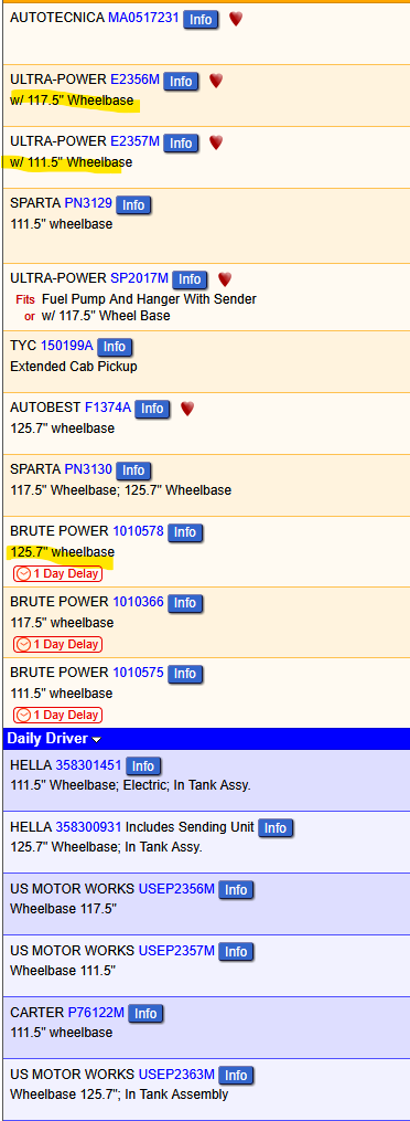

Just been perusing rockauto for what a replacement pump might be if needed. Is there any difference from the pumps for a 111.5"/117.5"/127.5" ?
Do they really have 3 diff pumps for a difference of 10" of length?
The price difference is ~2x from the cheapest 111.5" to 127.5" ($74 vs $135).

This is just a guess but maybe the connector length is difference for each wheel base?
As far as pumps go, it has been found that motorcraft pumps is the way to go for the best chance of long term reliability. The aftermarket brands tend to last a couple of years and die.

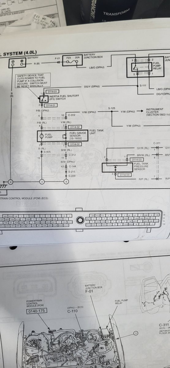

Thanks Doug. I am not sure what is going on. But when I tested for power at the pump plug with a test light, it did not light up. When I put the multimeter on it, it gave me around 10V. So?? I tested my test light and it works..
I will do some more testing. I have the 'wiring diagram' book. I'll see if the ohms info is in there.
@dashhho Are you sure you had your test light on a good ground spot?
If you have a EVTM for your truck the OHMs are in there.
If the fuel level is reading ok,I wouldn't worry about the sender. No reason to worry about it's resistance (ohms) if all we have is a pump problem.
Making sure you have a good ground connection, however, is critical to measuring voltage to the pump and for the pump to work properly.
So do I need the ohms when testing between yellow and B/W?
I have 10V at P/B
B and B/W seem to be grounded.

So I get 10V at Yellow. and around 6V at Pink.
Does the difference matter here?
