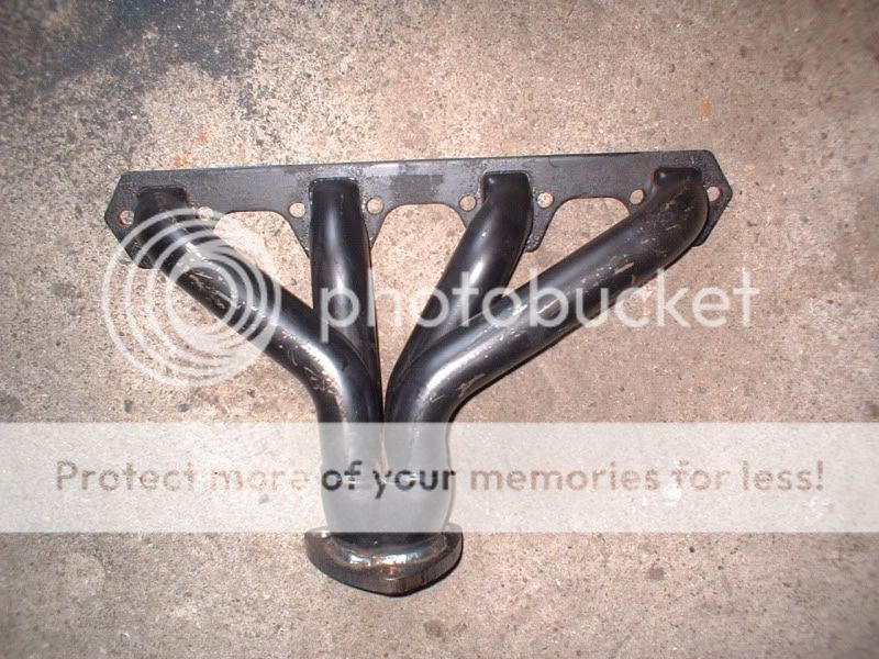

Has anybody used tri-y's on a 302 with an AOD?
Word on the street is that the tri-y's are too narrow and interfere with the bell housing. I'm wondering what needs done/modified to make them work?
I really don't want to use 89500's if I can get some tri-y's to work.
They interfere in the area where the starter is. I had a set, I didn't like how they fit around that that at all and they plain won't work on a 4x4 (non issue on your 2wd I know) so I sent them back. They were the Patriot ones from Summit, great looking header.

I have the Patriot tri-y's in my ranger with a 4R70W which is basicly the same trans as an AOD. I cut the collectors and straightend them out to fit and they work great now. It was a very easy thing to do. :icon_thumby:

I cut a pie slice out of the collector tube as close to the small tubes as possible, bent it and had it welded. cost $20 because I don't have a welder.

I put an AOD in a 65 Mustang with Tri-y's, had to heat and bend where the two down pies enter the collector pipe. Used a pipe inserted into the collector to bend the pipe out enough to clear the AOD. Had to do that to both headers. I was still very close at the starter, I had to cut down the stud on the starter where the battery cable connects to make it clear the header and not ground out.
