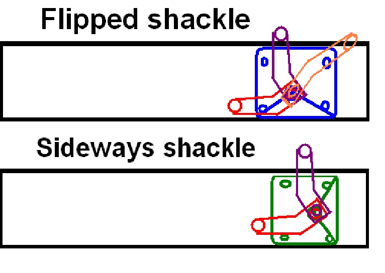

You could make a set of 'L' shaped shackles and get an extra few inches of travel. Imagine if the shackles on racerangers truck pointed down as well as out; an L shape.

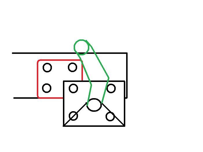

the deaver f31 and g50 are pretty much bolt on. with exceptions of flipping the rear hanger and shackle. im currently running the f31 pack with the the hangers flipped. but here pretty soon i will be moving the hanger back and down from the stock location and switching to a shackle that is 1.5 longer then stock. the red in the pic below is the stock location.
the instillation of the deavers over the chevy 64's is much easier plus you dont grind that many rivets.
sweet man thanks for the advice that idea looks cool to how do you plan on attaching the hanging section heres my idea with a 4-6in extended shackle angled slightly and sideways hanger sorry about the small image:)
