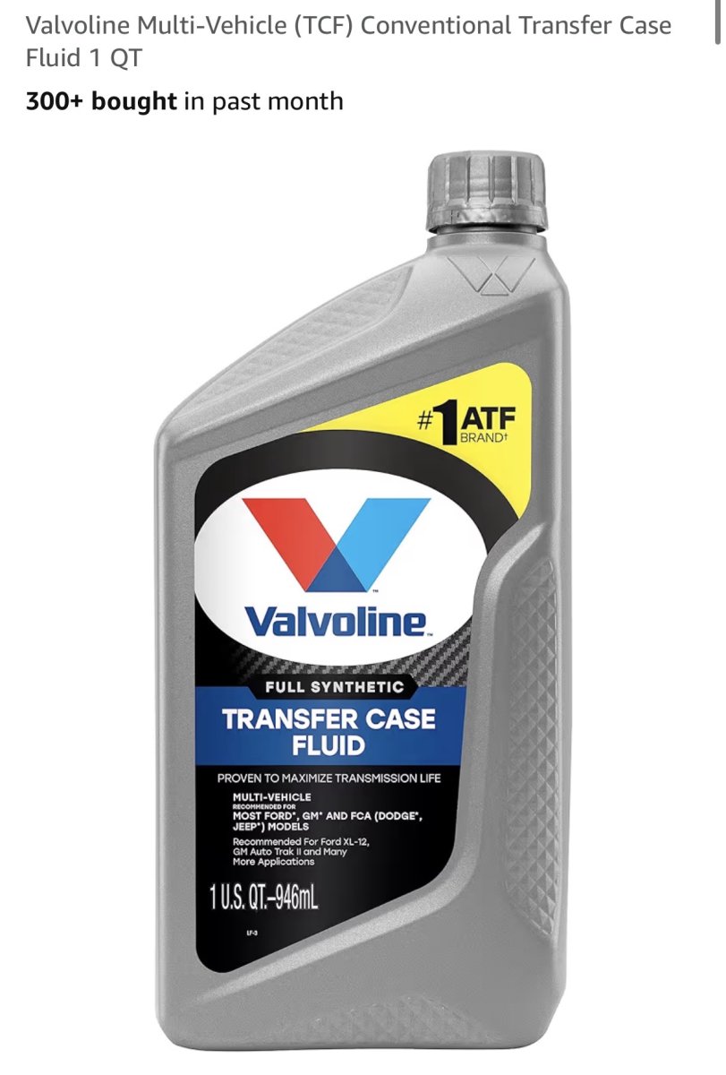

Hmmmm now I’m scared to use the Mercon V I just bought😭 I know not to put the V in your tcase but I would imagine it’s fine for the trans

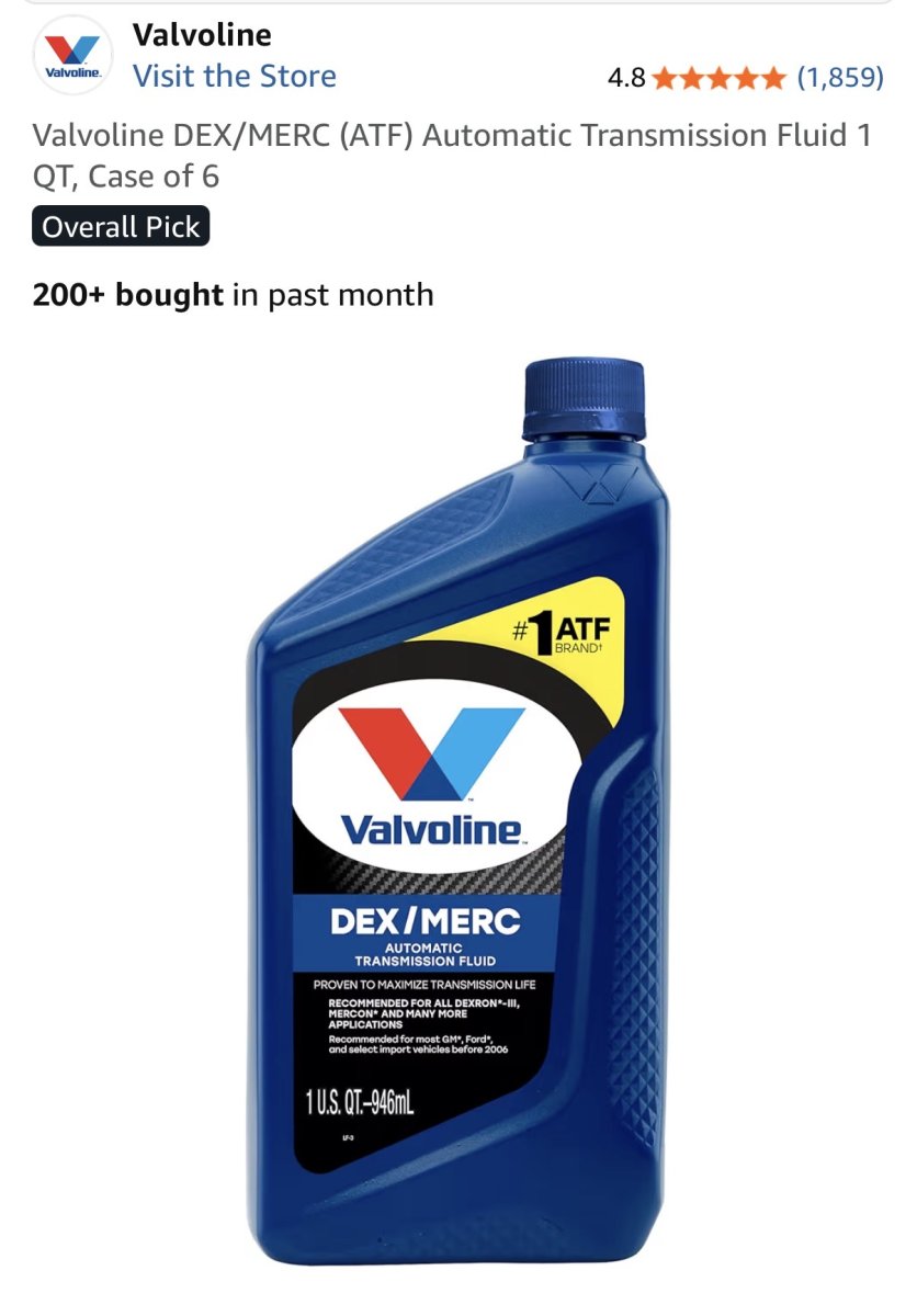

Is syncromesh different than Dex/Merc? And is Dex/Merc the same thing as fords motorcraft Mercon ATF?
so should I use Dex/Merc in everything then?

Or should I use Dex/Merc in my trans and power steering and then use this in my tcase?

I’d use Dex/Merc all around but I also buy it by the bucket. I haven’t found anyone that sells Mercon V in a bucket. Buckets are cheaper than quarts/gallons when you calculate out the per quart price. I use enough to justify buckets.
So Dex/Merc is the same thing as motorcrafts Mercon ATF, correct?
Yes. Dexron III and Mercon are the same thing essentially, so it’s now known as Dex/Merc
This is interesting, if I remember right I used the Valvoline multi vehicle for my '90 last time I rebuilt it and I know I used that on my '97 F350 when I put it back together since it calls for synthetic which the multi vehicle stuff fits... the '90 as always shifts great, ZF5 shifts fine too, I know 4x4 junkie tried merc V and didn't like it... I hadn't put much thought into it, I know I'm way overdue for changing the fluid in the '97 Ranger so might get/find in my stash some regular dex/merc, I imagine I have 3 quarts floating around...
So when you say Mercon, is that the same as Mercon ATF?
Alrighty, I’m gonna return my Mercon v and mercon lv and use the Valvolean Dex/Merc in my trans, tcase and power steering. Hopefully nothing deteriorates super fast, why does ford make it so confusing, like I wish I could trust that mercon v and lv would be fine but I’m just so skeptical about it
