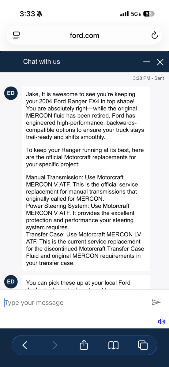

Got in touch with somebody from ford on fords website and this is what they told me to use, so now I get to use oem fluid and if it destroys anything of mine, I got screenshots😂
Your screenshots won't bother the little AI chatbot a bit.
