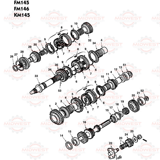

Yes I had found that bit, gonna order that part for sure, I was on the phone with Western today. I was hoping someone might have a shop manual to shar. People have mentioned having them in different threads but the threads are over a decade old now. Any help much appreciated
Got engine and tranny out. Transmission has no dead giveaway grenade evidence. Has some overheating marks where 5th gear bearing sleeve screws up and the magnet had some metal sludge but surprised there wasn't more. Have to dismantle completely to check bearings now. Suspecting 5th needle bearing to be shot. REALLY NEED SCHEMATIC!!! Not convinced it was put together properly so need good schematic to make sure we get it right.
Only one I have

5th was about to go from the looks of things in there. Parts on the way. Found great exploded view for fm145. It was not easy, long long and forgotten was she. Here's the link for anyone who might be interested.
EDIT: Thank you Paulos. The manual you provided me in my other thread is invaluable and very hard to find so to anyone looking to rebuild the fm145, here you go. Thank Paulos.
