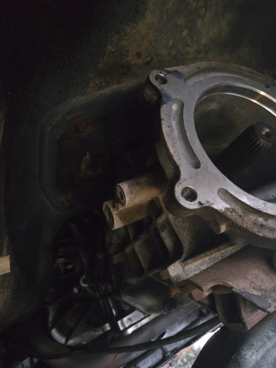

Are theses the 2 hole you mentioned on tailhousing. If they are yes both on donor and my truck are both threaded. Please confirm this is what we have been discussing. Thanks again. Just want to make sure things go in smoothly. Also having a heck of a time getting shift knows off. Really dont want to put vice grips to it?? Any suggestions there as well?

Yes. Those are the holes where the shifter will mount.
