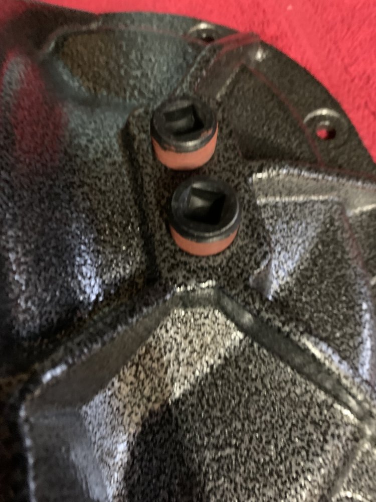

Oh one more question! What do you guys use to seal the drain and fill plugs with some sort of thread sealer or Teflon tape?
I use high temp RTV for engines. A little goes a long way. Just a dap on the threads will do the job.
There should be a thin soft aluminum sealing washer around each plug (engine might have a nylon washer, my 4.0L does). They shouldn't need anything else for them to seal as long as the surfaces are clean and smooth. If the washers are missing, then RTV can work in a pinch, but you should be able to find new washers at a parts store. Look where all the little red & white Dorman packages are (same area you'd find things like door striker bushings, window crank handles, etc.).
On these type of plugs? I thought that the diffs and transfer case all have the kind of plugs but I read that they are tapered threads so just snug them up good and they wont leak?
Tapered "plumbing" threads, do work well with sealants & are recommended. Me personally, I don't want any non dissolvable compounds (solids), so I would recommend use teflon thread crayon, and not tape and the ATF Merc V, what I've been using in my 2007 now for 3 years & 25kmi. I like the idea of a thicker ATF and not thinner. Bearings don't like cured silicone or solid teflon.
Ok thanks Doug! I have to run to the parts store in the morning for some 80/90 for the diffs so I will see if they have the teflon crayon.
I have never put anything on a transfer case or differential plug. Never had a problem.
