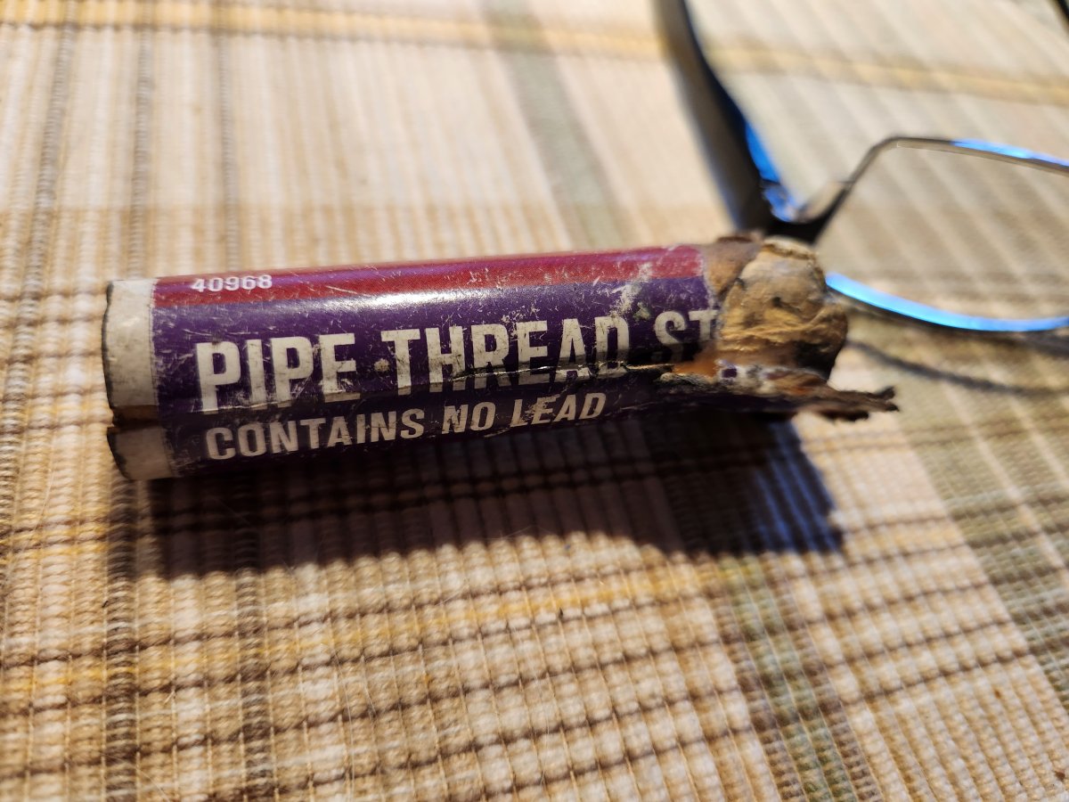

Home depot carries the teflon crayon in the plumbing section. 75-140w is the newest service bulletin from ford regarding the LSD fluid recommendation. There are some Ford service specialists that may have the actual bulletin number that may chime in.

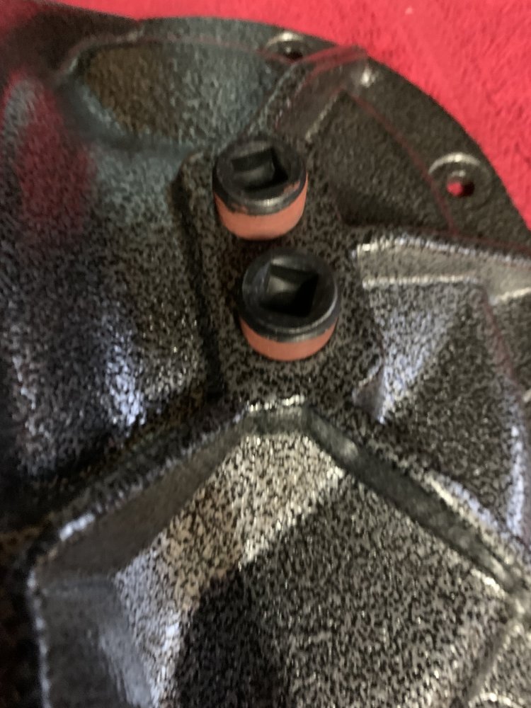

On these type of plugs? I thought that the diffs and transfer case all have the kind of plugs but I read that they are tapered threads so just snug them up good and they wont leak?View attachment 116027
Whoops, my mistake... Yes, teflon tape or paste is fine on those (sorry, got your thread confused with a different thread here, was thinking the M5OD & engine).

4x4, I ended up not using anything and snugged them down good on my diffs. If they leak I can always add some Teflon later. Haven't gotten to the transfer case oil but that's hopefully the last job I need to do under the truck so I can spray it with fluid film (or something else) before winter.
