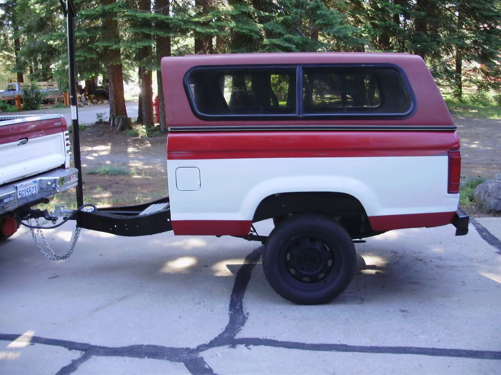

just for reference here's my setup i pull..
