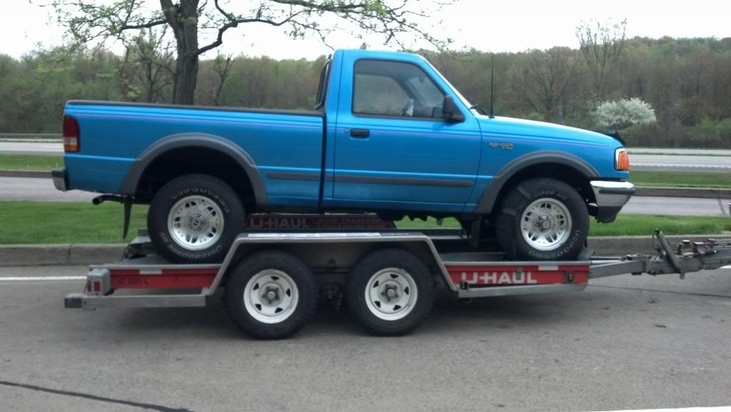

its a wonder i didnt blow my trans. towed the ranger on a 2 wheel u-haul dolly 15 miles to the farm to work on it, pulled it up onto the dolly in 4L, front hubs unlocked, front driveshaft had also been removed. left it in 4L. turned engine off just out of habit, pulled at about 45 mph to the farm 15 miles. (t-cas still in 4L) so the output shaft of the trans was probly spinning at a rpm equivaleant to 70+ mph if the t-case had been in high range. must have got lucky, seems to have no ill effects from it all. not sure how. must have gotton enough oil splashed around before transport that it didnt burn a bearing up. maybe the angle of the truck on the dolly was enough to have the oil level high enough at the back of the trans. thats a possibility. i still say i must have gotton lucky, now that ive read this.
