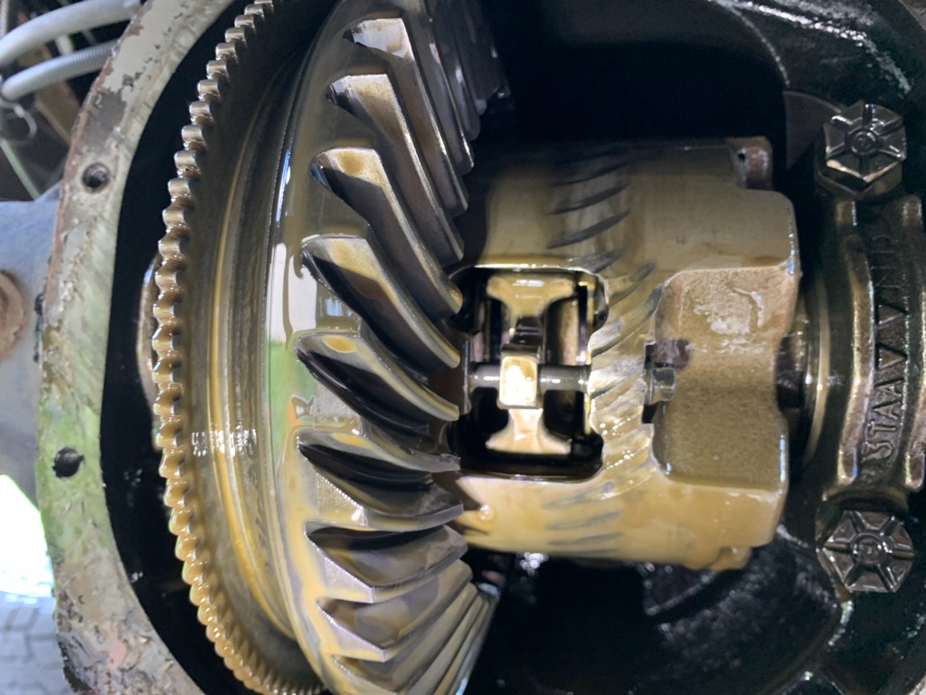

First, thanks to everyone for posting so much valuable information. I'm working on a buddy's truck (a cherry 2003 FX4 LII with 102k, manual gearbox + stick transfer case selector) and I've gleaned some pretty valuable information here. Awesome forum!
Anyways, he called and said his rear-end started making some pretty loud, rhythmic clunking sounds on his last mile home, which worsened when he took his foot off the gas. He noticed it was leaking a little fluid in the driveway after the trip.

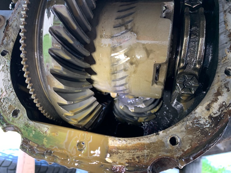

I got over there and noticed that the rear diff was leaking fluid at the pinion seal and that there was a quarter-inch of play between the yoke and the diff. Uh oh. I prepped him for the worst. Fully expecting catastrophe inside the diff, I pulled everything apart to find that the pinion nut had walked itself off so much that I spun it off the last six revolutions by hand. I pulled the shafts and carrier and was able to extract the entire pinion by hand!
So, the noise he was experiencing was the pinion grinding against the carrier. The carrier looks worse than it is and the end of the pinion is a little banged up, but the teeth look great on both. My plan is to replace the pinion bearings/races, seal, crush sleeve, and nut, and then the axle and carrier bearings because we're in there. Leading to me to a couple questions for you Torsen pros:
1. Am I crazy to re-use the carrier, and the 4.10 ring and pinion? I'm going to de-burr the ends of the pinion to clean them up, but it seems like the slight damage is beyond where the properly shimmed ring will contact the pinion gear.

Judging by what I see in the photos, I'd clean it up and run it. A brand new pinion nut might not be a bad idea, or at least clean the threads with brake cleaner and apply Loctite when you put it back together.

I agree with eric. Install a new pinion nut and take it for a test run. Those marks on the carrier are just surface scuffs, no? If they are, pinion nut and give her a test.
where did the metal go from all those nice gouges?
if it were mine a very thorough cleaning of the entire axle would be in order.

Those are definitely more than "scuffs". "Gouges" seems almost right, maybe a little heavy-handed. My primary concern was the weight of the diff being off-balance, but it is uniformly distributed around the circumference of the carrier, and the same with the pinion, so my instinct is that it's going to be ok. Only time will tell.
There's surprisingly little metal in the bottom of the diff. But it doesn't appear there's a lot of metal missing from the carrier or the pinion. That does make me nervous, so we're going to clean the s*** out of it and flush everything (especially the axles tubes) with a bunch of gear oil.
Make sure to wash out the axle tubes thoroughly, any residual metal particles will ruin the new bearings. I'd also replace the carrier bearings and wheel bearings because they've been run in the metallic fluid and the the differential apart to clean it out. It might be worth dressing the ends of the pinion teeth with a file if they have any signs of wear. A pinion nut should never loosen, if it's not a new one it's supposed to be installed with locktite. I've reused a lot of them and locktite has held them in place. If the gears make some noise you'll probably get away with it in a truck.
