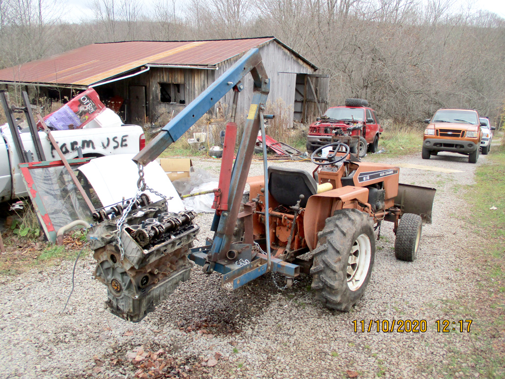

Interested in what people do to make things easier, I like building my own stuff when I can, so I'm looking for winter projects.
The other day we decided hooking the engine hoist to the 3 point hitch on the old mini tractor would be easier than dragging it around on the gravel driveway.. EZ mod and I can always bolt the legs back on to use stand alone again.

I like how you officially and legally registered your truck for farm use... :icon_rofl:
Hey, anything worth doing is worth doing right... ;-)
But seriously, up until a couple of years ago as long as you had insurance the local LEOs didn't care, as long as you didn't travel too far from home. Recently they've started cracking down, Farm plates and all that..

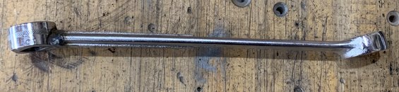

The other day I was asked by a co-worker if I was missing "half a wrench". I then had to go into an in-depth explanation for the new kid why I have a 25mm wrench that I cut in half.
The lower EGR tube nut on my Ranger is 25 mm. The full length wrench did not have enough room to swing at all, so I cut it in half. I then found that the box end is handy for the top of my brake clean sprayer, and tends to end up all over the shop.

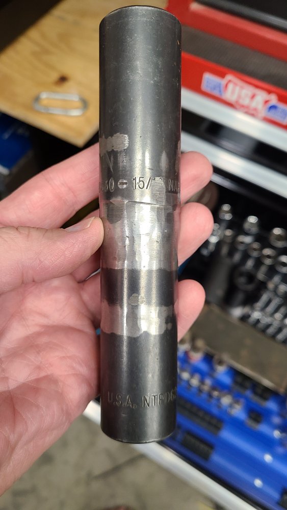

Ultra-deep 15/16" socket

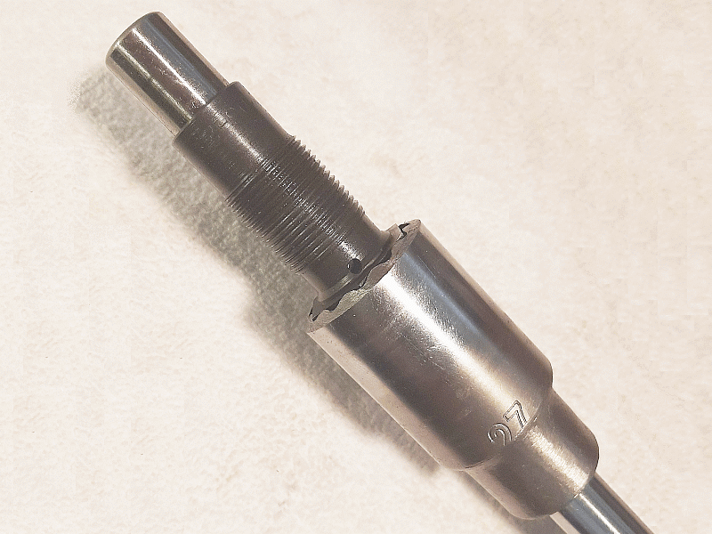

This tool loosens/torques the rear lower right hand head bolt on a 460 in my '75 Ranchero without having to remove the A/C evaporator case.
Modifed 27mm (1+1/16") 12point DeepSocket
Depth\Length Shortened & DriveEnd Narrowed with BenchGrinder,
to ease replacement of OilPressurized TimingTensioners in a 2001 Ford V6~4.0L~SOHC Engine;
provded clearance between IntakeManifold & ThermoStatHousing, plus reduced interference with TensionerWasher.

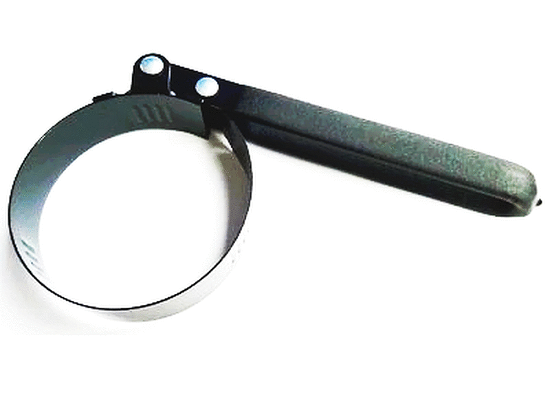

Modified OilFilter StrapWrench
Handle bent 90degrees for better clearance.
HingePins replaced with JamBolts+Nuts for using Socket+Extension+Ratchet.
Velcro added inside of strap for better grip.
Makes stubborn OilFilter removal easier in tight quarters.
