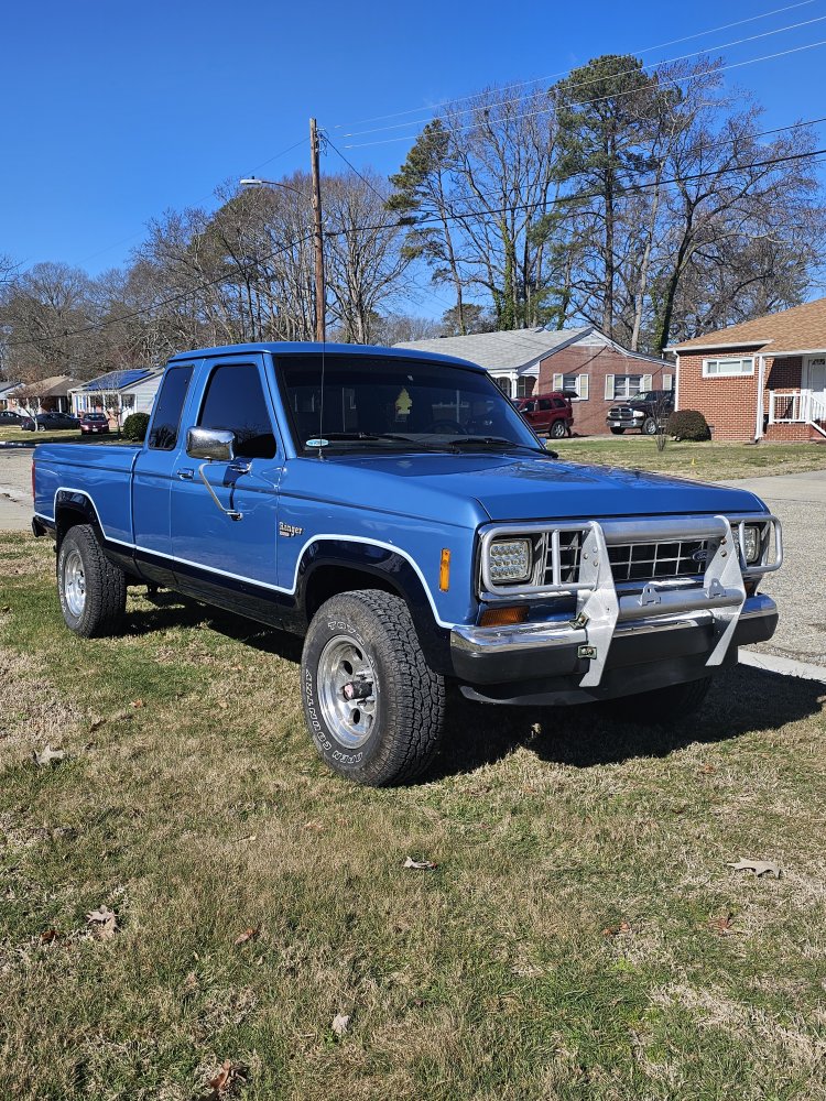

Hi there, I bought a all original and very well kept Extended Cab 88' XLT 4x4 2.9L '5 Speed with 106k miles last year in August. Truck runs great without any issues and still does now.

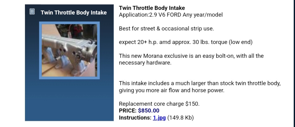

I was pretty interested in their bolt on Twin Throttle Body Intake that they sell and I had talked to Tommy himself earlier today about it. He had explained that the Upper Intake is bolt on with some minor modifications to the throttle cable and a custom air intake. But it would not require any ECU tuning due to the system being Speed Density ran.
It advertises that it adds over 20hp/30lb-ft of torque and considering that these engines came factory with 140hp, it would help getting it up to speed quicker. I don't want to turn it into a race truck, just make it where it can get out of its own way.
Has anyone here bought and used this on their 2.9? What was their experience like and did they have any issues? Would it be a easy bolt on power adder and be viable for my application? Would I need any ECU tuning?

I would trust that if Morana says no tuning necessary, that is solid info. He definitely knows his stuff. Those parts should be bolt-on easy with maybe a little bit of adjusting or tweaking to mount stuff to the outside. I would recommend new gaskets.
The 2.9 in the Merkur Scorpio has a twin tb, short runners on the intake and makes 4 hp more than the Ranger intake.
Leave the factory truck intake on, it matches the cam. The 'easy' trick is to get a scorpio Upper plenum and a scorpio cam. They work well and the powerband is widened upwards significantly. and the scorpio uses mechanical lifters. Morana's intake doesnt flow as good as the scorpio's up top, but it still retains the truck-like torque. I ended up ordering a cam, lifter, and valve spring set from Piper in the UK. Along with the upper plenum and headers you can easily make near 200 without pulling the engine. Heads need to come off to swap the lifters.
Just do a valve adjustment procedure to shut the lifters up. 2 Full turns of preload like the TSB says. That and an oil pump is all it took to get my '87 into top shape before I boosted it. Pro tip: Pull the engine to do the oil pump. It took me 12 hours of labor to do it in the truck, compared to the 10 casual, bullshitting hours it took to pull the engine and do one AND do a complete reseal on my buddie's.
Get a standalone ecu so you have the ability to tune it. Tuning EEC-iV is old news. the ecu and a solid tune in itself will also help.j

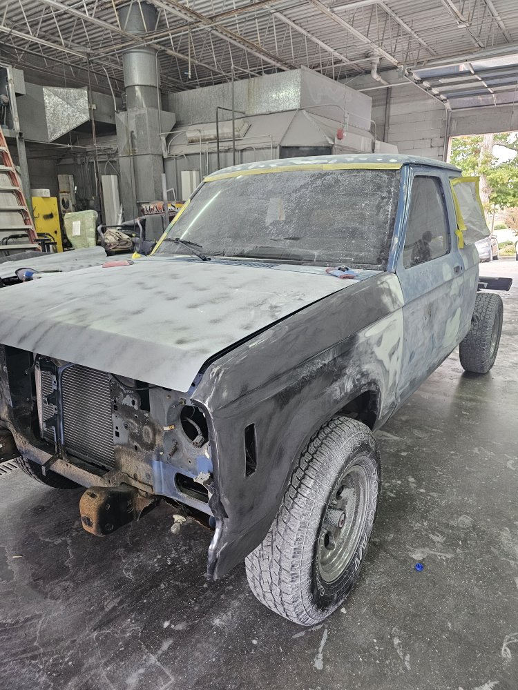

I see, to be frank with you, I haven't had much experience with the 2.9L and have only owned this truck since last August. I had a brand new paint job and some body work done and just got finished up back in December. The truck had 106k miles and I'm almost to 110k so haven't had a lot of seat time.
Tommy Morana Twin Throttle Body HELP

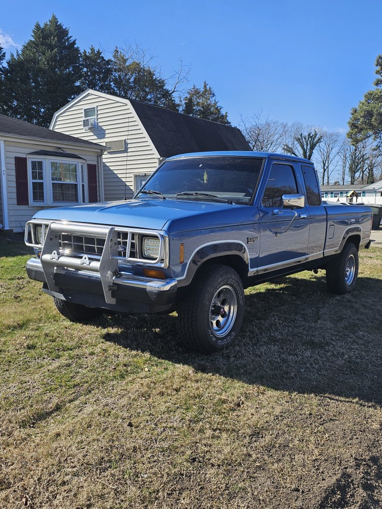

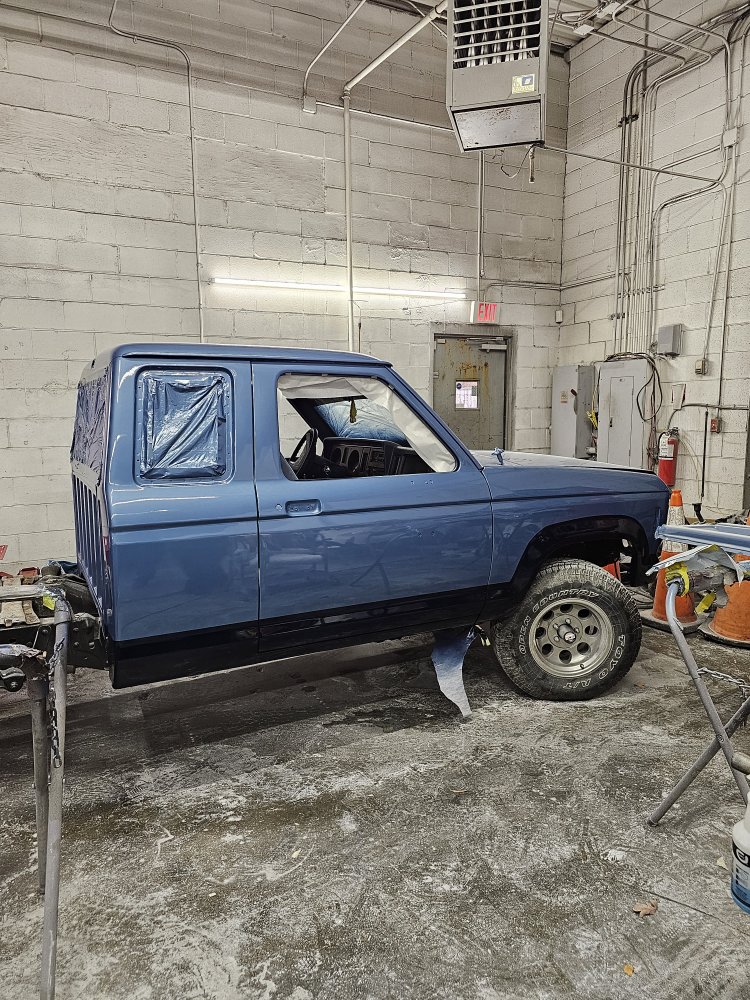

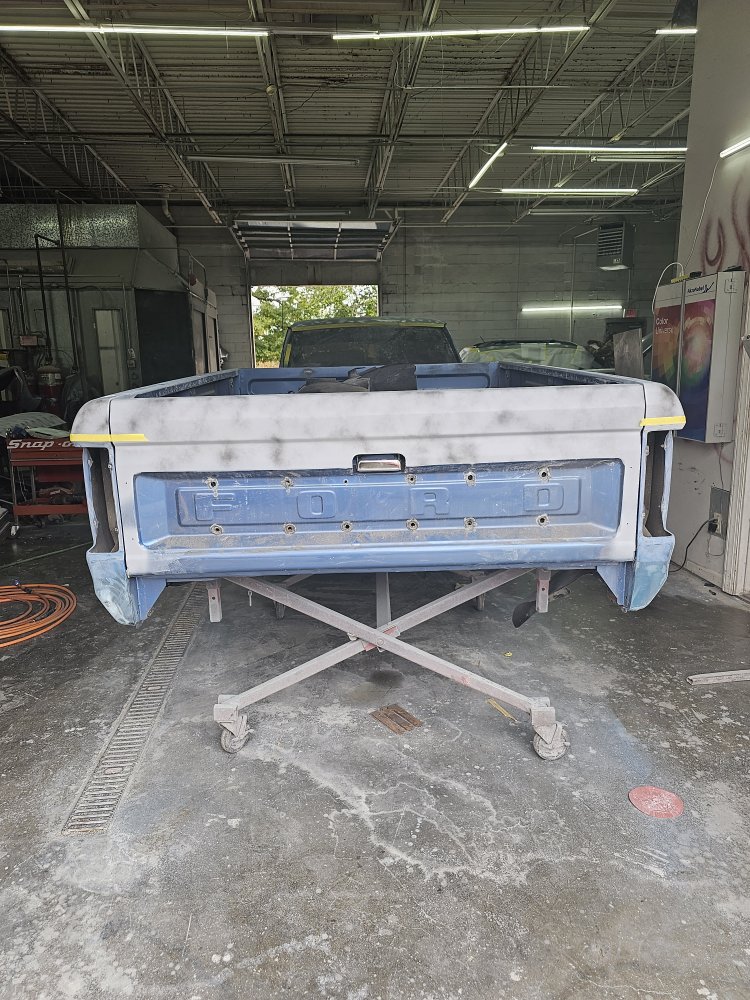

Really nice looking truck. Did you take pics while doing the work?
Yes sir I did although I did not do the work myself. I had friend of mine do it for me.

I bought this truck out of Fredericksburg, VA. Truck was a typical "Owned by a Grandpa" and was religiously maintained. The interior is immaculate and was preserved because of the window tint. Had right at 106k miles when I bought it and I have about 109,600ish right now. The underside is completely rust free and has had a full underbelly rust preventive coating.

I'd say the most difficult part of the paint job was the pinstripes. Nobody makes factory vinyl pinstripes for these trucks so I had my buddy hand paint them on and are 100% custom to the truck.
I think his HP/TQ gains are a bit on the optimistic side from just a throttle body.

Hi there, I bought a all original and very well kept Extended Cab 88' XLT 4x4 2.9L '5 Speed with 106k miles last year in August. Truck runs great without any issues and still does now. View attachment 105701

Has anyone here bought and used this on their 2.9? What was their experience like and did they have any issues? Would it be a easy bolt on power adder and be viable for my application? Would I need any ECU tuning?View attachment 105700
I bought this same intake for my ranger before I sold it . It bolted on no problem and I noticed a nice difference.. I bought the fuel rails with it aswell they looked so nice . I regret selling it

Not to bag on Mr. Morana or his products but for a no hassle installation and very little expense a 86-87 stock 2.9l T/B can be overbored and yield a consistent +3 hp bump across the RPM band with no other actions required (approximately 50% more yield than the HP increase from a +0.05" overbore rebuild).
I realise that +3 hp doesn't sound like a heck of a lot but that increase will be realized at every engine RPM and not effect the max HP/TQ RPM requirements 🤓
