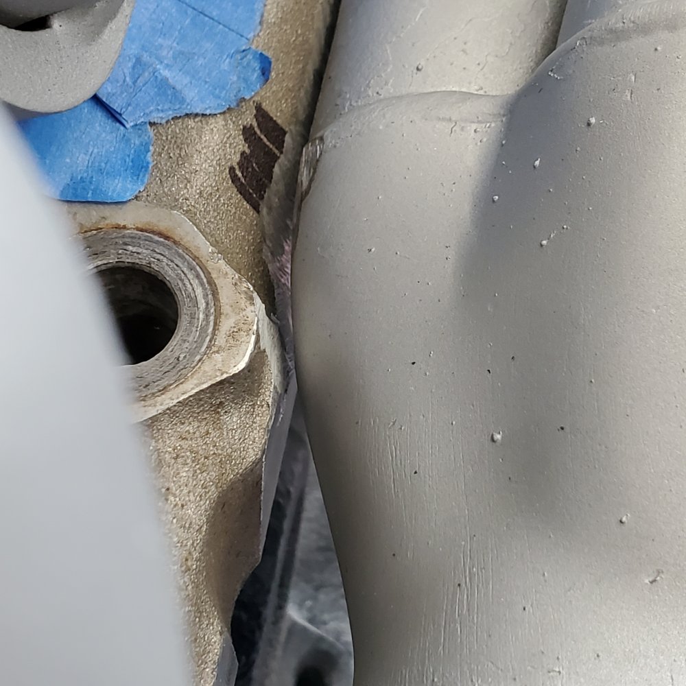

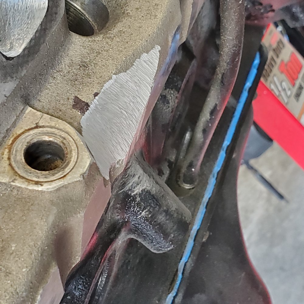

They will...BUT.. You WILL have to grind on the heads..at least trick flow heads..
On BOTH heads

That's not so bad. My main concern was the bolt pattern being different, exhaust ports not lining up, or spark plug interference.
