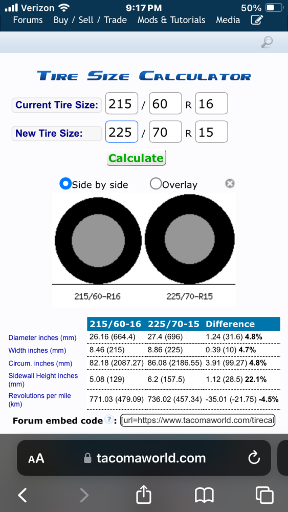

A ‘88 2wd would be 14”s, most likely 195/75/14’s. very few choices on that size, ntb had 1 tire of that size 5 years ago. some off brand. 225/70/15’s arent easily found now either. Im currently running 215/60/16’s as my winter set with 4.10 gearing, heres the comparison on that size vs 225/70/15’s:
