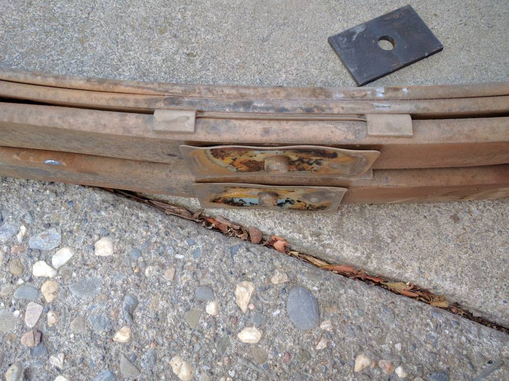

They even threw in these super hard to find 2 inch lift blocks.

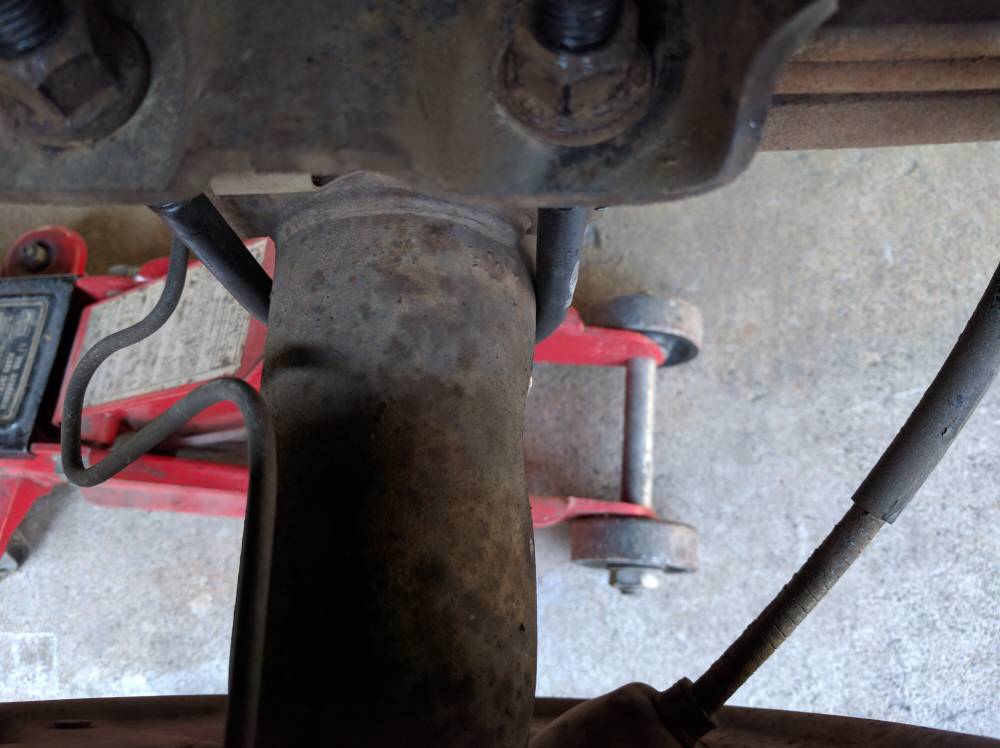

Correction: the tires do rub on the sway bar at full clock. Not a big deal though.
But nothing else is in the way.

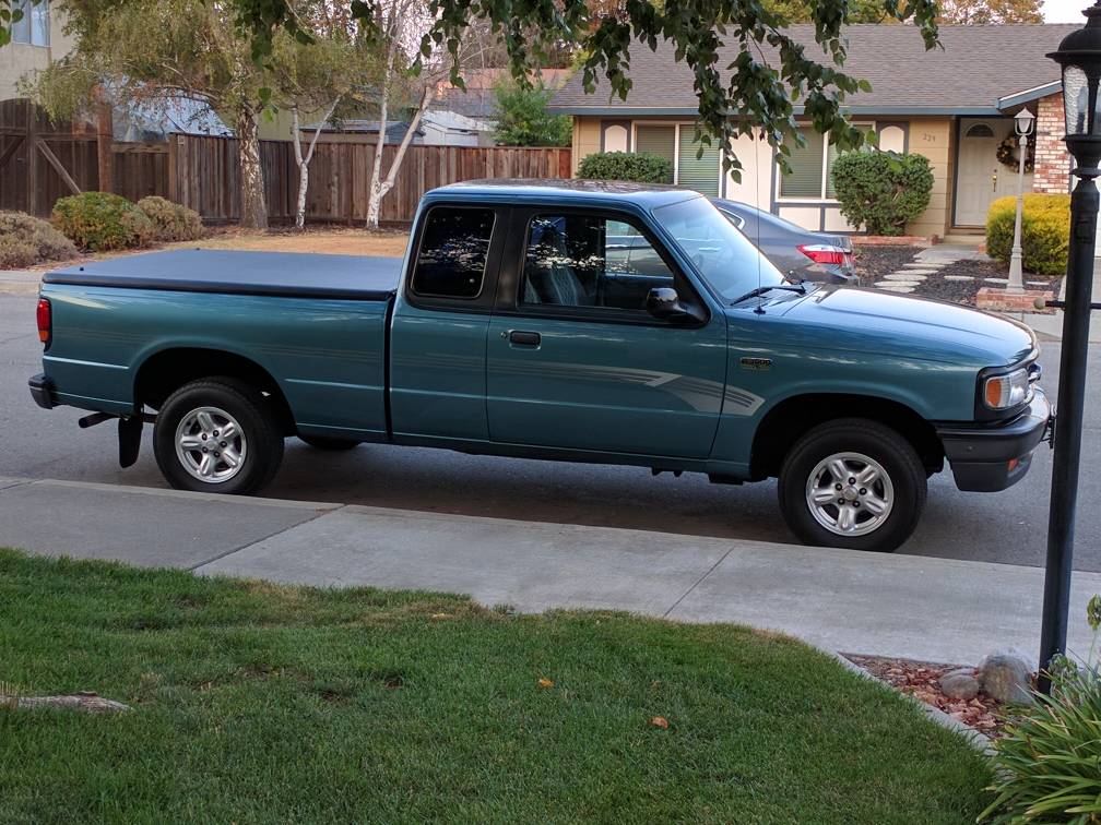

So for the record. You can sort of fit 255/70r15 tires on sock 15x7 wheels on a 2wd, stock twin i-beam ranger.
Here's a better picture.
I hope this helps someone in the future.

If I had known those were hard to find, I wouldn't have left them laying in the junkyard when I got my axle last week.

Looks good!
