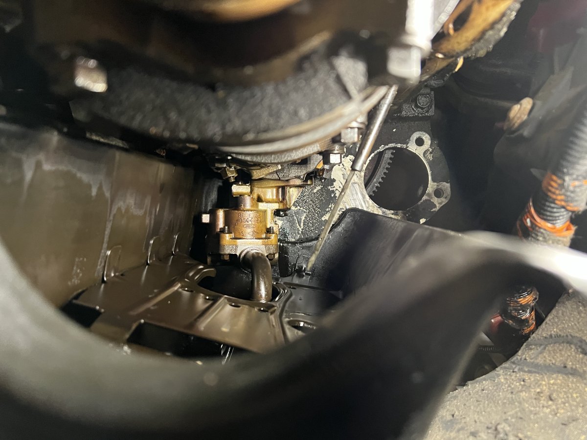

Yep, although it’s a tight fit. Nearly there. I had to buy a second copy because I lost my last one in a move.
Awesome man. Don't get yer fingers caught in there

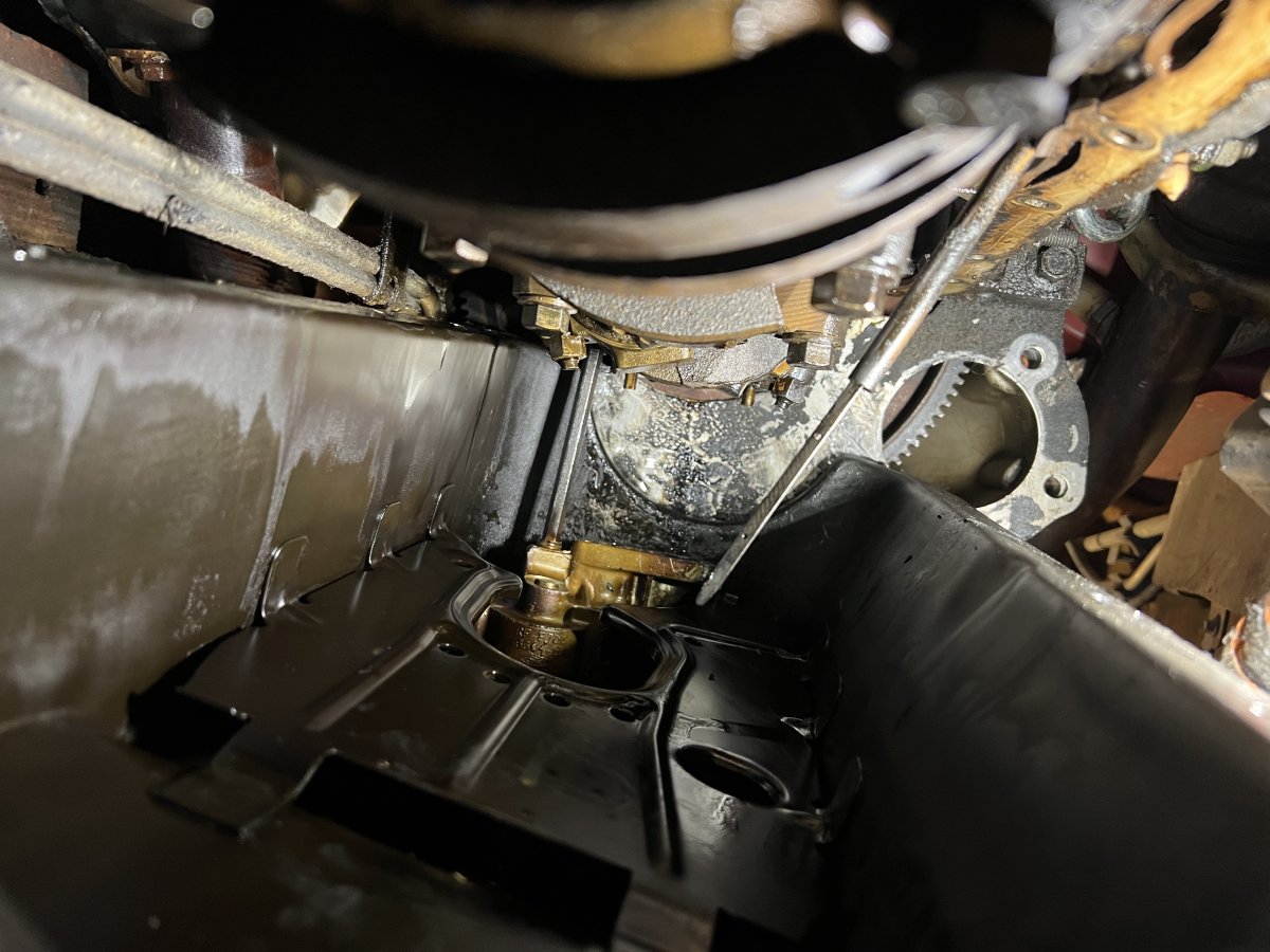

They weren’t kidding about a “tight fit”.
Is it easier to pull the motor on a 3.0 or pull the trans? I got the motor lifted to it's max and the trans jacked up. I unbolted the oil pump and it dropped in the pan, but the shaft is still in the motor. I've tried lifting the pump with a long screwdrivers/pry bar to maneuver the pan but don't have enough clearance.
I am looking for an engine lift and or transmission jack because I think either method will provide the clearance I need. I can't imagine having to install the pan and the pump as an assembly with such limited space.
Looks kinda like a ship in a bottle.
