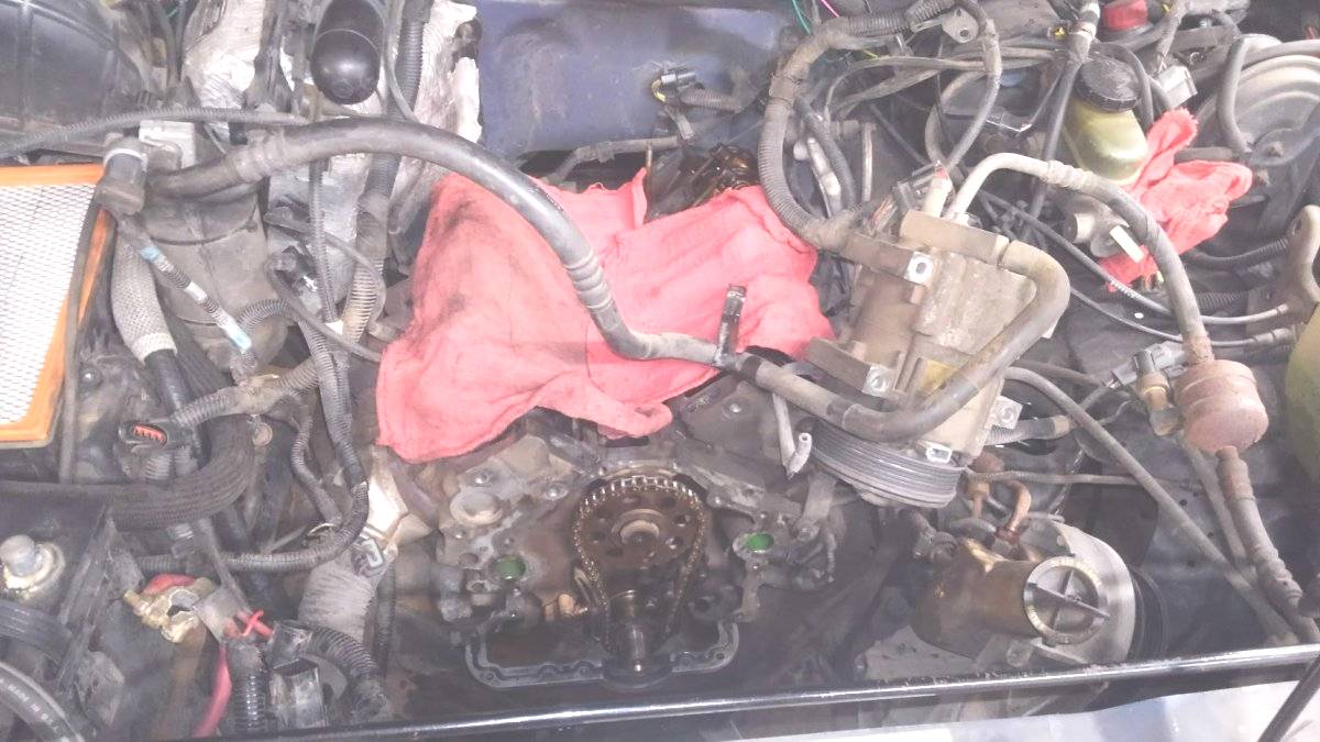

Lightened it up a bit. That pan sticks out there a ways

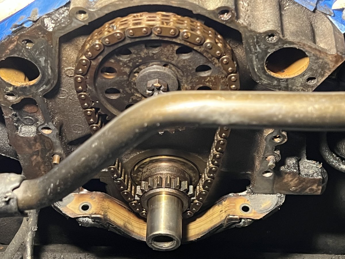

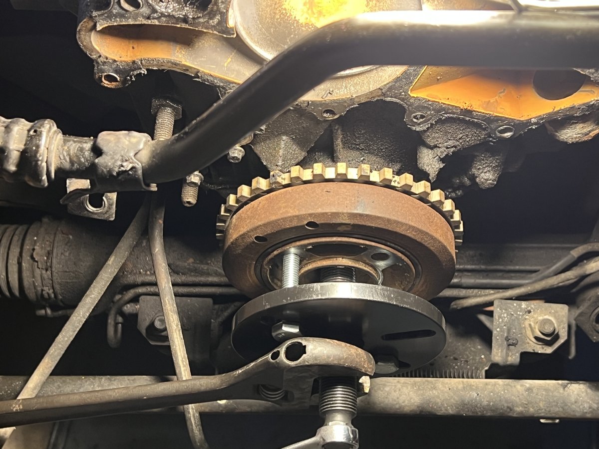

Well, took off the harmonic balancer and timing cover. The cover did not want to release with the 2 front oil pan bolts so I also removed two more which in hindsight probably didn’t do much to help. I gently pried and the oil pan gasket definitely wanted to stick. I rotated the pan as it held in place and used my plastic putty scraper to help keep the pan gasket from tearing off which seemed to help. However, according to YouTuber Ford Tech Makuloco, if you have a tan, floppy oil pan gasket instead of the rigid style, you gotta replace it. Also noticed on the rear pan bolt, an o ring seal broke. 😞

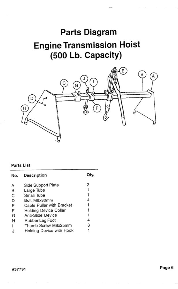

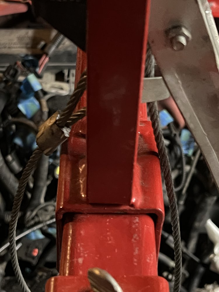

Well, I picked it up today. Looks like these supports/hoists were sold around 1998 and made from heavy wall tubing. The weakest link appears to be the come along weld, although they are rated for 500 lbs. I can see why the newer ones don’t use come alongs and just use spider handles on threaded rod. Mine has an attachments for a holding device that is threaded which I will use as safety before going under the vehicle. Also has an accessory offset bar attachment for increased stability transmission support. Overall I think it will work and since it was on offer up, paid only $35.
Awesome man, you came out like a bandit on that. It looks better than any of the others I've been seeing, and likely built better. A year in manufacturing days can be worlds away in design, materials, and workmanship.

What does that "holding device", "J" do? I think on some of those cheapies and home made there was somthing like that for lifting it
