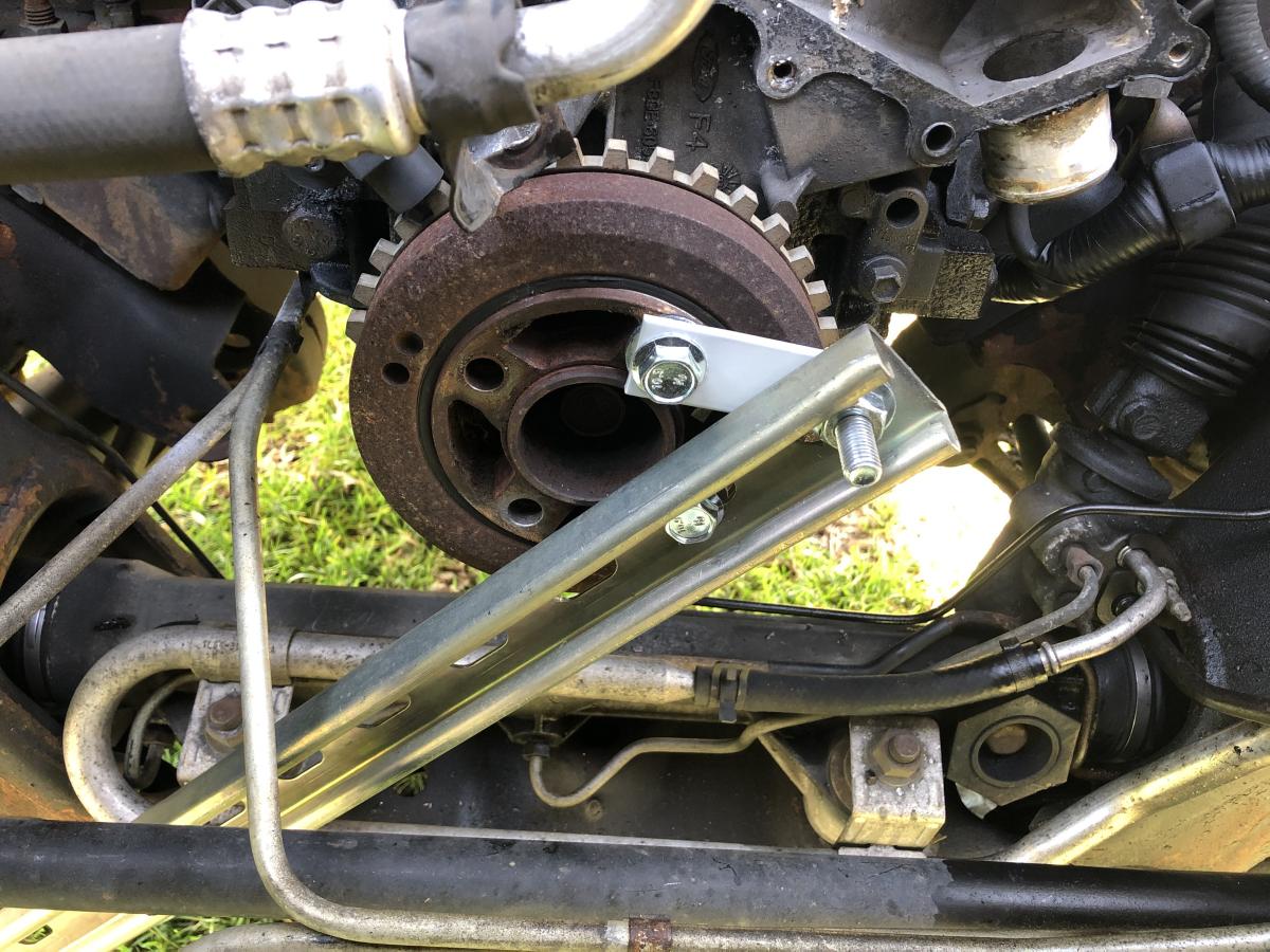

The damned harmonic balancer fought me all the way, including the center bolt (I think my impact driver is crapping out). So I improvised a tool:

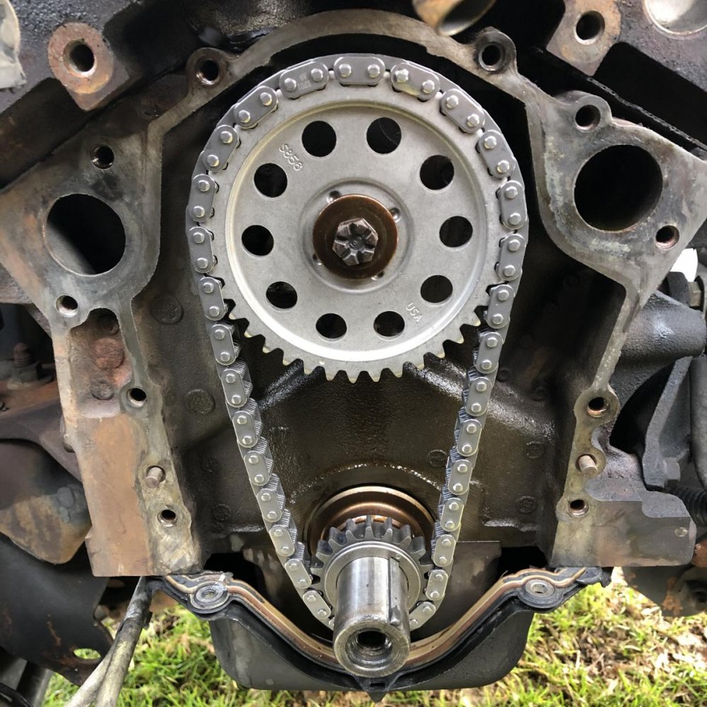

The timing cover is now off and the oil pan gasket looks OK - I'll have to get sealant between it and the pan since it is now loose there, but undamaged. However, I found the timing chain is indeed stretched, so I ordered a timing set.

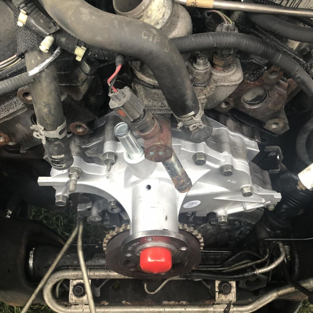

Well I made progress - it takes so much time to clean up parts and hardware. And did you know that the fan clutch support is left hand threaded?? :unsure: Yes, I'm that dumb sometimes! Still, the timing cover, water pump and harmonic balancer are back on with all bolts torqued. The sealant can set up while it's fairly warm. I put a new timing st on but in the end I don't think the new one has any less slack than the old, so that was probably a waste.

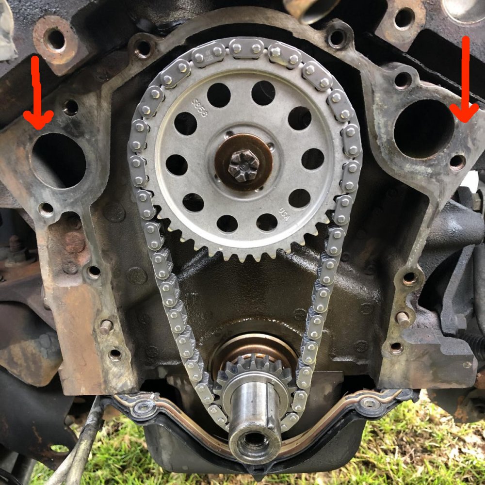

Now it's just a ton of fussy brackets and hoses and crap, and trying to get the air out of the cooling system. I thought I had the block cleaned up pretty well until I looked at this picture, and then I realized I had more junk to get off:

I may have had the same weep/leak as yours. Is it time consuming as you said and at the time of discovery I decided to use "Bars Leaks" stop leak. That has worked and I'll get to fixing the leak in the spring. From the picture above can you pin point where the leak was coming from. It may help me when I fix mine. It appeared to be coming from a bolt hole in the upper left.

I wish I had taken a picture of the back of the timing cover. What happens is that eventually the factory gasket leaks a little around the large outlets in the front of the block (arrows). It does not appear they used a sealant with the gasket, or if they did it was not an RTV. Once the antifreeze gets behind the aluminum timing cover it starts to corrode the material and the gap grows over time. Mine was certainly re-usable, but it definitely needed RTV - of course I don't know if it seals as I have not got it back together yet.
Note also that a lot of the bolts go through into coolant passages (possibly some into oil passages??) and are coated with sealant at the factory. I used Permatex Ultra and coated the bolts first. Whatever the factory used seems more like that stuff they put on shaft seals where you press them in, not quite as pliable as RTV.

Mine leaked where your red arrow is on the left of the pic at an upper bolt hole. At first I removed the offending bolt and cleaned the threads on it and in the block and resealed with Permatex thread sealant. It took about 3 days but the weep came back.
I already had a leak in this same area several thousand miles ago and fixed it - but I guess not the best. I think the thread sealant leaked, but will know more when I get in there in the spring. I'll find a new thread sealant.

I suspect the leak was at the cover gasket, then out around the bolt, but not at the threads of the bolt.
