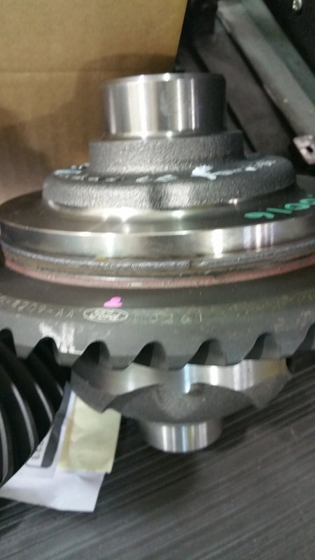

Here is what the weld looks like. Sorry it took so long but like I said they don't run it every day.

Any idea why they switched to welds in place of bolts?
welds can save weight. a robot can do it. bolts have heads that stick up, so welds eliminate that. welds are easier to balance if needed. less machining, no holes and threads. its faster.
just a few. but i could be wrong on all lol
