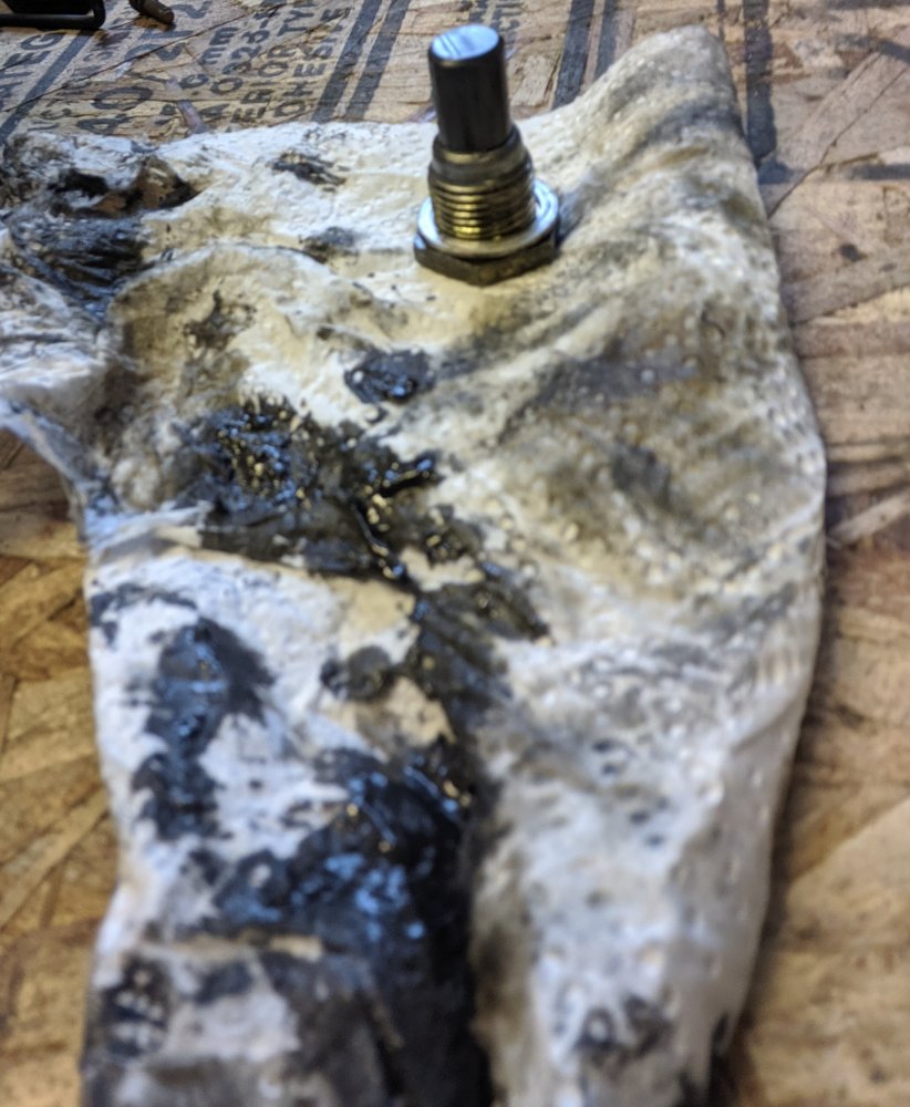

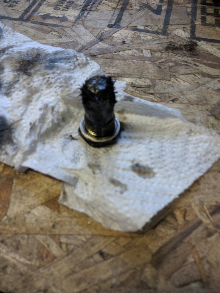

But perhaps I should. I pulled a lot more metal out of this thing than I like to see. The "fluid" inside was a dull gray, smelled like used axle grease & very thick like what you pull out of a polisher after you run bearing balls through it. The magnet was so coated it didn't want to pull through the hole. New one will get built this summer, maybe I should get a 2.8 for it and p*** off everyone that wasn't offended by my carb swap ;missingteeth;
