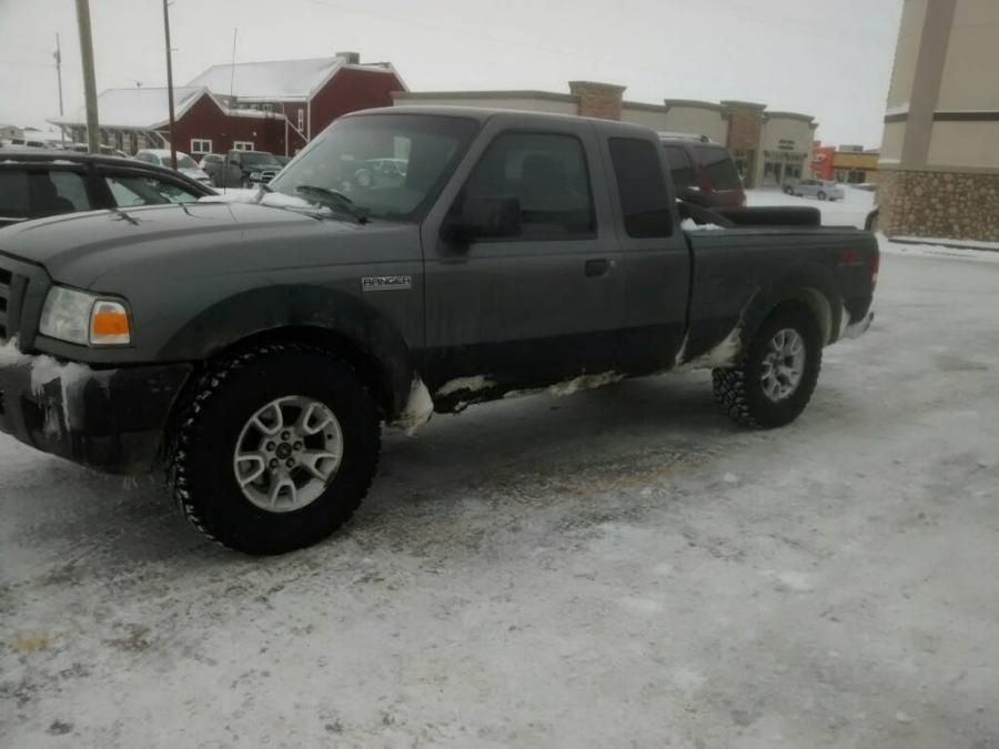

I bought this truck back in August of this year when my girlfriend and I moved from pei to Alberta, Canada. She's a 2007 FX4 off road with 200k kms, Interior was immaculate, paint has seen better days but hey it was a good deal.

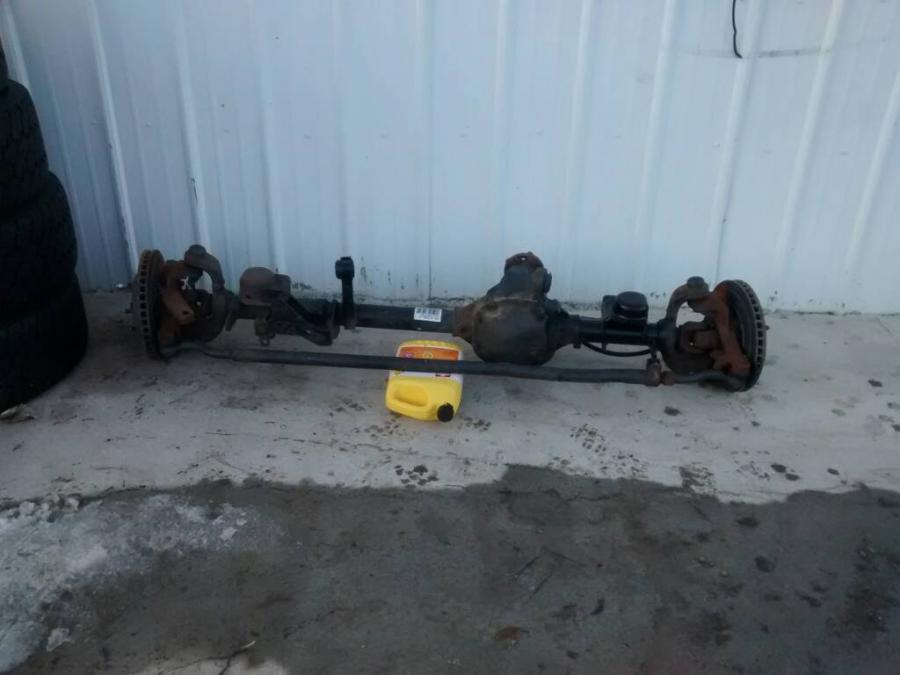

I picked up (basically stole) a d30 and d35 from a guy for 500$ a few weeks ago. They're out of a 2010 wrangler yj sport with 40k kms on them and 3.73 gears. I know I'll need to regear for sure to at least 4.10s cause that's what it has from the factory.

I also sold the rear d44 for 500$ so I've got 0 doll hairs into the axle at the moment, as for the abs situation I'm going to use my ranger hub assemblies and graft the ranger brakes onto the jk knuckles. Should be picking up a track bar from a jk this week, saw a build thread for a guy in BC with a d30 SAS sport trac (same guy that I stole the ranger brakes on jeep knuckles) he used the stock jk track bar, cut the axle end off and welded in a tube insert and used a heim.

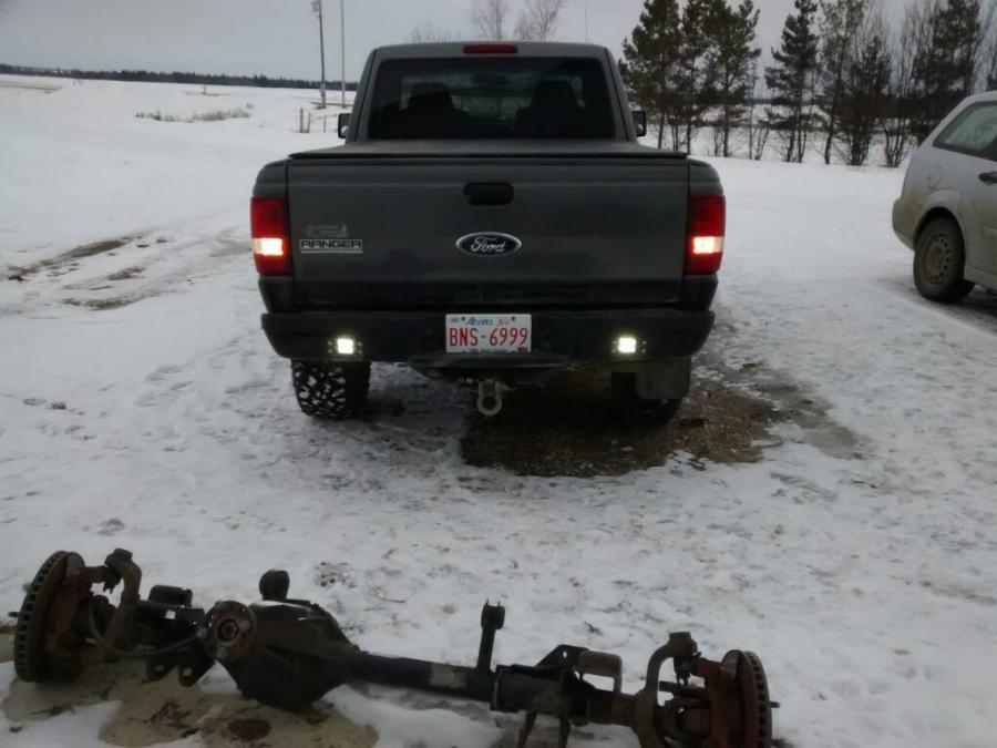

Picked up a couple flush mount eBay LEDs for my bumper reverse lights. Wired them with a relay so they can turn on with a switch from my switch panel, or automatically come on with the reverse lights.

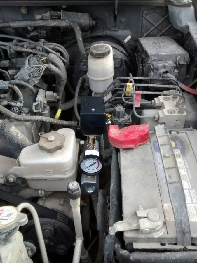

Also picked up a few parts for on board air yesterday.

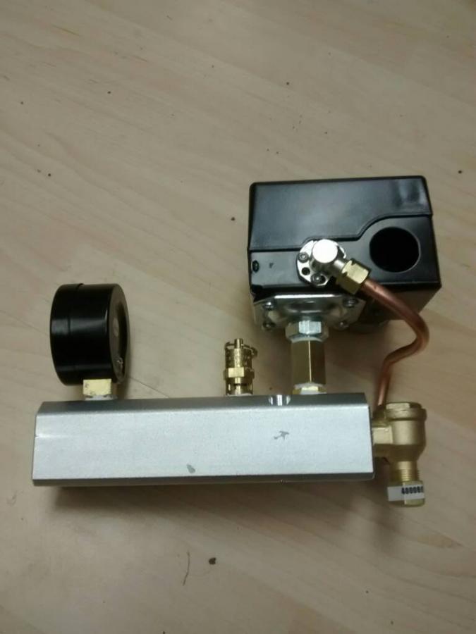

The input from the compressor is on the bottom of the little brass manifold on the right. The pressure switch is on at 95 off at 125 psi and has an unloader valve. Not sure what's going in the empty 1/4" npt hole, might plug it off. The 1/2" npt hole at the from will get a hose barb and probably high temp hose down to a tee at the frame, the front end of the tee will go to a quick connect chuck in the grille/bumper and the rear part will head down the frame to the tank(s). Haven't got a tank yet so I'm thinking a couple of sausage tanks, one on each side of the frame.

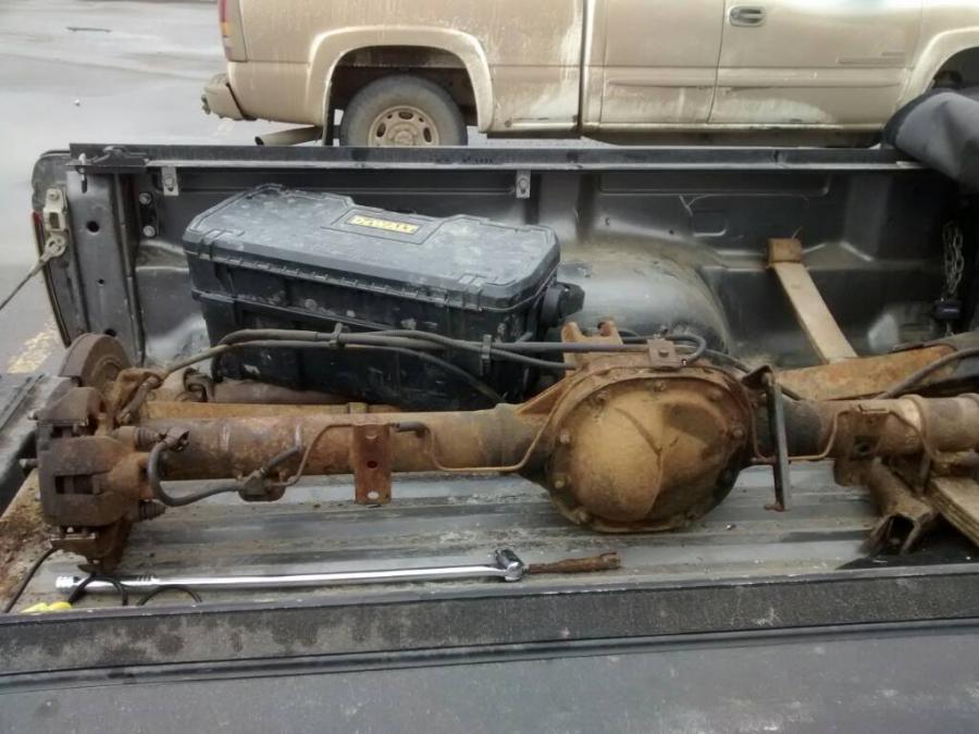

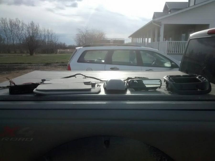

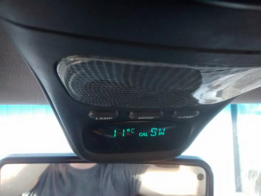

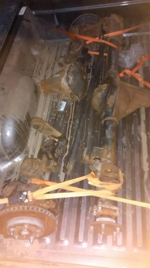

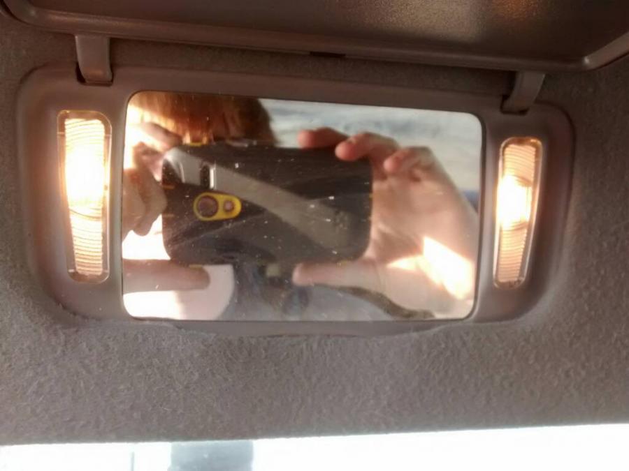

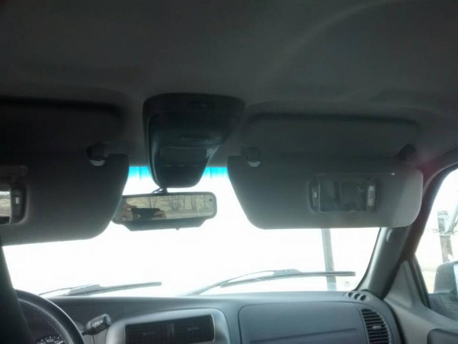

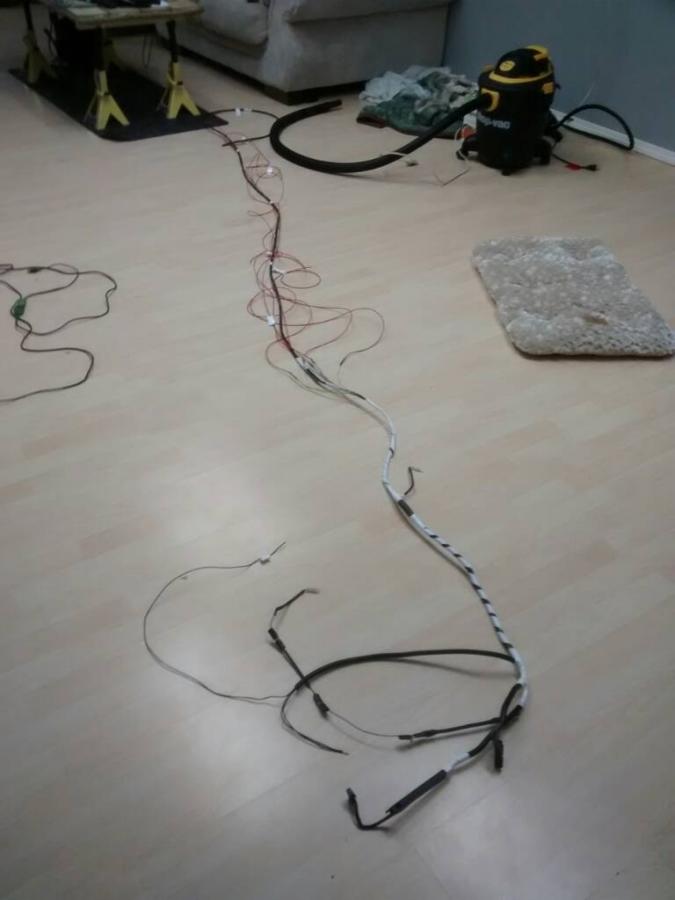

Picked up some stuff from a 95 explorer that was being parted out on Friday. The main things that I wanted were the front driveshaft and rear axle (with discs) and the leafs of course! When I got there i took a peek inside, limited trim fully loaded. So I grabbed the ohc/visors/auto dim mirror, eatc, radio bezel, and wiring harness for the visors and ohc.
Extended the wiring harness and split them into groups based on where they had to gouploadfromtaptalk1430081240573.jpg
Then I installed them yesterday! Well I actually had an ohc already and I installed it 2 weeks ago but needed to move the bracket ahead 1/4" to get it to snap into place. So I got that sorted out, mirrors hung, harness routed, and tapped into everything. The only part I haven't hooked up yet is auto headlights because I had no relays.

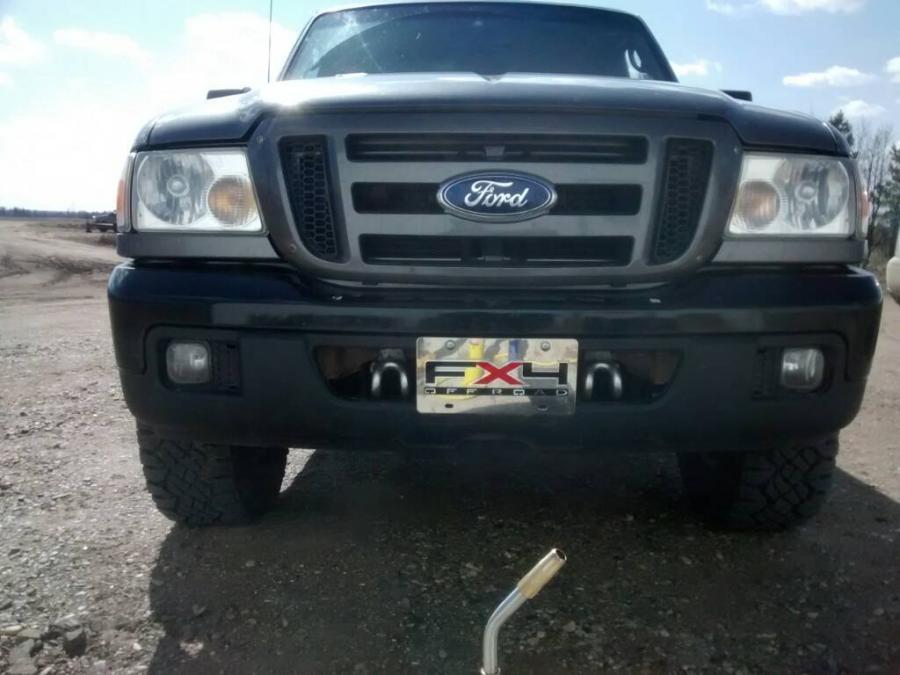

Then today the level 2 hook bug bit me again so I used a mapp gas torch that I picked up on Thursday, originally to use for pulling the explorer 8.8, popped the old loops off and had the level 2 hooks on in less than an hour!uploadfromtaptalk1430081598236.jpg

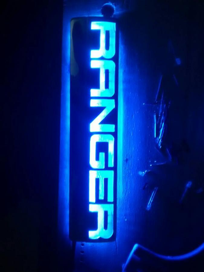

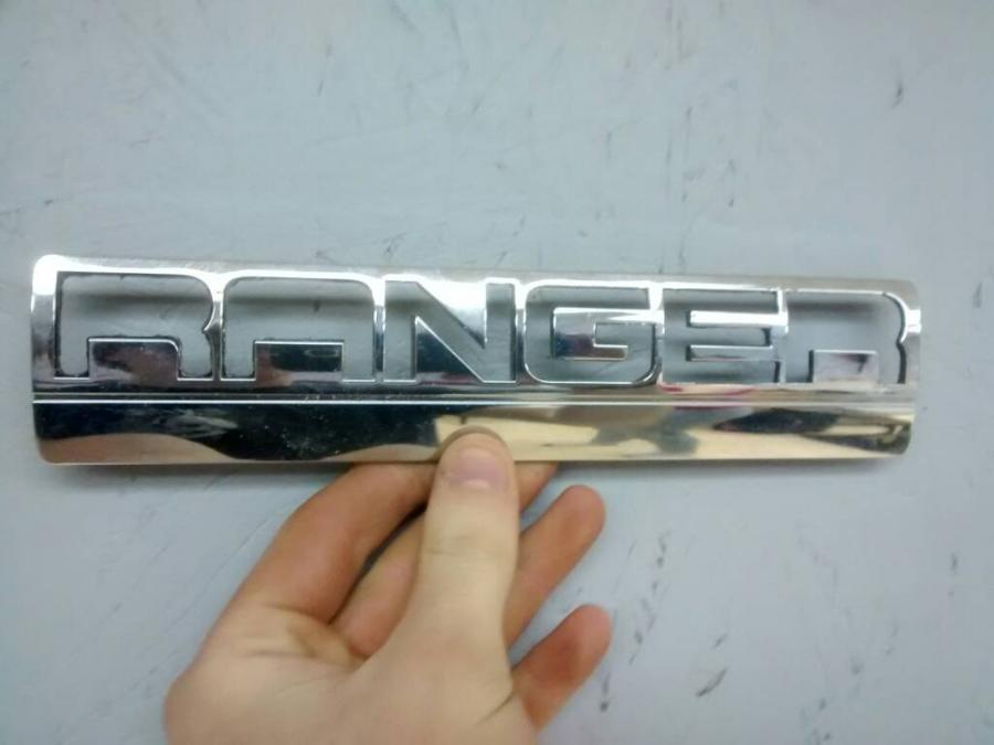

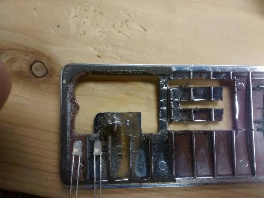

Now to start working on my led fender emblems again! I forgot to post them on here but I'm working on making backlit ranger emblems (06+ I think, mines an 07 so they came factory).
Here's a few teaser pics..
Peace out for now!
Doing some more work on the emblems today, just have to get the LEDs to sit flat in behind the emblem. This is just a teaser pic, when its on the truck there should be no light leaking around the edge.uploadfromtaptalk1431218564538.jpg
Another small update. A local guy is using the same axle as me to SAS a 2000 explorer and he's got his original unit bearings on the axle! So I'm on the hunt for a wheel bearing assembly to see if the sensor will work with my abs computer.
On another note, the ranger emblem is in need of redoing... I screwed up the epoxy, half of the emblem is cured and the rest is still sticky after 15 days :( oh well, failure is how you learn I guess! On to attempt #2!
