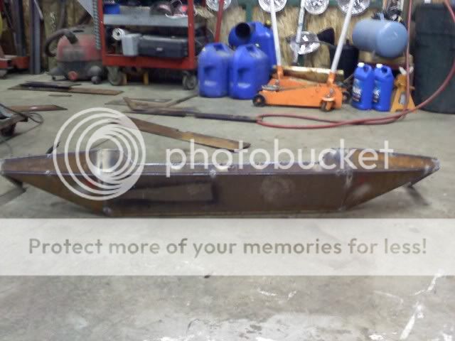

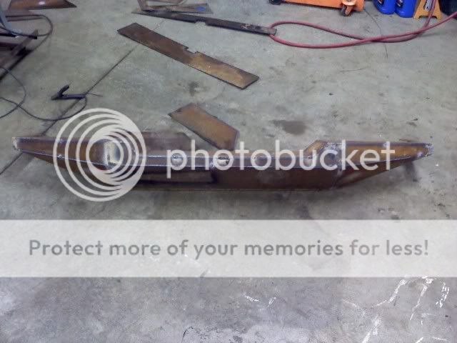

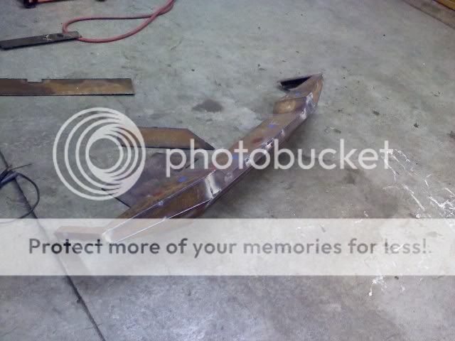

making progress...
tacked...

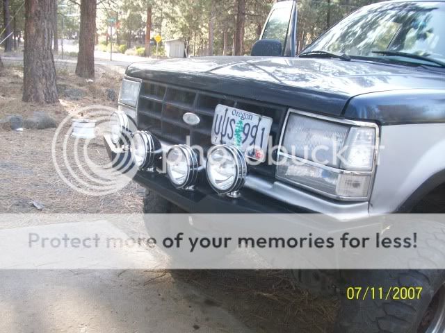

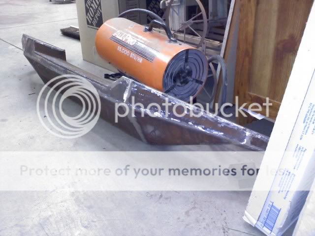

Burned in, mostly grinded...

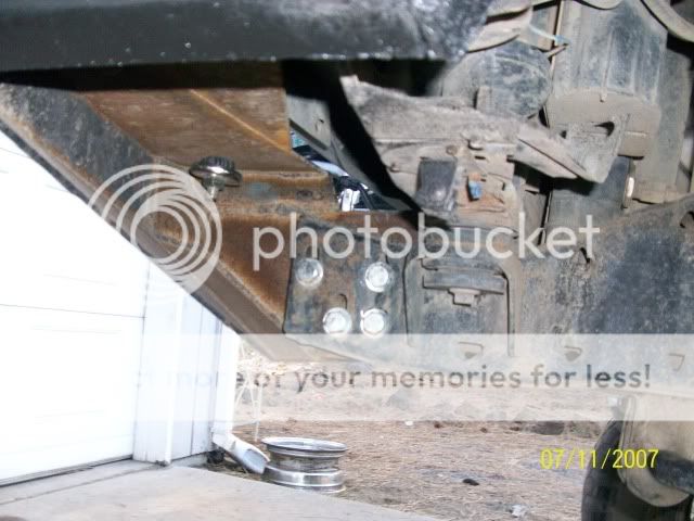

Not fully mounted, just set up to get bolt hole locations, etc...

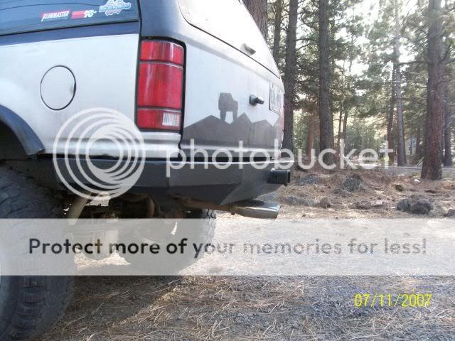

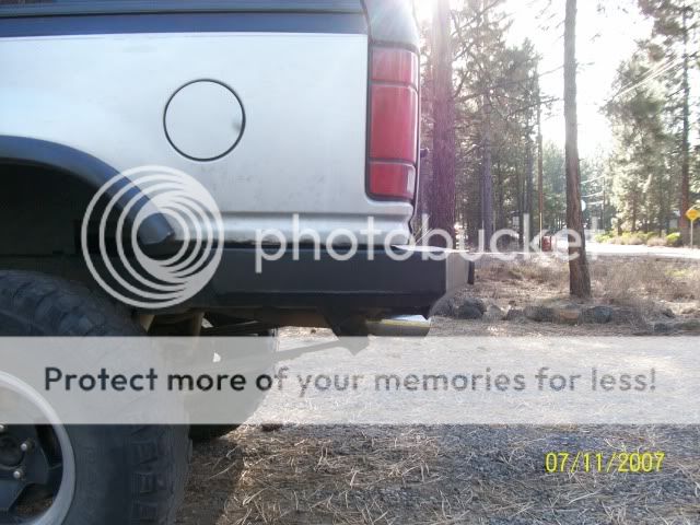

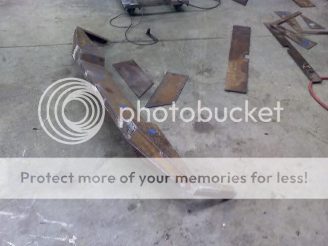

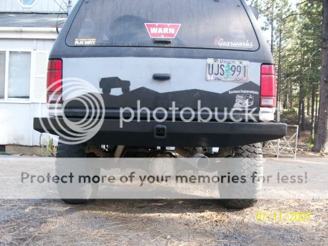

New rear pics...
the rear is 6" wider to fit my flares and protect my rear quarters

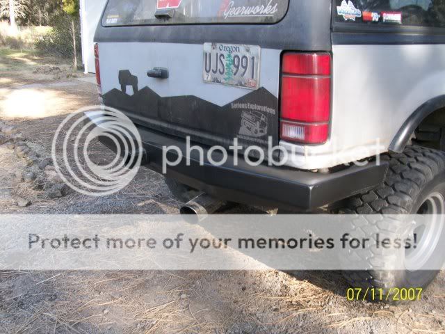

its nice for expedition wheeling or mall crawlin but for rock crawling and the like, it sucked. i destroyed my approach with it. but it went to a toyota guy that gave me 450 for it, which bought my steel for bumpers, sliders, and left me with extra for my wifes tires on her dakota.

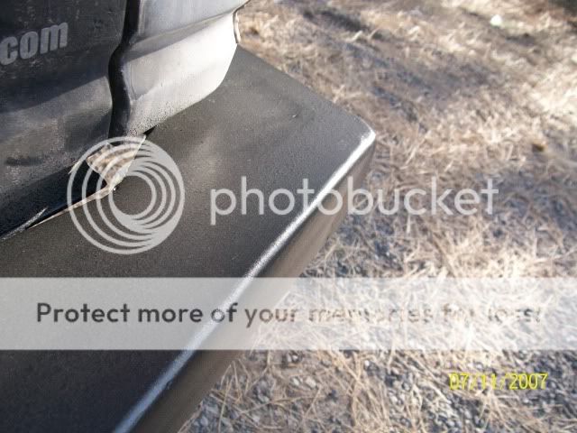

ok I finished the rear, almost totally finished the front as well.. it needs some grinding and flap disc'ing it. don't mind the date on the camera. i didn't set it.

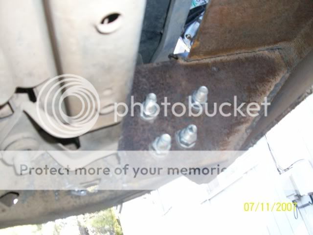

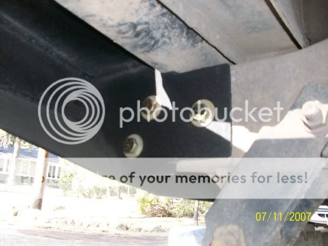

Bracket inside frame
The Titanic ; 1991 Explorer 4 door
Bracket outside frame

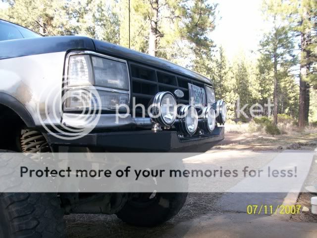

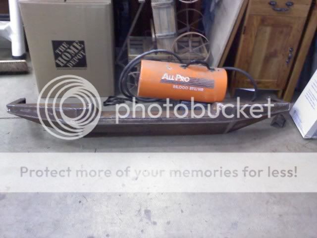

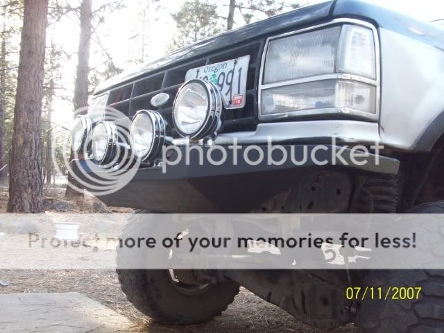

Front bumper

Inside Corners

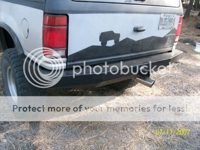

Rear Bumper

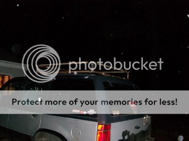

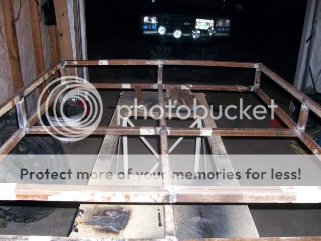

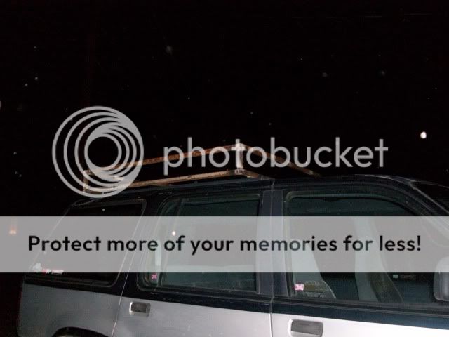

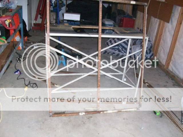

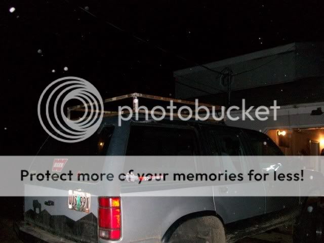

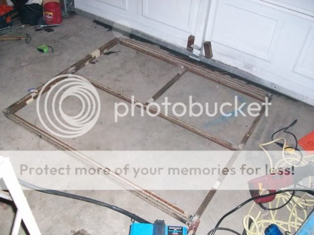

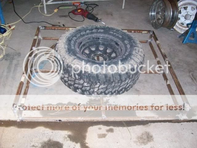

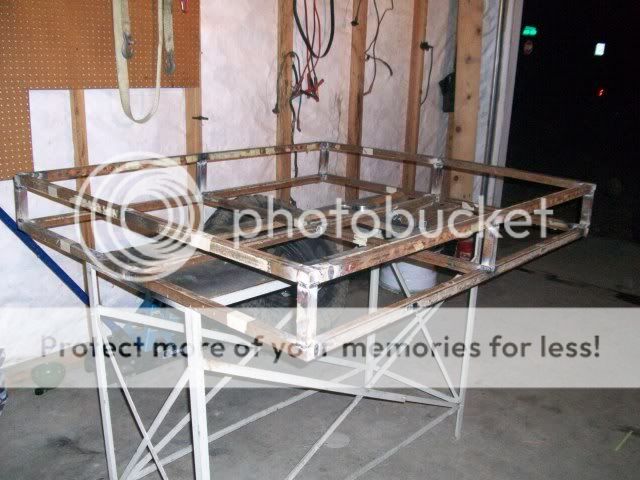

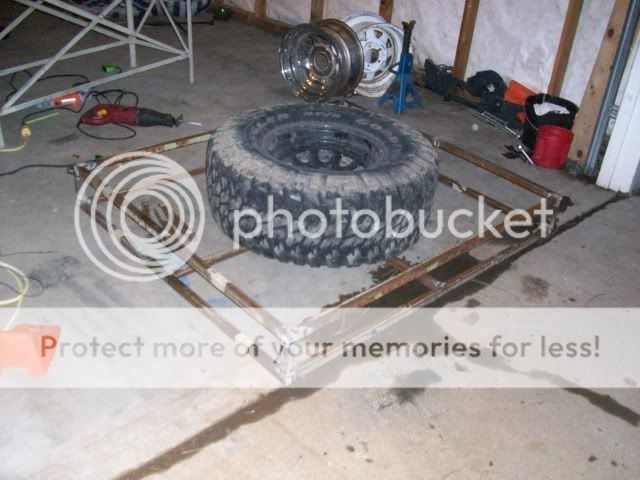

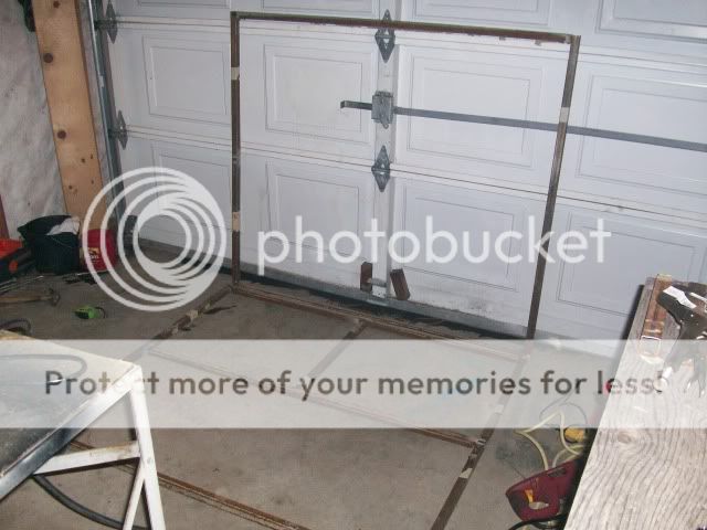

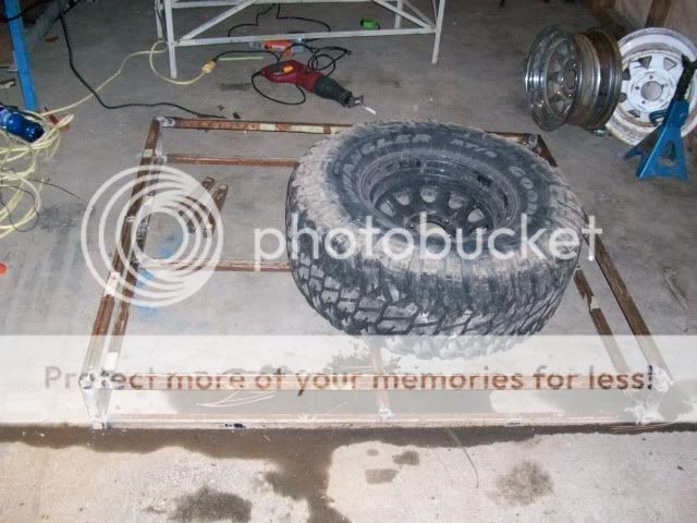

So I was bored today, unemployed, and decided I wanted to fire up my welder. I looked around and found some 3/4" square tube with a semi thick wall and decided I had enough to build a roof rack. Used my sawzall for cutting so nothing was PERFECTLY straight as far as cuts but anyways...
46" wide, 53 1/2" long. rack is 6" tall

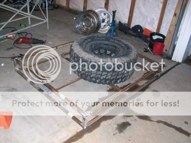

How it started...

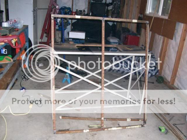

Bottom getting close...

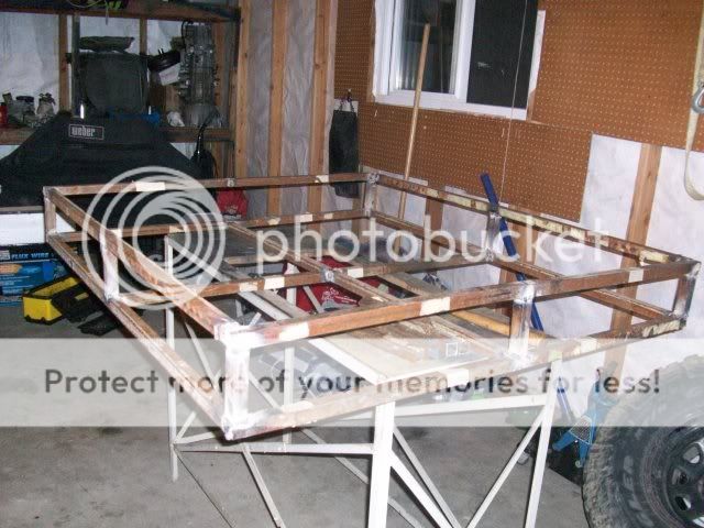

Top Started
Sitting flat on the truck (no legs or bracing)

Need Opinions...
Middle...

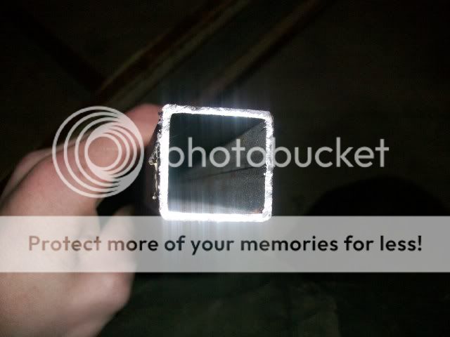

Pipe Thickness...

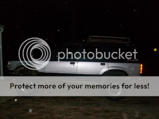

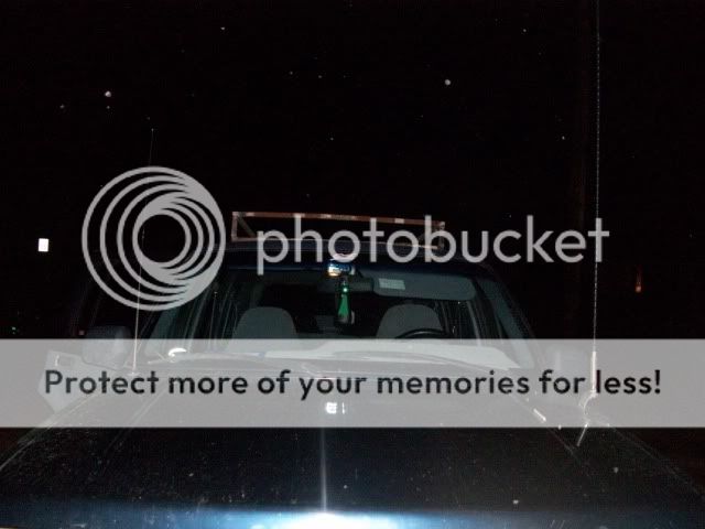

Done for the night

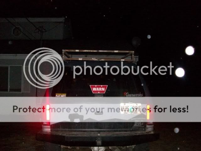

Thoughts????
i like the rear myself!
and i love seeing boredom and scrap steel comes together!!!!
