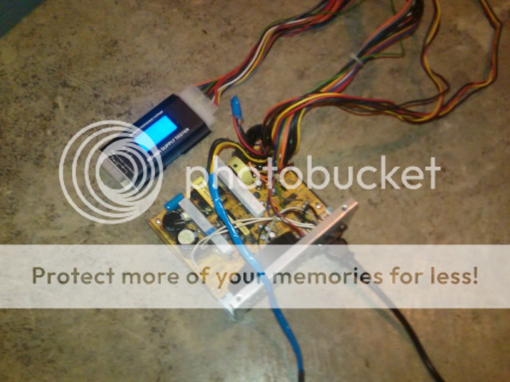

It's nice to put this old beast back to work. Of course after 10 years in a closet you want to see if it even works anymore.
I've got a fancy tool for the job.

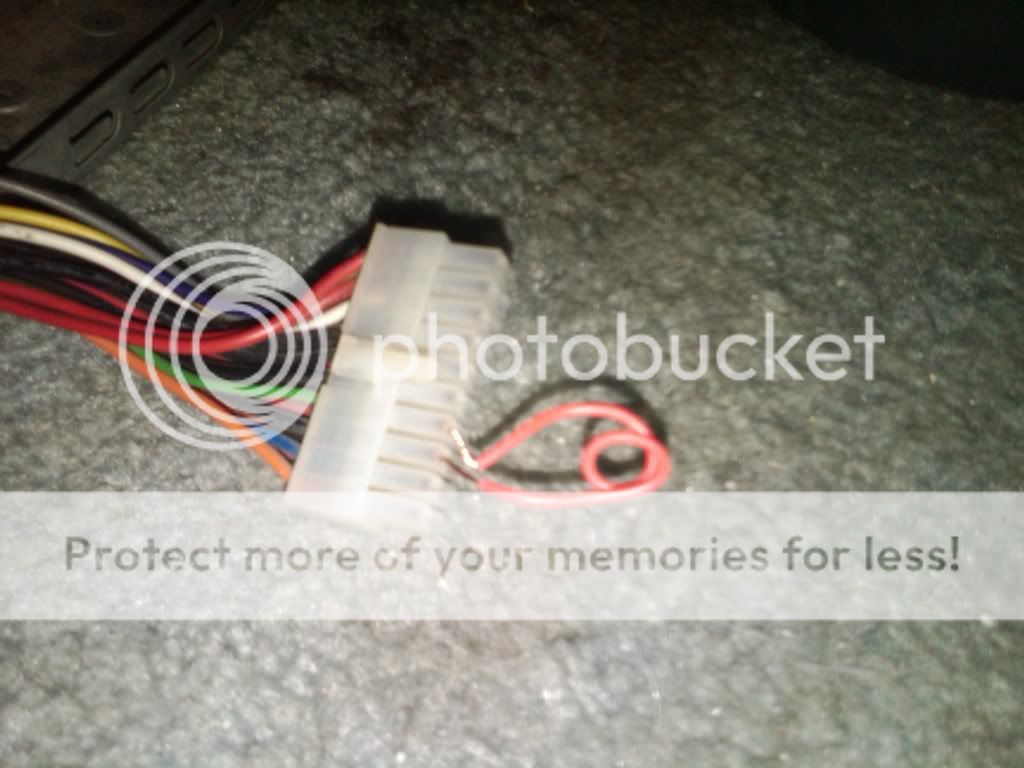

But a piece of wire or a paper clip works just as well. Simply wire the green wire on the 20 (Now-a-days 24) pin ATX connector to any of the black grounds and it'll turn the supply on. You can hook any kind of constant on switch in place of this wire to control it. So far I'm leaning towards attaching this to the tailgate handle via a push on push off switch. It'll be neat to control the lights with it.
So here's the supply with half the case unbolted and even more of it dremelled off and finally cleaned up. Gotta make sure I didn't damage it in the process. Power tools and sensitive electrical equipment really don't mix...but neither does Vodka and power tools. :icon_cheers:

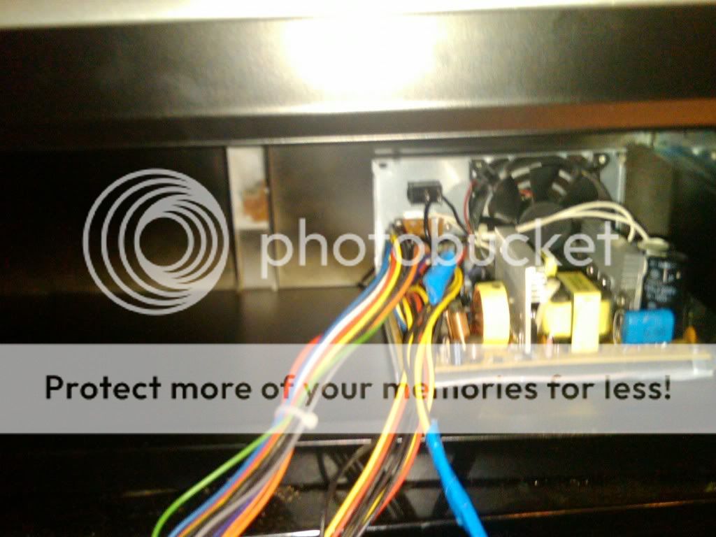

So my plan so far is to maybe mount the power supply to the back of the toolbox and notch out the bottom drawer to fit around it. I'll have to make sure a guard is in place so that none of whatever I have in the drawer touches the exposed power supply, that could be bad.

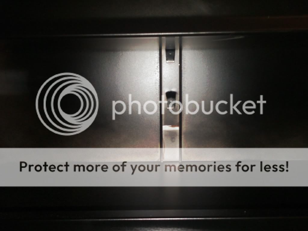

So when the drawer is closed it'll be positioned something like this.
and with the drawer out, it'll be sitting something like this.
I'll clean the wires up once I decide exactly what I need to run off it. So far the only thing on the list is 5v for some L.E.D.s to light the ford letters. But everything's subject to change. :icon_bounceblue:
