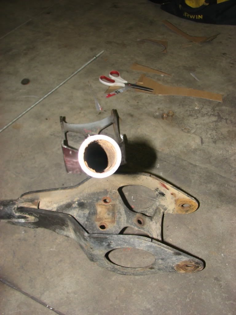

also did a little more work on the RA's tonight..
took the flap wheel to it and cleaned off the powdercoat
the slo-vo build thread...
also started making templates for my plateing, cant decide if i want to go 3/16 or 1/4...

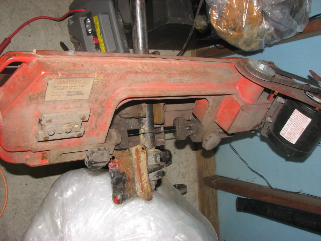

i also threw one of the arms on the bandsaw to cut the bushing end off...
was wondering why it took the saw so long to cut it...
turns out its 1 5/8's tubing with a 3/16's wall which leaves me with an 1 1/4 ID (not sure what ill do since my tube adapters are 1.5...)

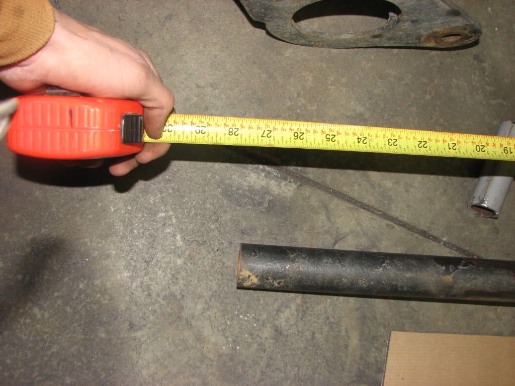

and here is my next question...how long should i extend the arms? this measure ment is from the center of the bolt hole to the front axle
any suggestions?
aybody have any imput on the arm length?....i think im going to tie them into the trans crossmember or even behind the crossmember
could build a new tranny crossmember and make the long arms attach to tranny crossmember. its quite common on sas's and the 3 link setup on like lots of jeep guys run.
yea thats what i was planning on, just didnt know what other people have ran for RA length
i've heard of guys running them around 4 feet long and some even longer, I second running them to either right in front of the trans crossmember or right on with the trans crossmember would be pretty good. be sure to design it so you don't have to tear apart your front suspension so you can take out the trans if you have to work on it for some reason.
yea i believe im gunna take them all the way the the trans crossmember if not an inch or 2 further...but i probably will have to do some work on the suspension to get the trans out because i was thinking about building a big skid plate into my croessmember for the t-case and such

i would just go to the tranny x-member, cause that is basically where the front driveshaft is...if ya go back much further you may put in some hinky drive angles....just a thought...
