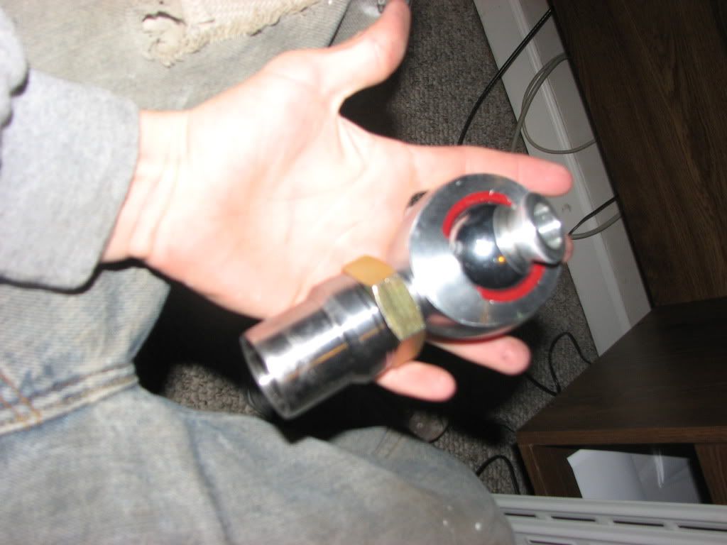

got some parts in from ruffstuff.....
the new heims...these ****ers are HUGE...wont be breaking them with my skinny pedal!

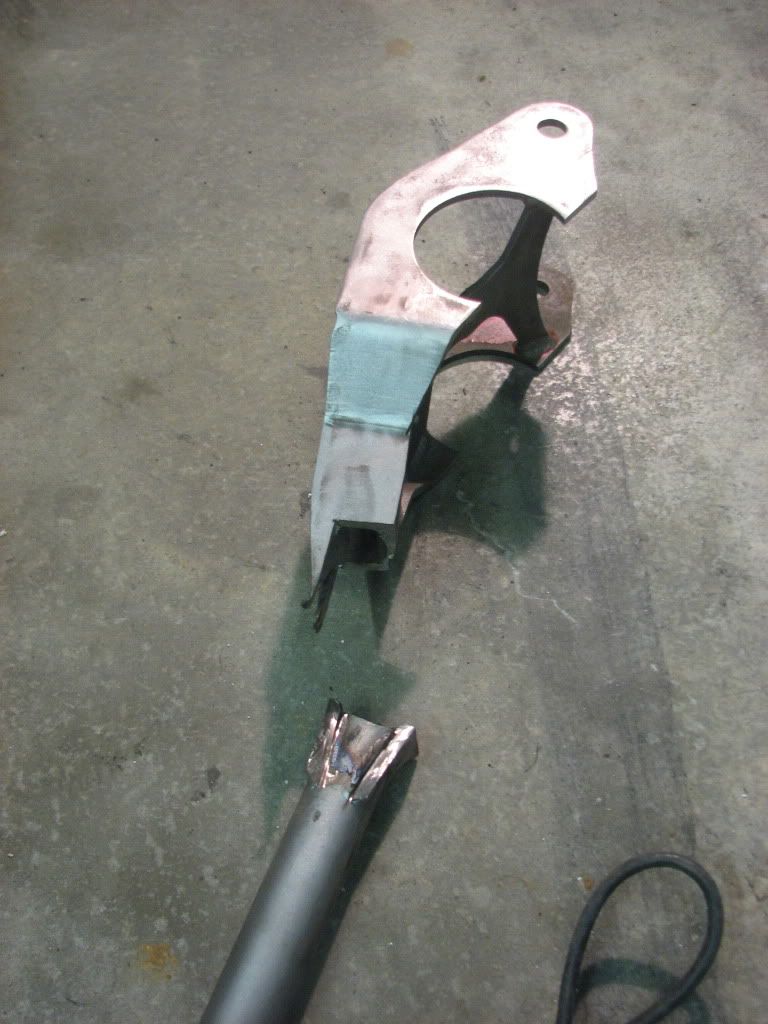

got some more work done on the arms...was going to lengthen them by slugging the original tube and extending it but by the time i did all that it would have been easier to replace the whole tube....so i started cutting

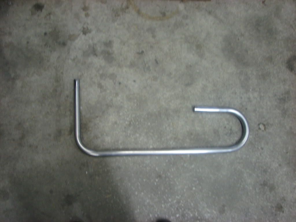

i dint have any 2in od pipe so i used a piece of header tube just to get an idea of what was going to need to be done

this is roughly what im going to end up with, im putting the tube in at more of an agle to give me more tire clearance...im going to have to add alot of material to make it all pretty strong but it should work well

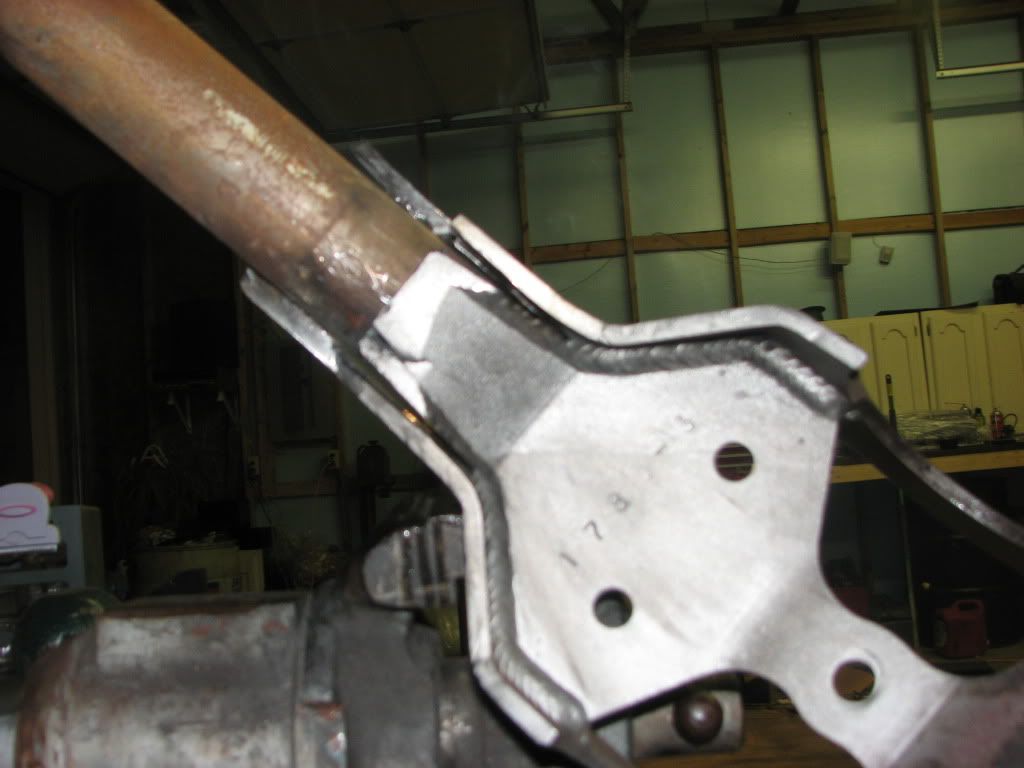

this is going to be pretty close to my total length, possibly an inch or two longer but pretty close....pretty long compared to the stock rancho arm

if i knew how much work to these arms i was going to do i wouldnt even had started with them and just used them for a guide but oh well too late now :D
let me know what you guys think or any ideas!
nobody have any comments or idea's? more then one set of eye's looking at something is always better
I think it looks good. If you are going to turn them in so much to clear the tire, you should add more angle upwards so you can snug them right up tight to the frame or even inside the frame rails.

thats a good idea i may have to try that...i guess i need to get the tube and get everything in place to get my final position right

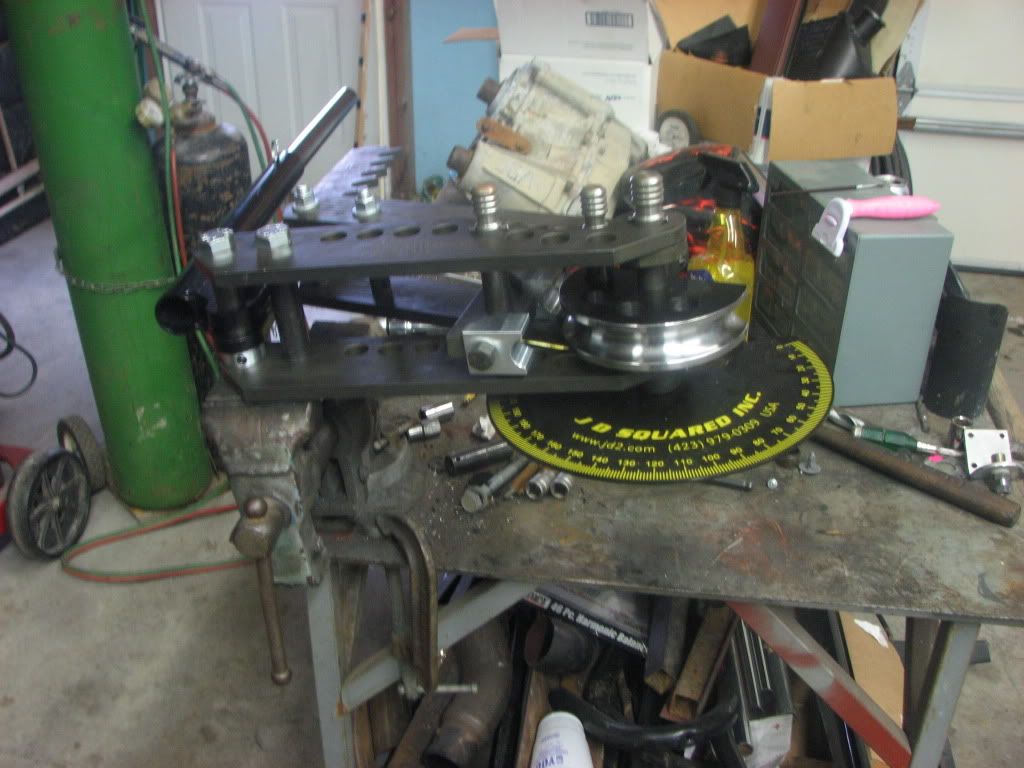

this bender is GREAT...tested it out on some 1in tubing i had laying around...its pretty thin wall and not one wrinkle or anything

its just mounted in my vise for now until i get my 2.5 square tubing to make my floor mount

uh oh, you moved your pics or you exceeded your allowance of bandwidth.... i really wanted to see that tube bender too.... oh well ill check back in a few days. by the way, its looking good and you should get some good flex out of those long arms!
