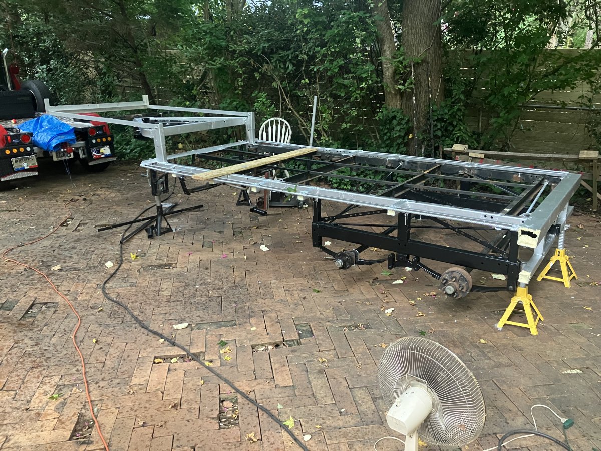

So I went back into the shed of miracles and dug a little deeper, and I actually figured out a much better way to do the upper deck on the trailer. I want it where it hinges up for access when I’m coupling it up, so all aluminum is preferable. I figured out a way to combine some steel I have and the aluminum to keep it light weight, but still strong enough to walk around on top of it or put something up there.
In the process, I also figured out how to relocate my trailer legs, so they look right, or better at least.
An evening of rest tonight….

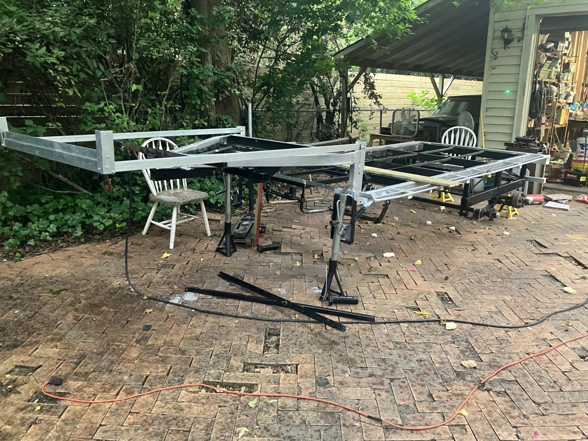

I got out late this evening, but I was focused and got the legs moved from the side to the front of the lower deck. I still have to make the lower legs out of some fence posts in the rafters. I like it much better.
Then I welded pivot pieces atop the riser posts for the upper deck. I want to be able to prop it up about 18-20” for access to the hitch. The sides are pretty thick 1/1/2 x 1-1/2” aluminum tube from my scavenge stock. At the pivot (1/2” bolts) I cut and pressed about 10” of oak down the inside for extra strength at the pivot.
The front side is a double layer of 2-1/2 x 1/8” aluminum angle. One piece under turned up, two 7” vertices on the corners, then another piece on top turned up, creating a tall front lip. It’s so nothing slides off into the cab. I think I’m going to run one of my 3/4” threaded rods across on top too.
With that aluminum frame in place, the first time I actually saw what it would look like. I’m liking it.
Ran out of light and did a little clean up.
Next step is I’m going to run a steel 1” x 3/4” tube I have across right at the tip of the trailer tongue for support. I’m thinking that tube will be part of the upper, and it will rest in an angle about 18” long welded to the tongue, a snug fit. I’ll make some kind of pins or bolts to hold the two firmly together so it doesn’t rise up in the wind, and to make it solid laterally so it doesn’t sink or warp if you stand on the side. A little trial and error on this cuz I’m almost out of steel and aluminum.
Then I’ll do a double check, but I’m pretty sure I move to the aluminum fender fab, then lights, then decking.

I pretty much have the upper deck frame put together. I leveled it compared to the rest of the trailer running strings from tip to tip, and I did the support that sits on the top of the tongue and got it welded down. Then I figured out the hold down pins and that’s done.
The aluminum frame is plenty strong enough to carry my full weight (more than average), and I was pretty happy about that. Then I realized there is nothing inside the frame to support the diamond plate in the middle when I put it up there. I used one and a half in.² tubing, so I’m thinking of getting some pressure treated 2-bys and making a little sub frame inside the frame just a hold the diamond plate from sagging. I don’t want to add a lot of weight because I have to be able to pick it up.
Next step is trim and lights and diamond plate. This thing still might get done in time.
