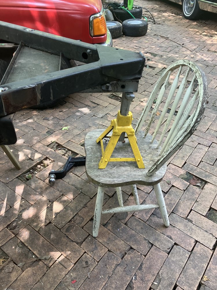

And yes, I’ll weld the jack stand to the kitchen chair if that’s the final design.
On the jack stands, they are cast-iron from my late uncle, from my grandfather, from the early 1920s. Cast iron mast, cast iron housing, cast iron angle legs, riveted braces. & some more recent Rustoleum.

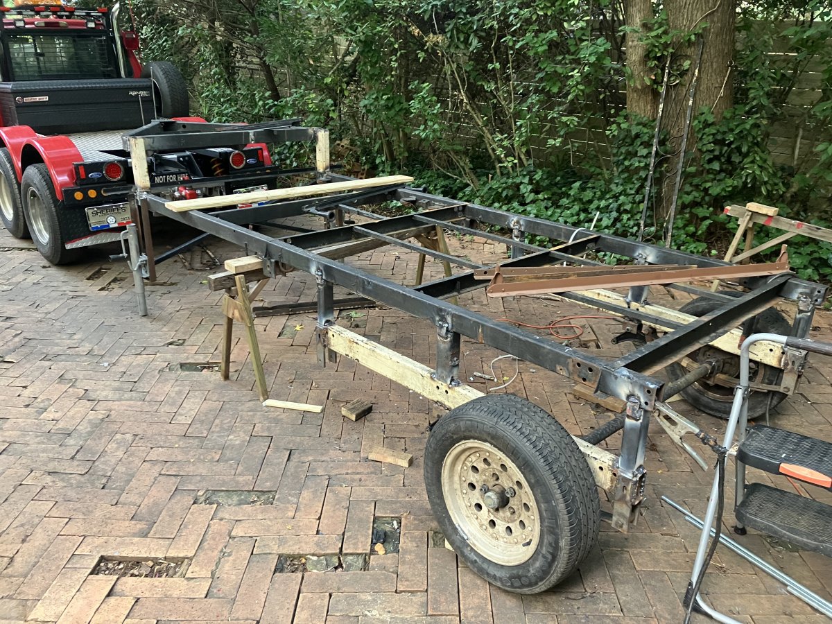

Working my tail off on this goofy trailer. I haven’t welded, cut, drilled etc., this much in 20 years. But it’s coming together.
I got the tongue welded out and assembled, still have to do the upper deck.
I also got some legs installed, two swivel trailer jacks I had that had wheels, cut the wheels off, and that let me finish the tongue assembly. I’m debating between making sleeves for the wheels that were on there, so I can push the trailer around when it’s not on the truck, and also making some flat pads that I can use when I’m just parking the trailer. Decision for another day.

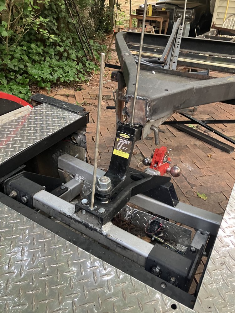

I drilled and tapped a 5/16 hole on top of the tongue, and then on the coupler for alignment rods. I put a wingnut on the end of each rod, upside down. (imagine that from me) so I could thread it in the hole and run the wing nut down to hold it tight and straight, and then I can remove them once I’m hooked up. With the rods I can back it up on the coupler from the rearview mirror. I have to admit I astounded myself when I got it dead nuts the first time! I have to find some orange balls or such to put on the top of the rods so they’re more visible
That let me set the ball in the nightmare hitch (it’s not going anywhere, but I did think of an improvement from all the creative criticism). That let me mock up the level on the trailer (it was still on sawhorses this morning). I pulled a string from the front turn signal, all the way to the back of the trailer along the lower body line on the door. I was once again astounded that the body line, the tops of the rear tires, and the full length of the trailer were probably within 3/4 or 1 inch of where I wanted them. The truck body line slopes up from front to back, and the trailer will slope down a little bit from front to back, with a little rise at the coupler. That way with the slightest load, the whole thing should ride level and straight. (theoretically. None of my welding is level and straight).
That let me figure out how tall the spacers needed to be between the axle frame and the trailer frame. They came from the new piece of 2 x 2 I had to buy at retail, (almost ruined the whole project for me). I got them in and got them welded. I still have to do the front-to-back cross braces and the side-to-side cross braces. The trailer sat on the tires and on the ball for the first time.
I got the front cross piece for the decking installed, and I think I figured out what I’m going to do with the rear bumper, a big piece of square tube. Next step will be putting that bumper on, then pulling strings from the tip of the front deck rail to the tips of the bumper (which I have to cut down). Then I can do all the supports for the decking down the outside sides of the trailer frame, and I need to put a few cross supports inside the trailer frame.
U-bolts and the second set of springs are supposed to be here tomorrow, and that’ll be mixed in with fabricating the rear bumper and finishing up the springs and cross bracing. Btw, most of the bracing is made out of Craigslist free bed frames that I’ve accumulated for the last few of years.
I’ve been putting in a lot of thinking on how I can run a sturdy member down the length of the sides to use for tie down straps, but still have a channel or angle at the edge of the decking for running lights. Dilemma for another day…

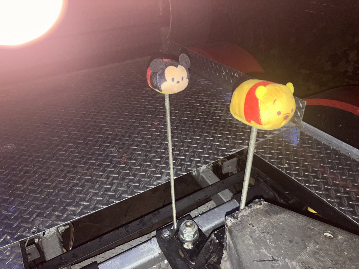

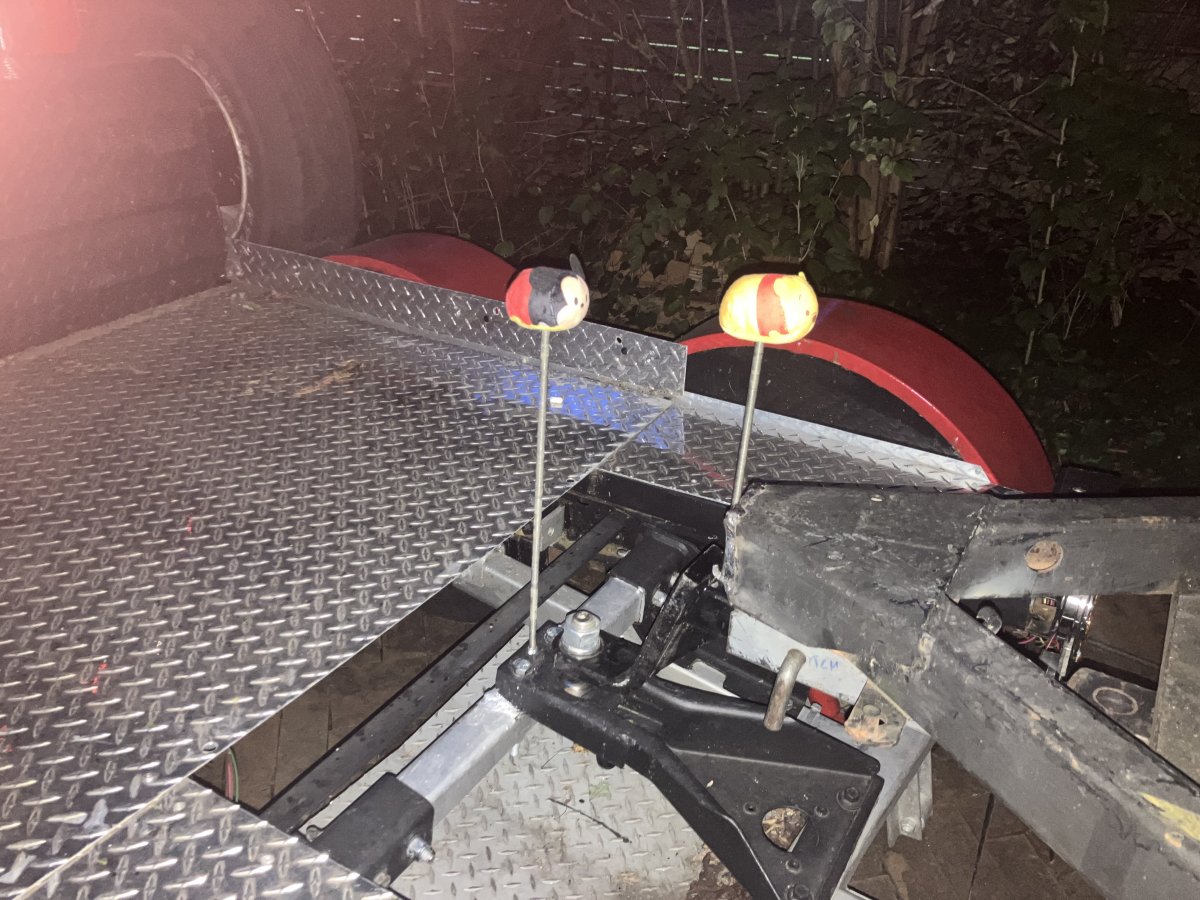

And an update on the alignment rods for when I’m coupling up. I went to the dollar store (can you believe it’s actually $1.25 now?) Looking for a couple little Styrofoam Day-Glo balls to put on the end of my little threaded rods. Nothing.
Then I found Mickey Mouse and the pig(?):
I was raised with Walt and Joe, very good people, good stuff, but lately I have not spent any of my money on any Disney product. This little Mickey and pig(?) were in the dollar store, I’m out of time, and they were only $1.25 each, and they were bright and noticeable and the right size.
Then I was inspired for the installation which made it worth the $2.50:
Now, when I put the rods in, and I’m backing up, I know when Mickey kisses the pig’s ass everything is working correctly.
