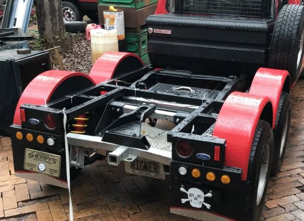

Understood and considered. The load will be primarily downward, minimal other loading since it’s a ball in a cup, and the trailer axles will be in the rear, not half way. Enhances the downforce.
If you think about it, the forward backward loading is maximized during a hard brake, forward (assuming the electric brakes are set correctly). That will be against the front of the cup.
Pulling will be against the tightener, it’s bolt & cross pin. Have you ever seen them fail? My set up may cause more wear on them, but you can see it every time you look down.
I haven’t gotten this far, but there will also be chains from the frame to the tag axle, and cross chains on the trailer. This tag axle set up is technically a trailer, chains required, and all together technically a train. I’m not to worried about getting a ticket either way.
And finally, I’m probably only going to pull the empty trailer for fun and shows, no real work, and if so, rarely.
Having said all that, this all came to me in a dream, and my welding skills have deteriorated (I compensated with huge welds), so there are 6-7 spots I’m going to monitor very closely for wear or fatigue.
Again,
Thanks! All comments and concerns welcome!
