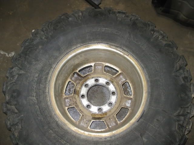

I can tell you this much, boring out the hole to make the H2's fit over the D60 spindles sucks. There's got to be a better way to do this other than a die grinder and a burr ( and no, I don't want to drop the money on a one time use hole saw).

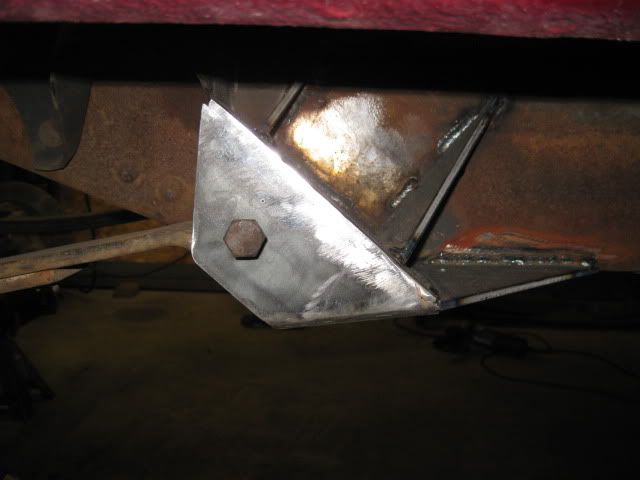

After constructing the rear leaf mounts (Linky) it was time to get them located correctly and add some gusseting.
From the above mentioned thread, I’ve already welded up the hangers by using some ¼” plate to tie things together and set my stand off distance (1.5” from the frame, same as the stock hangers):
For the gussets, I added two on top, and one in the front:
And one more tying in the rear

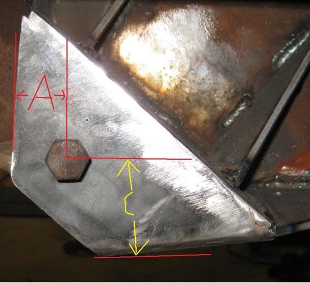

To locate these mounts, I butted them against the rear cab mounts. Going off of that as a reference point, the center of the hole is located 1.25” from the cab mount (“A”) and 2.125” from the bottom of the frame (“C”):
This puts my axle centerline at 115” wheel base using the stock chevy 63” leaf springs.

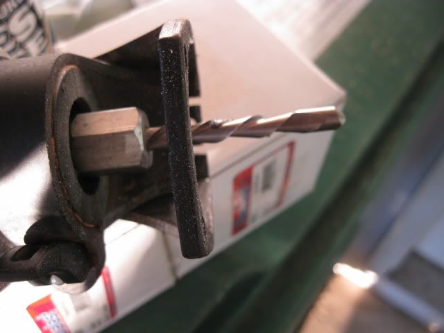

Thanks on the router tip, unfortunately, I don't own one or know anyone that has one. So I borrowed the next best thing I could find, a "roto-zip" which is essentially just a larger version of a dremel.
I found when using this bit (2 flute endmill) I had a decent rate of material removal. But the cast alu that these wheels are made up of are extremely "gummy" so lots of WD-40 was used to help keep the bit from clogging up.

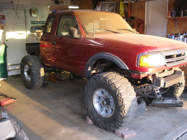

2 down, three more to go, unfortunately, I had to give the tool back tonight, so I'll have to do the fronts and the spare at a later time. I did put it back on its own weight for a bit tonight before I pulled the rear springs out to replace the trashed bushings:

im wanking it to that picture of it on all 4's
Dude.....that is entirely too much information.........:icon_rofl::icon_rofl::icon_rofl:
does look really good though......
l8r, John
look's awsome on it weight!!! so from the sy shot it look's like it musta been loud and metal must have been flyin SWEEEEEETTTTT!!!!!!!
one thing i find funny, is when you were looking for a base point to set the front up i almost always use the oem hanger bolts, usually using two long allthread rods to make a fixture. i was sure you would do that, and now the rear hanger setup ending up like it did adds to that.
i am quite impressed with your approach/solutions :icon_thumby:
