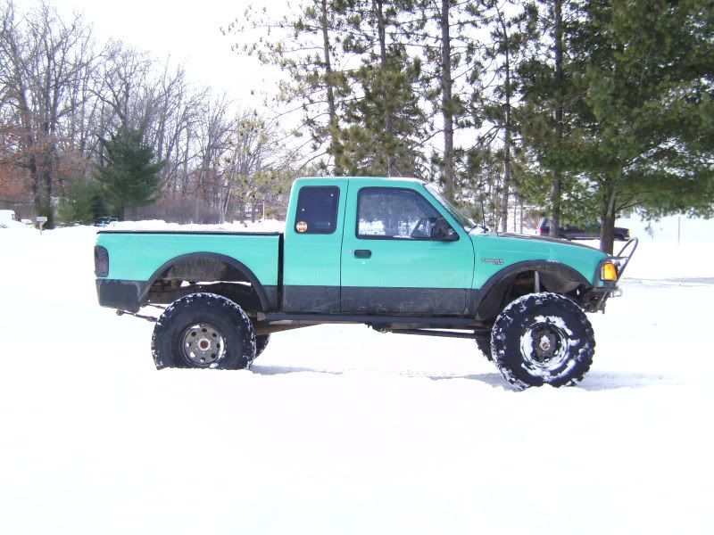

is this thing going to any street time? or used as a truck time? because if not i would bob the rear it helps your departure angle alot.
i edited a pic of my old 97 to show. this is with the wheelbase moved up to where yours is and the bob at the tailgate

Dunno, don't think he'll be able to do that as he's using leaves.
should be able to maybe not that big of a bob but close. i think itd still be about 3.5-4 ft of bed more then enough for camping equiptment and a 24:icon_twisted:
plus theres the the extended cab portion to store things in. actually the more i look at that pic the more i want to do it to my next truck
I don't disagree, but with leaf's I can't really bob it that much unless I don't want to run a bumper. And I run into stuff enough that bumper is needed :icon_twisted:
Also, this truck still needs to be used as a truck so it needs to be able to hold stuff my wife needs moved. (I don't have anywhere to store a small trailer to haul stuff).
If it becomes too much of a hinderance, I'll bob it further an link the rear, but I'm just not seeing the need for it with the wheeling I do out here. But that's subject to change at a given moment :icon_rofl:

From what I can tell, you're correcet. using the setup as a refrence, it only looked like I could cut 3-4" out of the rear. seemed like quite a bit of effort for that much of a gain. Maybe If I lived out west, there would be a bit more justification for it.
I'm resisting the temptation (kinda dig the look too :icon_twisted:)

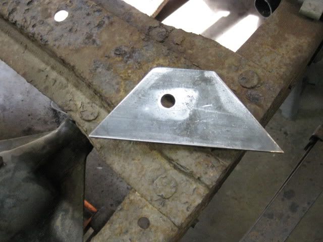

After farting around trying to figure out how to make everything live in harmony (body mounts and leaf mounts) it turns out I had a bit of luck. Just this past week, we got our Torchmate running at work. Since I got to help set it up I made up a few “test pieces” that were identical to the front leaf mounts I used. At the time I wasn’t sure that I could use them or not, but I figured why not.

It turns out that they work awesome when I flipped the orientation and butted it up against the body mount:
The Lone Ranger – Kage’s ’94 X-Cab Leaf SAS and Bed Bob

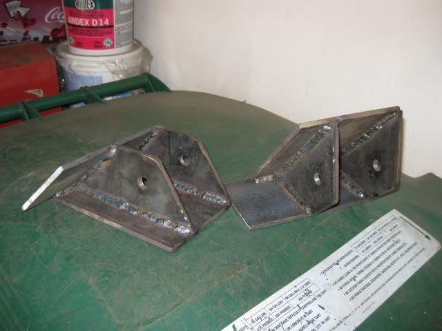

So I burned some mounts together and burned them home (I’ll post the measurements later).
Here they are on the only clean horizontal surface I have in the garage right now.

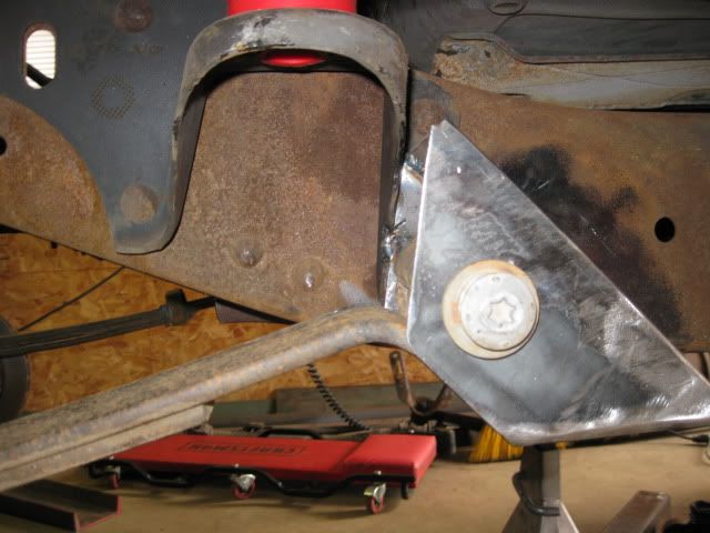

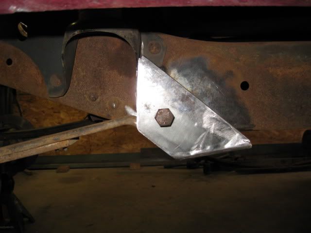

Tacked on the truck:

Then I went ahead and burned them on (Still need to add the gussets):

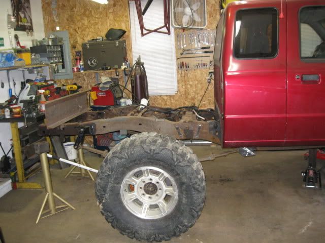

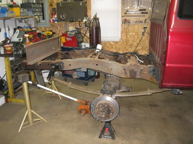

After the front was done, I slapped the springs in place and took a guess at where the rear hangers needed to be. For these photos I’m using the holes left over from the spare tire carrier.
This is at 115” (ish) wheel base. I’m not going to burn the rear hanger on until I get some weight on the back. I’ve got a feeling that I’ll wind up dropping the mounts down a smidge. But as it sits, it looks perfect:
On its own weight:

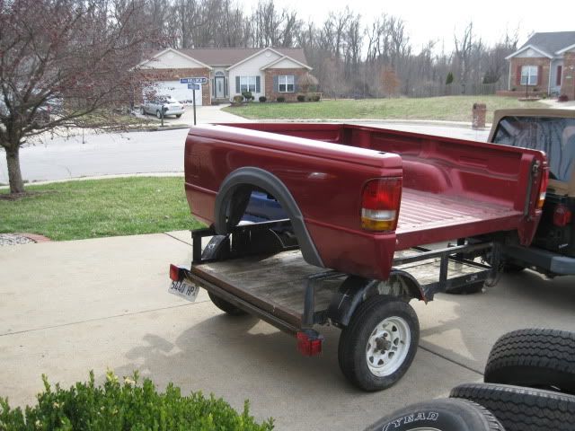

As a side note, the bed took off today to head over to a friends house. He decided to save me from my own body work and volunteered to do the body work on the bed bob:
