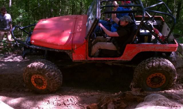

I didn't have my camera, but my friend grabbed a few with his phone. Minimal damage for me this trip out (Broken door handle, and roached motor mounts). The CJ that was with us managed to sheaer the bolts off his high steer arm on the back side of the park, so we made a long afternoon of dragging him back out. Turned out to not be that big of an ordeal, but it took some time:

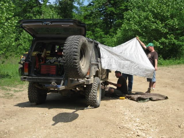

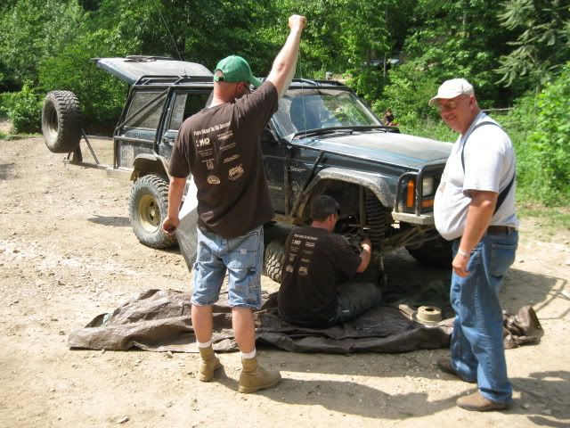

Pit Crew working on a downed XJ:
Videos (click on the picture):
We wound up quitting for the day mid afternoon due to the XJ blowing apart his pinion on Larry’s hill. Other than that, it was a pretty good trip with the truck performing decently (tires and gears are on my list of wants). I’ve got some cooling issues that I need to sort out (Truck seems to be running way hotter than it should, even on the highway).​
